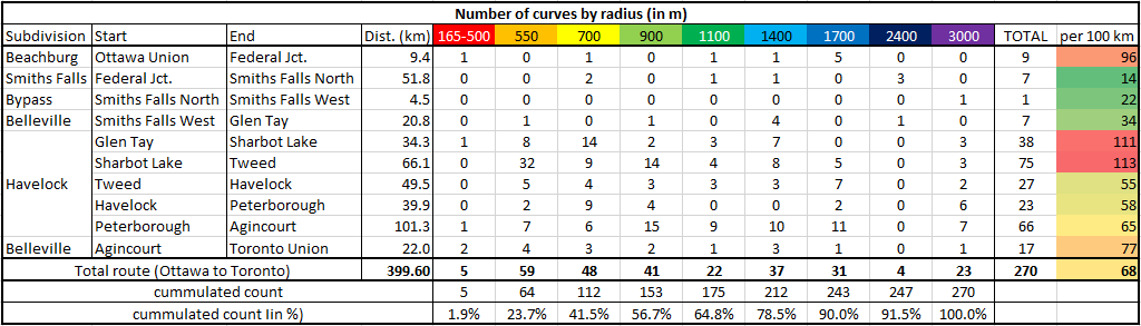

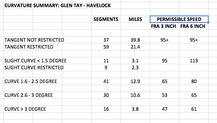

First, here's the summary of what I found in the document :
screen-shot-2020-09-08-at-9-22-48-am-png.268257
Translation: There are 86 segments where the as-exists curvature exceeds 1.5 degrees. At that curvature, a "typical" train would have to reduce speed to negotiate the curve. My assumed "typical" train is the equivalent of an LRC with tilting deactivated - ie, assumed track superelevation (banking) of 3 inches, and equipment with a "cant deficiency" rating of 3 inches. (I pulled the LRC specs from memory, and may not be accurate, but it's just a straw man anyways) The speeds shown under the "FRA 3 inch" collumn are the speed allowed by the US Federal Railroad Administration for that track profile. (Note that the length of the curve does not affect the restriction - although a longer curve will require holding that train to the restricted speed for a greater distance).
So, under this baseline, in the 94 miles from Havelock to Glen Tay, a "typical" train would have to navigate 3.8 miles at 47 mph, 10.6 miles at 53 mph, and 12.9 miles at 65 mph.
Of the remaining track, trains could run 42.9 miles at 95 mph+. Because of all the slow segments, there are about 23.7 miles of track that is straight, but is adjacent to the slow bits, so trains would have to be accelerating/decelerating through these segments. These segments while straight consequently must be considered "restricted" by all the slowing down and speeding up.
The question is, what can VIA do to improve on this? One solution would be to increase the banking of the curves and/or use a tilting train that can handle curves faster. The collumn "FRA 6 inch" shows the speed restrictions that would translate to "LRC train with banking operating as designed" - ie 3 inch superelevation, 6 inch cant deficiency. As you can see, if VIA either found a tilting train, and/or banked the curves more, speeds through all those tight curves would rise.

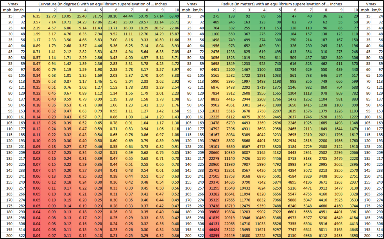

For the benefit of those people who struggle to understand the interplay between degree of curvature, radius, balanced superelevation and unbalanced superelevation (the latter being what Paul calls "cant deficiency"), I'm copying the relevant section from my Masters Thesis:
5.7.2. Local speed limits
The main factor affecting local speed limits is the curvature of specific line segments and the applicable superelevation. In order to offset the centrifugal forces, which may cause anything between passenger discomfort and train derailment if the train takes the curve at an excessive speed, the outer rail is usually elevated so that the train tilts slightly towards the inner of the curve, thus creating some gravitational forces which act in the opposite direction of the centrifugal forces. In addition, railroads often apply a so-called “unbalanced superelevation”, which is the increment by which the equilibrium superelevation (i.e. the superelevation which would be needed to completely offset – or: balance – the gravitational forces) exceeds the actual superelevation applied to the curve.
Railroads in North America generally apply the formula shown in Figure 19 to determine the equilibrium superelevation. Given that the formula does not treat actual and unbalanced superelevation differently, it is sufficient to determine one single value for the maximum permissible superelevation. While FRA regulations allow up to 3 inches of unbalanced superelevation and a maximum actual superelevation of 7 inches on Track Classes 3 through 5 [21], the limit of 5 inches of total superelevation used by Caltrain in California for their own urban mixed-operation rail corridors (Caltrain, 2011) seems to be a reasonable assumption to be adopted within this thesis.
Starting from the first equation provided in Figure 19, we can isolate the maximum permissible degree of curvature, which then becomes an input for a different equation (Calvert, 2004), which can be used to calculate the minimum permissible radius for the 5mph-increments shown in Table 17 [23]:
[21] It should be noted that the track classes defined by the FRA are slightly different than those defined by Transport Canada and that, for instance, the maximum speed of Track Class 5 is 90 mph (145 km/h) rather than 95-100 mph (153-161 km/h) north of the border.
[23] It should be noted that the degree of curvature (𝐷𝑐) needs to be converted to radians before being inserted into Equation 2.1.
I've created a more detailed version of "Table 17" to show the degree of curvature and radius for an equilibrium superelevation between 1 and 10 inches and speeds between 15 and 200 mph and if you refer back to the first table from Paul's post I quoted above, it becomes clear that the "FRA 3 INCH" and "FRA 6 INCH" columns presented by him assumes 2 inches of cant deficiency (unbalanced superelevation) for a total superelevation of 5 and 8 inches, respectively:
I've created a more detailed version of "Table 17" to show the degree of curvature and radius for an equilibrium superelevation between 1 and 10 inches and speeds between 15 and 200 mph and if you refer back to the first table from Paul's post I quoted above, it becomes clear that the "FRA 3 INCH" and "FRA 6 INCH" columns presented by him assumes 2 inches of cant deficiency (unbalanced superelevation):
Thanks for the table, it's very informative! For others' reference, here are some numbers I pulled from it:
Based on the typical 560-metre radius present on the eastern segment of the Havelock sub, here's the applicable speed limits from the right table given different equilibrium (total) superelevation:

The relationship between the various superelevation values is:
Equilibrium (Total) superelevation = Actual superelevation + Unbalanced superelevation (Cant Deficiency)
Transport Canada seems to take 3" cant deficiency as a given, so the aforementioned 3" and 6" actual superelevation options would correspond to 50 mph (80 km/h) and 60 mph (97 km/h) respectively on the eastern half of the Havelock sub.
I think that VIA could justify quite a high level of actual superelevation east of Havelock, since they could completely prohibit freight trains. Transport Canada permits up to 7" actual (10" total), though they place very strict maintenance regulations on tracks above 6" actual. I think it's safe to assume VIA would use either 6" or 7" actual (9" or 10" total).
West of Havelock the total superelevation would need to be lower since CP will retain running rights, perhaps 5" total like your CalTrain example. Thankfully that segment has larger curve radii anyway.

  1. Parameters
    1. Train
    2. Superelevation
  2. Data
    1. Route
    2. Curves
  3. Modelling
    1. Speed limits
    2. Uniform acceleration
    3. Fixed blocks vs. variable blocks
  4. Model Solving
    1. Ignoring s-curves
    2. Respecting s-curves
Okay, shall we?
1. Parameters
1.1 Train

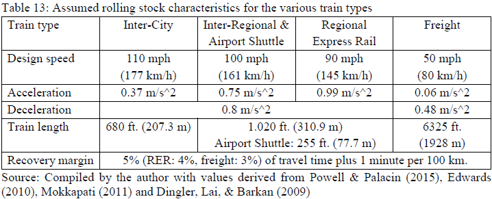

The only practical way to model train running times is to assume uniform acceleration, by which only two parameter determine a train's capabilities to accelerate and decelerate (one parameter for each) along its route, which I explained in all detail in Section 6.2.
As you could also read in Section 5.3, I selected four different train types for the Toronto-Kitchener service I was modelling:
Source: my Master Thesis (p. 60)
Needless to say, that the "Inter-City" train is the most appropriate train profile as the closest equivalent to the Siemens trains which would serve the HFR route.
1.2 Superelevation
As I explained in Subsection 5.7.2, I identified that the maximum allowable total superelevation (note that this is the sum of balanced and unbalanced superelevation) under FRA rules is 10 inches, but opted to only assume the same 5 inches which Caltrain's host railways were willing to accept for its commuter rail network. I found an interesting article (on p. 24) about Brightline in which they mention that its host railroad's tracks (i.e. those of FEC) were banked by 2 inches of actual banking (i.e. balanced superelevation), which suggests that the 3 inches of "cant deficiency" (i.e. unbalanced superelevation) Paul has mentioned are an industry standard. More interestingly, it mentions that the actual banking along the shared segments was increased to 5 inches, which presumably translates to a total superelevation of 8 inches. Given that a passenger railroad was able to obtain 5 inches of banking from its host railroad, it appears reasonable to assume that a passenger railroad sharing its own tracks with infrequent freight trains could at least impose the same banking onto its curves. Therefore, I will assume a total superelevation of 8 inches for modelling the HFR route.
Unfortunately, "s-curves" (e.g. a right-curve directly leading into a left-curve) pose a problem here: the more banking is applied to the curves, the earlier the banking has to start so that the target value has been achieved before the train enters into the curve (and the same has to be reversed at the end to the curve until the tracks are horizontally levelled). I will therefore limit the total superelevation to 5 inches for any adjacent curves which bend in opposite directions.
The last point actually brings me to a remark towards the many friends of tilting trains here: the only thing what a titling train does is increasing the cant deficiency by adding an additional superelevation to the banking which was already applied to the route (thus offsetting part of the underbalance which results from the centrifugal forces at the speed at which the train travels around the corner. However, in the context of s-curves a tilting train which tilts with an additional 2 inches (to throw a number around) over a curve with a banking of 5 inches has the same total superelevation (i.e. banking of tracks plus permittable cant deficiency plus the banking of the train, thus: 5+2+3=10 inches) as a conventional train train operating over a curve with a banking of 7 inches and thus requires the same distance to become horizontally levelled without passengers becoming uncomfortable. Therefore, even if an FRA-compliant non-electric tilting train design was available for the North American market (I'm not aware of any), it would not allow to run faster around s-curves than the non-tilting train which is currently in production for VIA...
