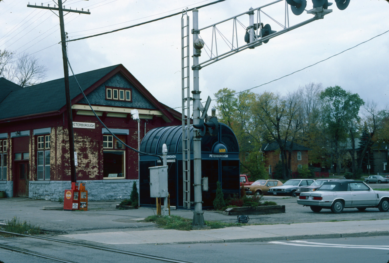

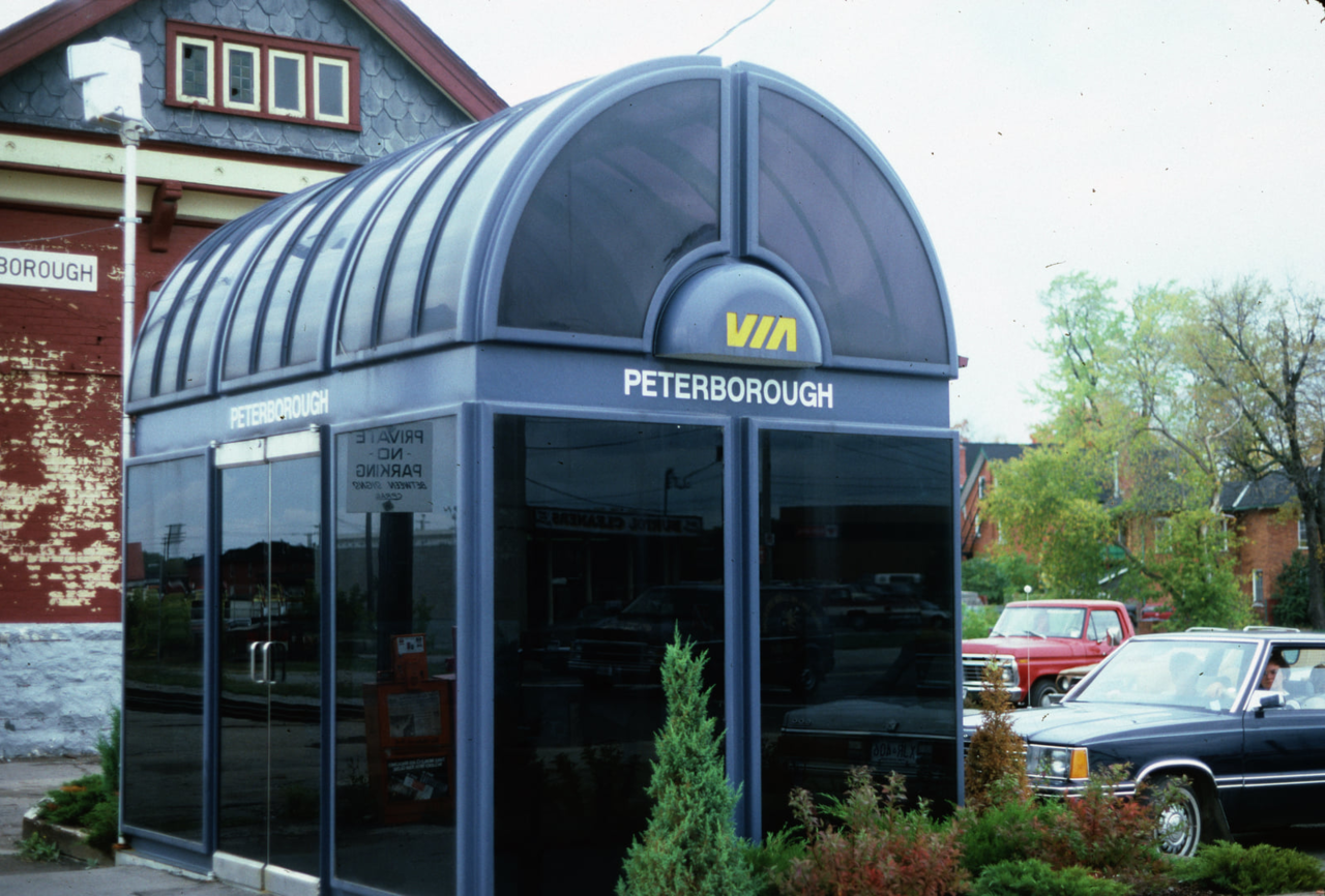

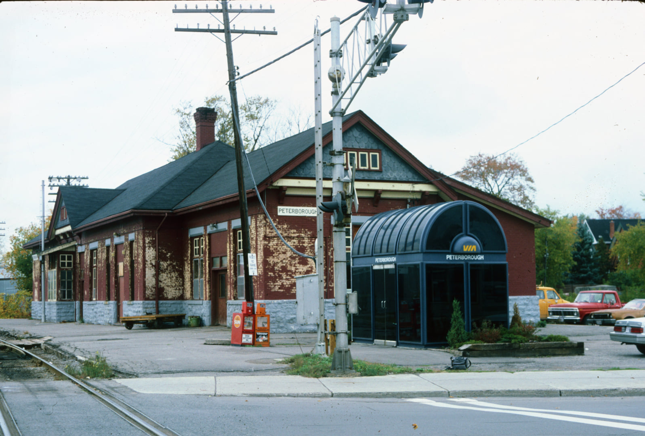

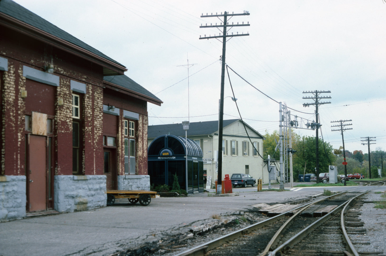

Just a bit of a throw back to the last time Peterborough had VIA Rail service until it was cut by Mulroney in 1990. I hadn't seen pictures of the VIA shelter beside the historic station before. The photos are by John Cowan and he has a great Facebook page for his photos here. Link to pictures here.
If those photos don't sum up the state of North American intercity rail in the 80's and 90's, then I don't know what does.

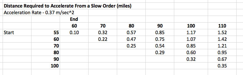

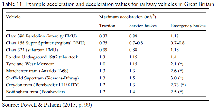

I'm surprised the RER is 3 times that of Inter-City. I'd have guessed that VIA's new trainsets had more acceleration than the current 12-car GO trainsets.
How do the current, future, and current 10- and 12-car trains compare?
All the specs you see in that table are the result of arbitrarily selecting a train type in the literature (see table below) which I found most relevant for the Toronto-Kitchener route, but they won't necessarily have any resemblance to the capabilities of the trainsets which will actually be selected for GO RER and any other services on that corridor. That said, any service which has frequent stops (e.g. GO RER) will have a focus on acceleration, while those covering longer distances with fewer stops (e.g. VIA's HFR trains) will have a focus on maximum speed instead...
Quoted in: my Master Thesis (p.58)

1990 was a bad year for Transit in ontario.
Not just for transit in Ontario, but for intercity rail all across the country...

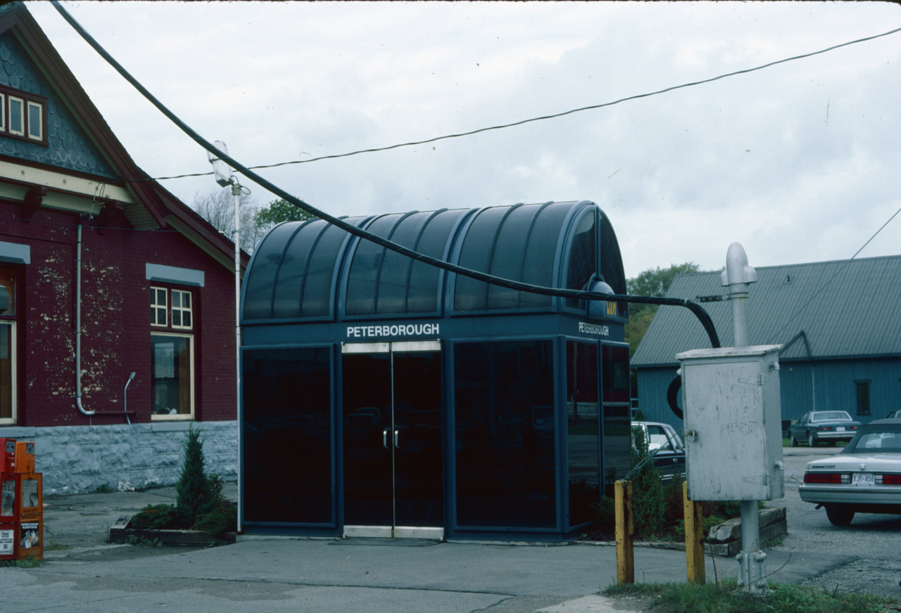

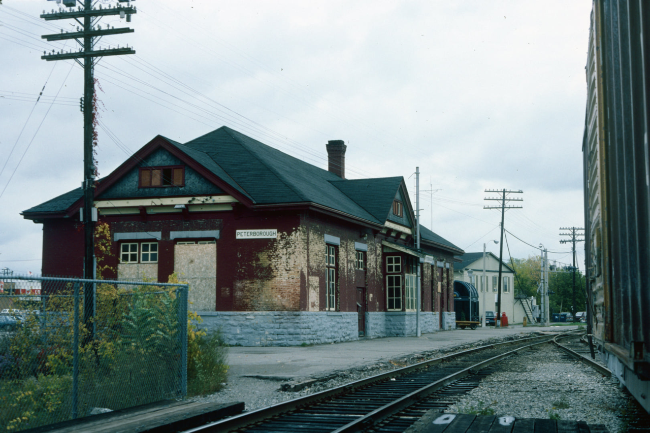

The state of a still in-service station (at the time), in a comparatively major town was indicative of the value place on rail service, certainly the politicians and arguably the broader public.
That's the sort of thing that drives ridership lower over time, making cut politically easier.
Death by (wilful) negligence.
This is a problem not unique to inter-city rail; always be weary of under-invested in infrastructure and public services, as the can lead to cuts and/or privatization, as the service deteriorates and becomes less popular.
It can apply to roads, rail, buses, long-term care, public healthcare, education/schools or parks.
Remember to call out that the ridership/usage is not down 50% because people don't like parks, schools or transit; its down because the service/location is neglected and offers poor service.

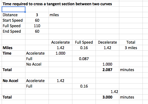

Before I will post Part 2 of our Havelock travel time modelling exercise, I would like to address the following feedback from Paul:
The starting point is the assumption that VIA's Siemens equipment will be the benchmark equipment for this run.
My first key assumption is that its performance envelope will prove to be similar to the "InterCity" equipment cited in @Urban Sky's thesis. The important point is the acceleration/deceleration parameter - 0.37m/sec^2. I am using that statistic for all my calculations of acceleration and deceleration on the line. That number may not be reality, but it's a sensible figure to use, and it aligns to @Urban Sky's work.
Second, I am assuming that deceleration and acceleration rates should be treated as the same.... again, that may not be the case, but it's a conservative assumption for modelling.
We need to be clear as to why we make these calculations: my starting point is that @reaperexpress claimed that is physically impossible to achieve a better travel time than 3:40 (i.e. 25 minutes slower than the HFR target time promise) and that even that travel time could not be achieved under the constraints inherent to real-world operations. Therefore, I'm not trying to prove that 3:15 can be achieved with little or no alterations to the existing alignment, but to show that claims that such a travel time would be achievable are reasonably credible. This means that I'm making relatively aggressive (but not implausible) assumptions and I will hand over the spreadsheet to you two (and anyone else interested) to play with the various parameters until you believe that the results are reasonably dependable to assume that such a travel time might very well be achievable. It's fine if you insist in changing the deceleration value to something smaller as soon as you get your hand onto it, but at this point, I'm refusing to use performance variables which are only half of the lowest values I identified (for the purposes of my Thesis) in the table I posted in response to nfitz earlier today.
Finally, I am assuming that the superelevation that VIA can achieve on curves is, as noted in above posts, 8 inches total - three unbalanced and five balanced. While there is freight traffic west of Havelock, let's assume its volume is not so great to force lower superelevation. Using this FRA chart, the good news is, I can assume that a 3 degree curve can be negotiated at 60 mph. (I am doing all my work in miles rather than kilometers, so as to align to railway mileposts....it just keeps the source data readable). Since 3 degree curves are the most problemmatic limiting curve, 60 mph becomes the "worst case" for speed, other than in a few sections where either curvature is extraordinary or speed may be restricted for other reasons eg in urban areas.
As I showed with the example of Brightline, 8 (i.e. 5+3) inches of superelevation seems to be a realistic assumption...
