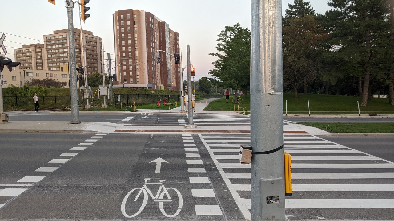

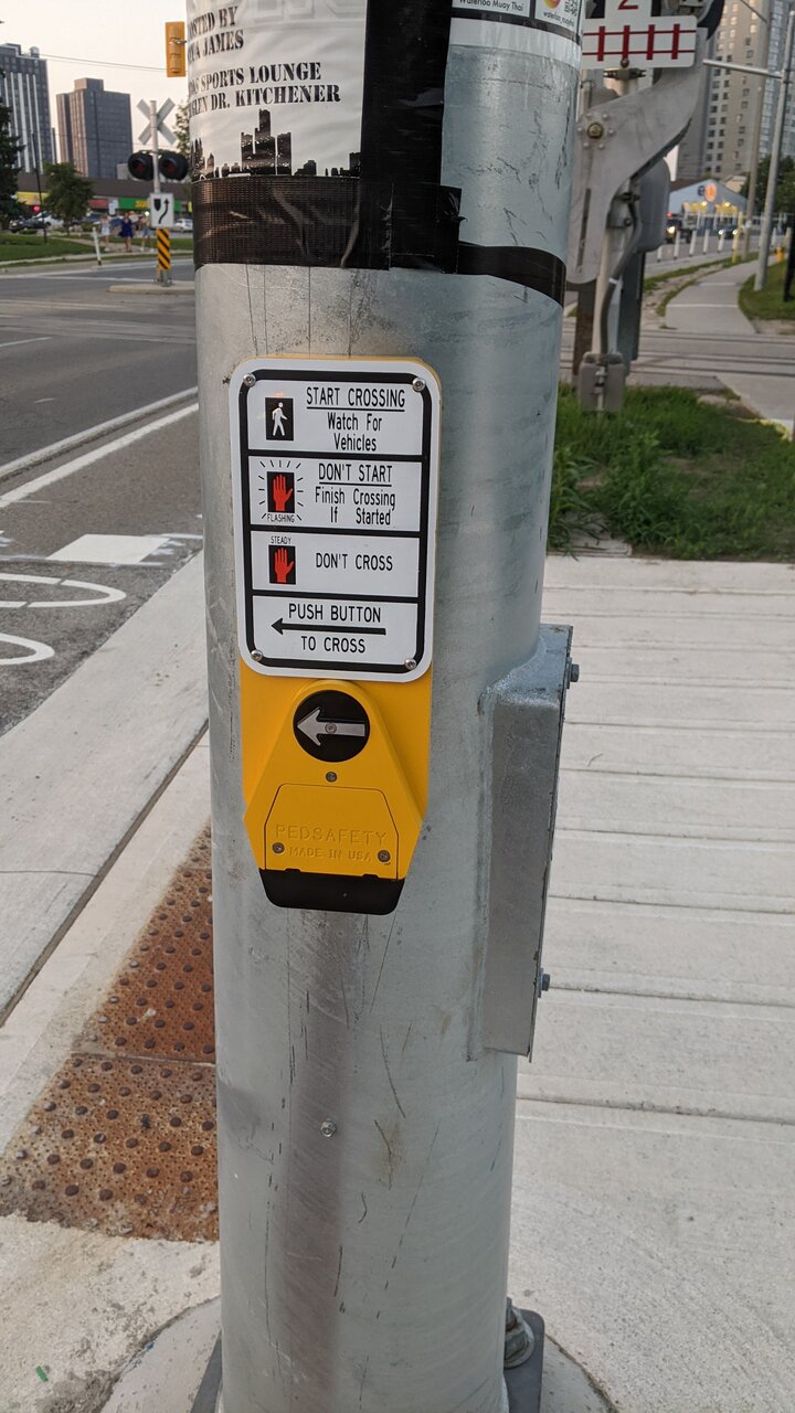

Not Toronto, sorry, but does anyone here know anything about these new pedestrian crossing signals they installed a few weeks ago at the University Ave/Laurel Trail crossing in Waterloo?
They feel much more responsive from the pedestrian end to me (i.e. often pressing the beg button will immediately turn the vehicle signal yellow when there's no incoming traffic, and the ped light will immediately turn green if the button is pressed while the ION crossing gates are down, which didn't always happen before). Would love to know if there's anything meaningfully different with this new system, and whether these improvements are coming to other pedestrian crossings in Ontario.
When the signalling was rebuilt here, they also reconfigured the crossing to be a much wider separated ped + bike crossing, instead of the narrower shared crosswalk it was before. It looks like they've installed a traffic light (and separate beg button?) for bikes, but it's covered up for now.
I used to cross this intersection several times per day, and I still cross it very regularly. It gets a lot of foot and bike traffic. I'm really glad it was improved, the signal timing used to really bug me.

The operation you describe is known as uncoordinated operation. So the signal sits in the main street for some minimum amount of time, after which it responds immediately when someone presses the button.
This is possible with pretty much every traffic signal. It's not an equipment limitation it's just a question of priorities. In most places they don't like it because it can interrupt waves of cars, but it's far better for pedestrians, cyclists and transit priority.
There are some uncoordinated bicycle/ped signals in Toronto (e.g. Finch Hydro trail at Norfinch, Grantbrook and at Talbot), but they programmed a main street pedestrian signal in the timings even though there is no pedestrian signal across the path. So when it detects a pedestrian or bike, it waits 5 seconds for the pedestrian countdown on the non-existant pedestrian signal.
All it would take to resolve this issue is to change the main street recall mode from "pedestrian recall" to "vehicle recall", which is a matter of pressing a single button. But the city doesn't do this because it's not in their procedures. So at all uncoordinated pedestrian/bicycle signals in Toronto, pedestrians and cyclists always need to wait 5 seconds for no reason whatsoever.
There are plenty of intersections in Toronto where you have to wait at least a minute if you press the "beg" button.

It is possible with our existing signal equipment to allow the Walk signal to come on after the green has already started using a feature called a "permissive period". Basically the cutoff time for pedestrian calls is kept as late as possible, so if there's enough time left within the maximum green time to fit the Walk + Flashing Don't Walk, a pedestrian call can be served right away.
Here's an example presented by Jerry Schippa from the City of Madison, WI. He calls it "pedestrian reservice".
For minor streets, the maximum green duration is typically equal to the pedestrian crossing time, since that's already far more green time than required to clear the typical queue of vehicles. In which case regardless of how the signal is programmed, there will no longer be enough time to serve the pedestrian phase after the light has turned green. To make pedestrian reservice work, you need to increase the maximum green time by the equivalent of the desired permissive period. Jerry increases it by a couple seconds to account for the time it takes to walk to the button. After these couple seconds, the signal won't immediately respond to pedestrian calls, because there isn't enough time anymore.
For major streets, the policy in Toronto is that the signal should rest in Walk until there's actually some specific reason for the light to end (either a timed end-of-green moment or someone detected on the side street). In which case there would only be Green + Don't Walk if there is currently a TTC bus/streetcar extending the green light (and the signal therefore doesn't know exactly when the green will end). But in some other places, including York Region, signals can also rest in Green/Don't Walk, which works really well at intersections with few pedestrians. In that situation, when someone is detected on the side street, the main street signal can immediately change to yellow, whereas in Toronto the person on the side street would first need to wait for the main street pedestrian countdown. If a pedestrian is detected on the main street while the signal is resting in Green / Don't Walk, the pedestrian signal can change immediately to Walk.
There's an example of this right at the start of this video of mine (filmed at YMCA Blvd & University Blvd near Unionville GO Station).
There is some debate in the traffic engineering community about whether the Walk signal should be allowed to start after the green has already started for a movement with a permissive conflict with the crosswalk (e.g. right turns on green are permitted). The concern is that someone turning right could see a pedestrian standing still or even see the "Don't Walk" signal and assume that they can turn without yielding, but then the pedestrian gets a Walk light and steps out in front of the turning vehicle which wasn't expecting to stop. In the Netherlands, it is fairly common for signals with permissive right turns to include the constraint that the Walk or Bike signals can only start simultaneously or earlier than the parallel vehicle signal. If the signal is resting in Green/Don't Walk and a pedestrian/bike requests the main street green, the signal will first go to yellow, then red along the main street, before the ped/bike signals can start and the main street signal goes back to green.
While there is some logical justification for this constraint, I'm not convinced that it actually improves safety overall. There is a signal in a Dutch city which I programmed where there are no right turn signals along the main street, so the City required the bike and ped signals to start simultaneously or earlier than the parallel vehicle signals. No problem I thought, we'll just make the bike signal turn green every time the parallel vehicle signal turns green (like it does virtually everywhere in Toronto). But no, the City insisted that the bike signal should only turn green if there is a bike detected, because the red clearance time for bikes is (marginally) longer than the clearance time for cars. As a result, most of the time cyclists arrive and get stopped at a red light for no apparent reason. And after seeing that the parallel traffic has a green, they just ride through the red light.
