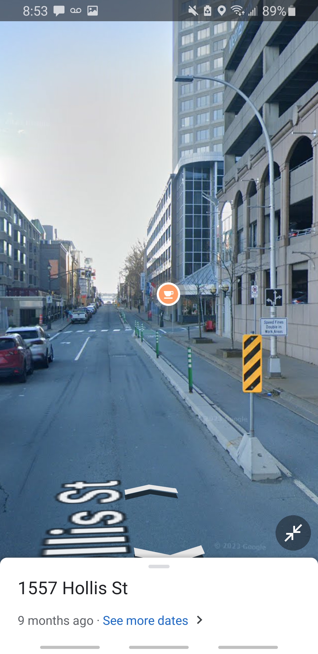

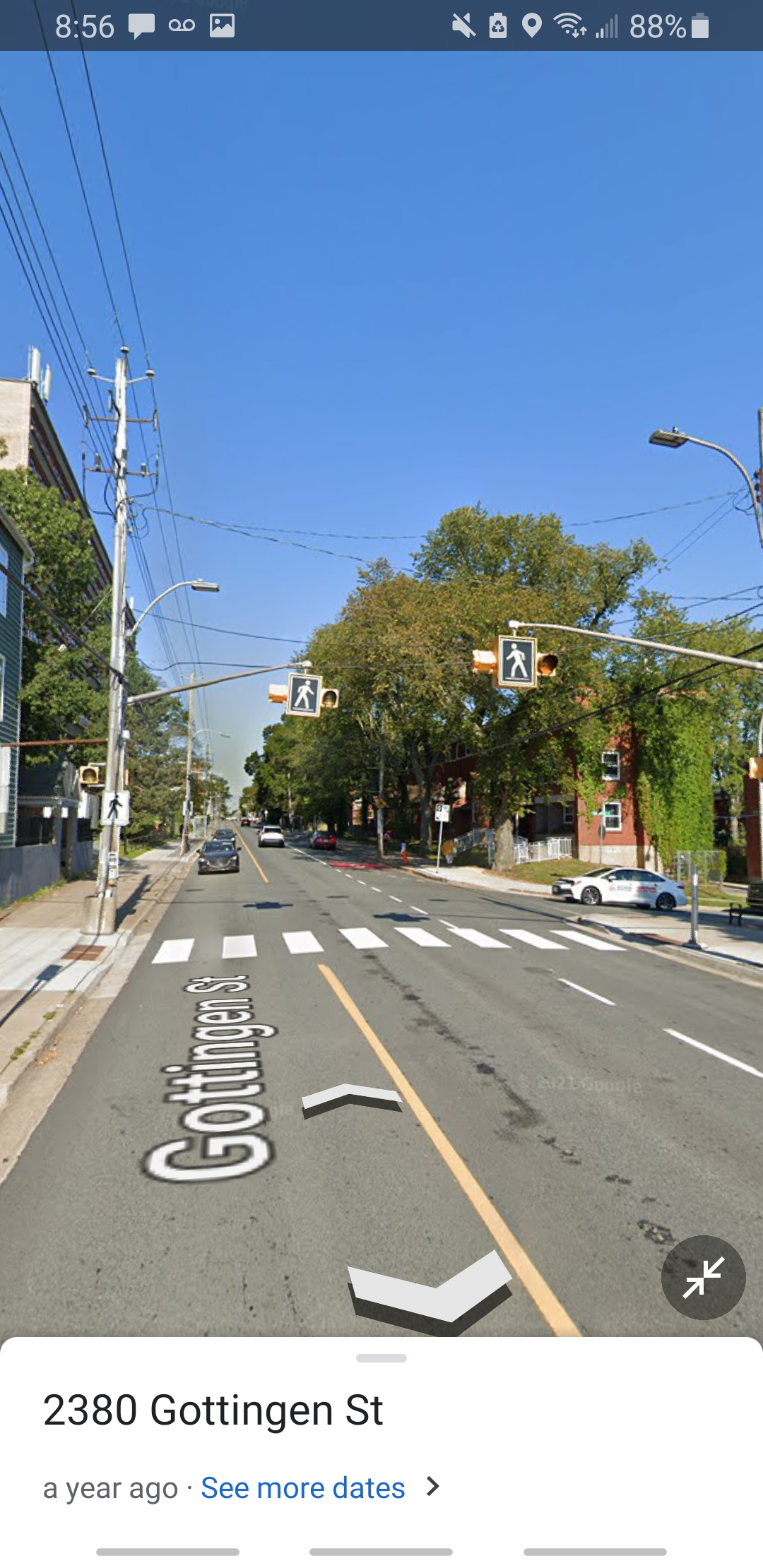

So I just visited halifax and saw how little traffics lights there are. Pedestrian crossing are used very often and allow safe mid block crossing. Traffic moves effectively and is only stopped when required. I am convinced a sizable amount of congestion in Toronto is due to city council and their traffic light spamming. Halifax also is implementing vision zero principles using flexy posts and concrete curbs. Oh and these are not the Toronto ones that are tossed around by a vehicle hitting them. They are bolted to the pavement and have standard height signage attached to the top. Gottingen street halifax is good example.Screenshot_20230810-085328_Maps.jpgScreenshot_20230810-085649_Maps.jpg

So I just visited halifax and saw how little traffics lights there are. Pedestrian crossing are used very often and allow safe mid block crossing. Traffic moves effectively and is only stopped when required. I am convinced a sizable amount of congestion in Toronto is due to city council and their traffic light spamming. Halifax also is implementing vision zero principles using flexy posts and concrete curbs. Oh and these are not the Toronto ones that are tossed around by a vehicle hitting them. They are bolted to the pavement and have standard height signage attached to the top. Gottingen street halifax is good example.View attachment 498935View attachment 498942
I wouldn't say 'safe mid-block crossing' for Toronto. I use the pedestrian crossings with the (many times correct) assumption that cars are not going to stop.
Just because Toronto's unsignalized crosswalks are poorly designed does not mean that unsignalized crosswalks are inherently unsafe.
