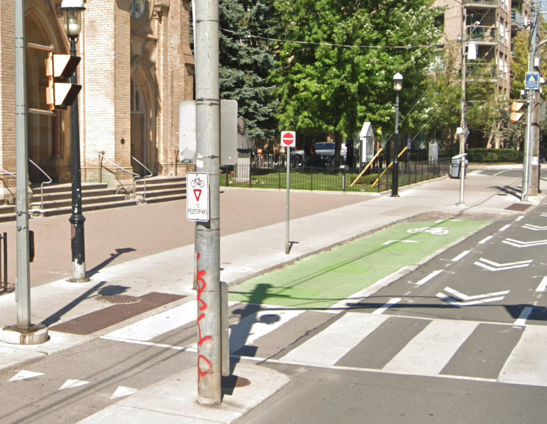

I have a traffic signal question related to bike signals. There are 2 locations in Hamilton I've been interested in the logic behind the bike signal timing and whether it can be changed:
1. Bay at King and Bay at Main (https://maps.app.goo.gl/v7xTTRukTtdeGT5g6?g_st=ac)
Here the bike signal doesn't go green during the LPI and instead waits for main green light for cars. Is this just a simple programming change or would there be a reason why they would keep the bike signal red?
2. Cannon at Sherman travelling East(https://maps.app.goo.gl/AUTH6DqmJD8iCuVo8?g_st=ac)
This is the transition of Cannon from one way to two way so the bike lane splits. The issue is that the crossing of Cannon at the East side of the intersection is 2-stage, so the eastbound bike signal has to wait an additional 20-30 seconds after the westbound green until the pedestrian phase of the 2-stage crossing is complete. There is then a relatively short green for the bike light before it goes back to red to allow for the Sherman traffic phase. This is one I'm quite curious about, as ideally you could have a bike green with some signal to yield to pedestrians. They are currently rebuilding this interesting and converting Sherman fully to 2-way traffic, so I am hoping signal changes can help the long bike delay.

The typical way to control a bike signal is as an "overlap" of the vehicle signal. So basically it just copies what the vehicle signal is doing (potentially with some additional logic conditions). When you implement an LPI using the basic LPI setting in the controller, it just adds 5(?) seconds of red at the start of the phase. Since the bike signal is copying the vehicle signal it gets those 5 seconds of red as well. I doubt that's what the city wants, but it would be a decent amount of work to change the setup to avoid adding that red time to the bike signal. One way to get the bike signal to start with the ped phase instead of programming a 5(?) second green delay in the vehicle phase, they could add a 5-second dummy phase before the vehicle pahse and have the bicycle phase and pedestrian phase overlap with both it and the vehicle phase. The challenge is that the pedestrian phase is typically not wired as an overlap, so implementing this would require redoing the input/output mapping, which is a major change that can't just be implemented on the fly like timing changes.

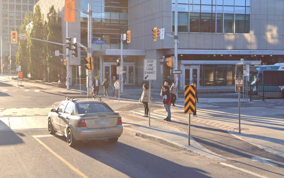

It is possible to let bikes proceed while yielding to pedestrians but you need to be careful with the design to make sure it's clear to cyclists that the green light doesn't apply to the pedestrian crossing. This is becoming increasingly common at protected intersections, where the crosswalk across the bike path is not included in the signalized crossing.
Here's an example on Laurier St at Waller St in Ottawa. The pedestrians are standing in the absolute worst spot to wait for the light to change - this is common on bike paths that lack any height difference with the sidewalk. More recent designs usually have a 5-6 cm curb (with wheelchair ramp) to make the cycling path more obvious to pedestrians.

Northbound on Bathurst at Adelaide cyclists also have an unsignalized crossing of a signalized crosswalk, but in that case there's no northbound bike signal so there's less chance of cyclist confusion.

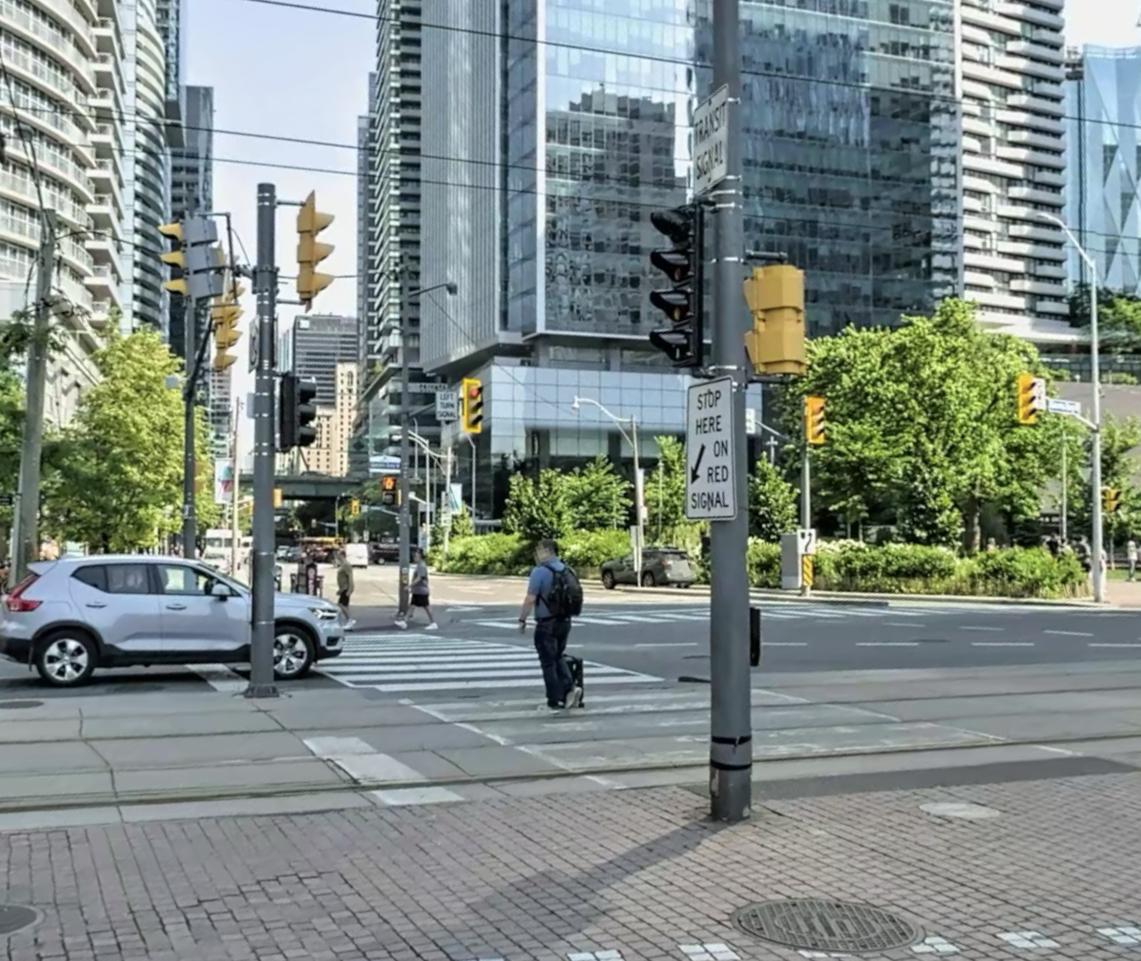

Oh, have you seen Queens Quay where oblivious pedestrians stand in the middle of the streetcar ROW waiting for the light on the tracks where streetcars are usually barrelling down the corridor?

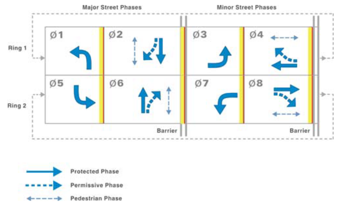

An overlap is a signal group that is not actually included in the phase structure, it sort of exists separately and you need to define its state relative to other phases that are actually in the phase structure. It is an absurd solution to the self-inflicted constraints created by the "ring and barrier" phase structure. which usually only includes 8 phases at a standard intersection.
For example if you wanted to add a northbound right turn phase, you'd create an "overlap" of phase 7, telling the right turn signal to turn green whenever the westbound left turn phase does. Or if you're really fancy you'd tell it to overlap with both phase 6 and phase 7, but only if the pedestrian phase for phase 6 isn't on (because the ped phase conflicts with the right turn).
The ring and barrier structure is how they used to control signals when there was a literal ring with metal strips on it that would rotate and complete different circuits as different parts passed by the electrical contactor. So different lights get connected to power at different points in the ring's cycle. The barriers connected rings together at certain points in the cycle to prevent them from getting out of sync with each other.

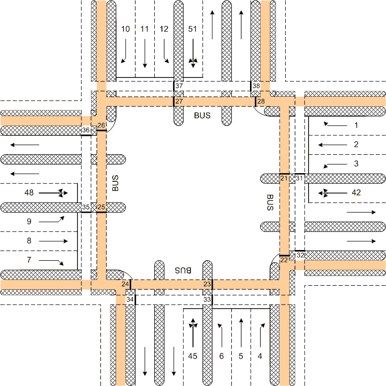

In the Netherlands in the 1990's they realized that computers exist so there's no need for this arbitrary organization of signal groups. You can just tell the computer which movements can go at the same time as each other using a conflict matrix. (Which is something North American controllers also have!) A computer is perfectly capable of figuring out which signal groups are valid to combine based on the constrants the engineer has specified.
To this day North American controller manufacturers still use the ring-barrier structure, now offering four-ring controllers! Which still doesn't solve the probem because there is no way to arrange right turn phases in a ring-barrier structure that allows them to turn green at all of the moments when they should logically be able to!
In the Netherlands there's no such thing as an overlap. Every signal group is controlled directly and is included separately in the conflict matrix. If you want a predefined relationship between specific signal groups you can program that, but it's not baked into the control structure. So the Dutch standard numbering scheme includes a separate number for each movement. 1-12 are the usual vehicle movements, 21-28 are the usual bike movements (each leg accommodates 2-stage crossing with a green wave between them), 31-38 are the typical ped movements (again two-stage crossings), 41-52 are the 12 vehicle movements for transit signals, 61-72 are the 12 movements for vehicles if there's a second stage within the intersection (or a pre-signal), 81-88 are the usual bike movements in the contraflow direction (e.g. for two-way paths), again assuming two-stage crossings, and 91-98 are in case you need to use different signal groups for different directions on the same crosswalk (e.g. to enforce a pedestrian green wave). Here's a hypothetical intersection with its signal phases numbered. You'll note that every movement has a different number because they're controlled separately.
Image from wegenwiki

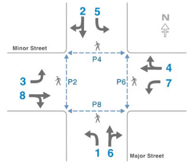

Meanwhile in simple old America, here's the standard numbering for signal phases at intersections. They give you 8 numbers. The pedestrian phase is the same phase as the adjacent vehicle phase.
You can always make up numbers for whatever you want, but the fact that the standard doesn't even consider the possibility of a right turn signal says a lot.
The pedestrian signal and the parallel vehicle signal are separate signal groups in the Netherlands because combining them into the same signal group would be stupid. A right turn phase along a street conflicts with the pedestrian phase to its right but not the vehicle phase to its left so of course those need to be controlled differently to each other.
Meanwhile the ring-barrier structure prevents valid combinations such as Phase 6 Pedestrian with Phase 3 Vehicle, because the signal thinks those two phases conflict. But in fact it's only the vehicle portion of phase 6 that conflicts with phase 3, not the pedestrians. And lord help you if you want to control the right turn signal based on the actual amount of traffic in the right turn lane, instead of just copying the signal states from a different movement.
To be fair, there aint no streetcars barrelling through this intersection....they crawl at a snails pace.
