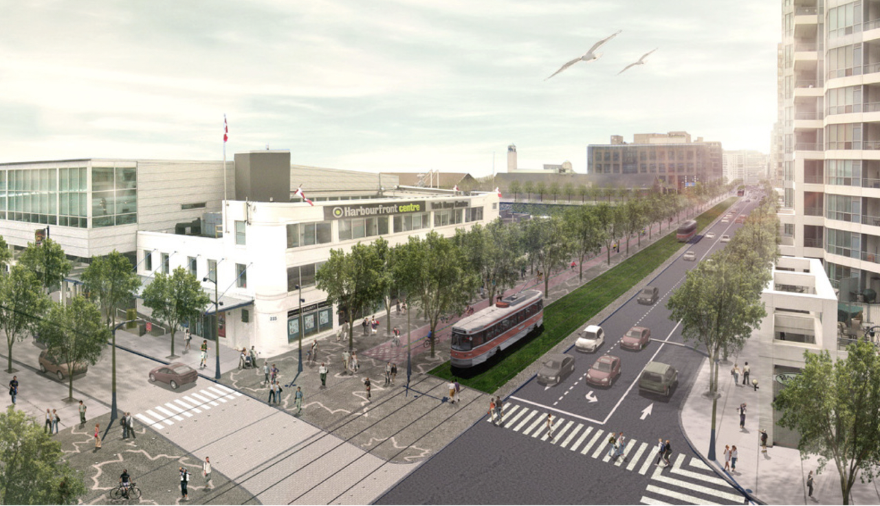

Hopefully this serves as a testing bed for a lawn track on Queens Quay as was originally intended for the streetcar ROW from Spadina to Bay St. It's now been done on the Finch and Eglinton lines so hopefully Waterfront Toronto follows those examples and then later expands it to the western section when the time comes to rebuild that track.
Besides more aesthetically pleasing, it helps with rain water runoff and most importantly, keeps cars out of the ROW, creating more visually defined separation for drivers.

I don't know how this relates to embedded track and switches. I would rather Waterfront not have a grassy median if it means better reliability. Line 6 had issues with switch heaters for embedded tracks, and my expectations are not high for them repeating the same mistake a 3rd time (Ottawa was the 1st time). Most of Eglinton does not have "lawn track".

As there is no grass as far as I know on Line 6, I don't know how that's an issue.
I could say (though it's not really relevant) that because we put grass on Line 5 and the switches work better than TTC streetcar track and Line 6 that don't have grass, we should put grass on Queen Quay East.
There aren't any switches in the segments that would have been lawned, just straight track. The reason given for cancelling the green track was that emergency services lobbied against having grass because they wanted to use the ROW. It's been a decade and as a daily user of the waterfront, I think I can only remember one time seeing a fire truck in the ROW. They simply don't use it because it's dangerous and impractical, they use Lake Shore Blvd. instead.

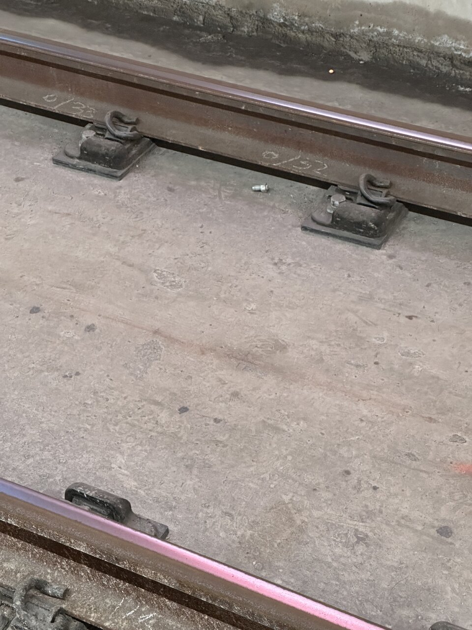

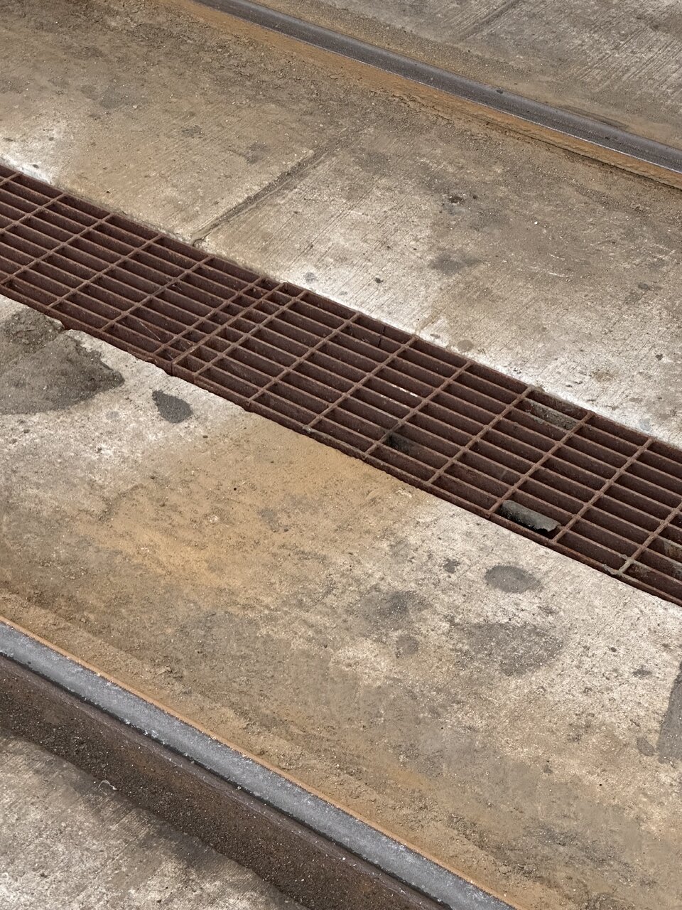

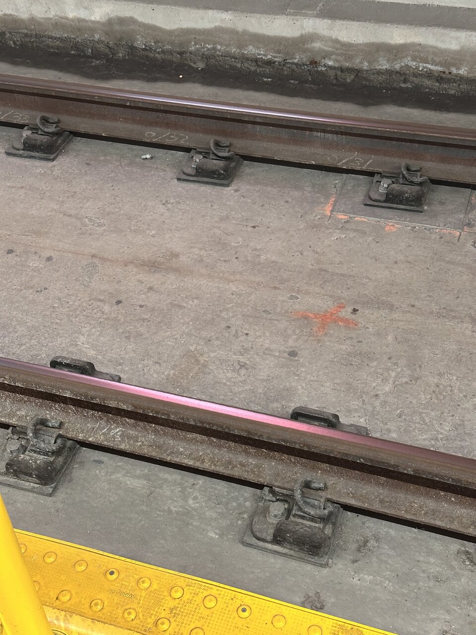

Not a scientifically empirically backed explanation but here are some pics of the rails between the Eglinton and Finch LRT. You can see the wheel-rail interface difference with the shine. These are taken at station stops.
Eglinton LRT:
Finch LRT:
The wheel profile on the Eglinton LRT seems to be very similar to the profile that the TTC uses for the subway.

Plenty of grass along Eglinton - as we can all see. I don't see how a couple of close-ups tell us much.

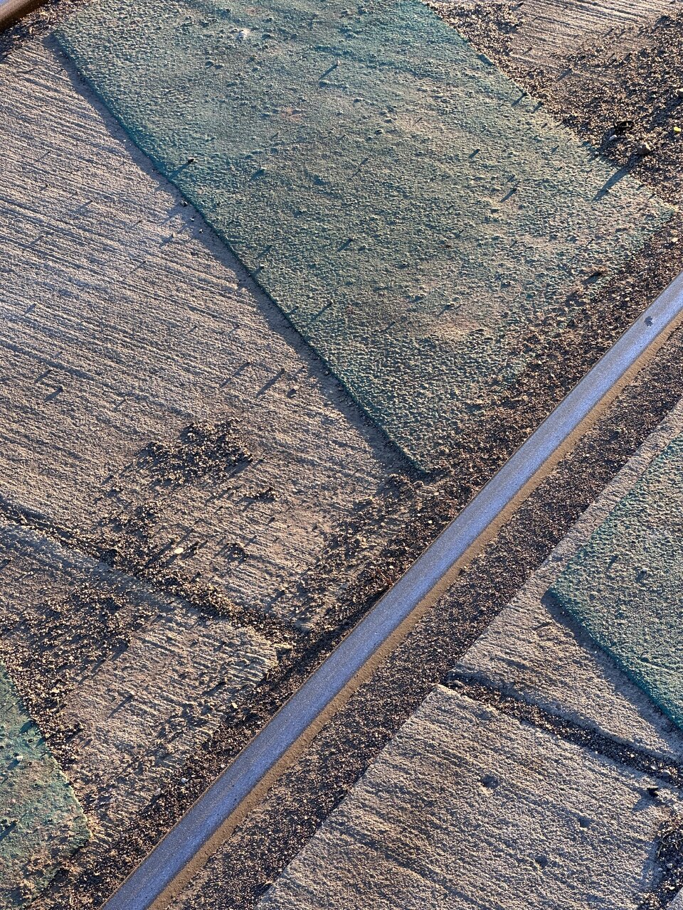

Grass on Queens Quay would be great, now we've seen how well it work son Eglinton. I was leery of it originally, given our harsh winters and dry summers. But here it is in August 2025 after 2-3 years and a hot summer and very cold winter (2024-25).

This screenshot makes me think the grass track is built more like Line 6 Finch West, than Line 5's non-grass sections, but I could be wrong:
I have no idea - but I'd think there'd be a significant amount of earth there. I don't know how deep the water system is. Or if it has a concrete base - I'd guess so; it's not like they are putting in trees.
All I really know is it looks good, works, and I want to see more of it. You can see how well it lasts and how green it is, in the photo in my last post. Hopefully they use it even more extensively on future liines.
