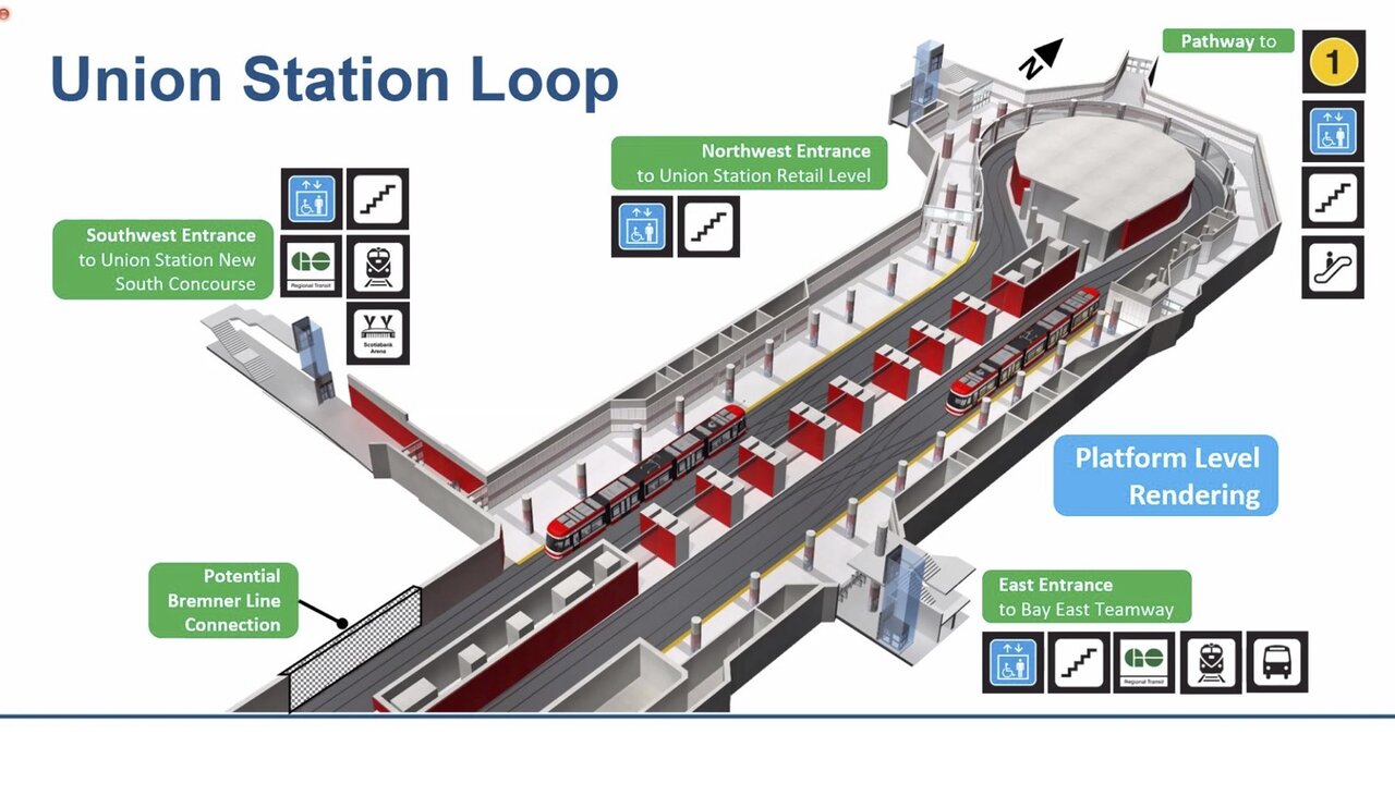

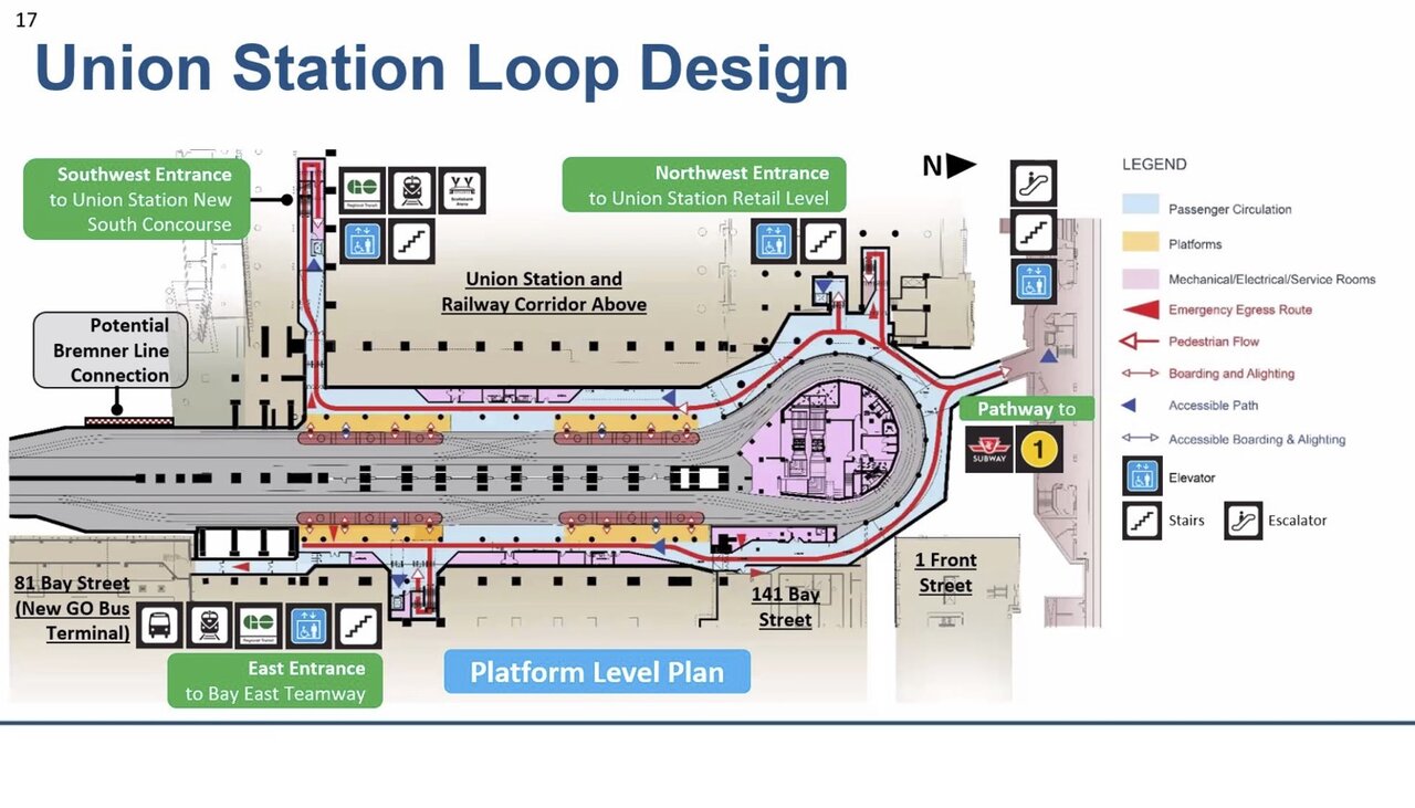

Assuming the Union Loop is built as per previous renderings, maybe someone here can break down future loading/unloading arrangements?
What confuses me about these renderings is related to how long the platforms are, and that they're depicted as accommodating two Flexities parked back to back, both on the East and West platforms. Is this basically future proofing for longer vehicles into the future?
It would be an impressive space nonetheless.
Edit* is this due to vehicles arriving from the East and having a Westbound vehicle taking their spot, and vice versa?

I think it has more to do with giving each route its own platform area since Union will be the terminus of 3 routes the 509, 510, and the East Bayfront line with a fourth platform serving as both an unloading platform as well as future proofing for a potential Bremner route.
