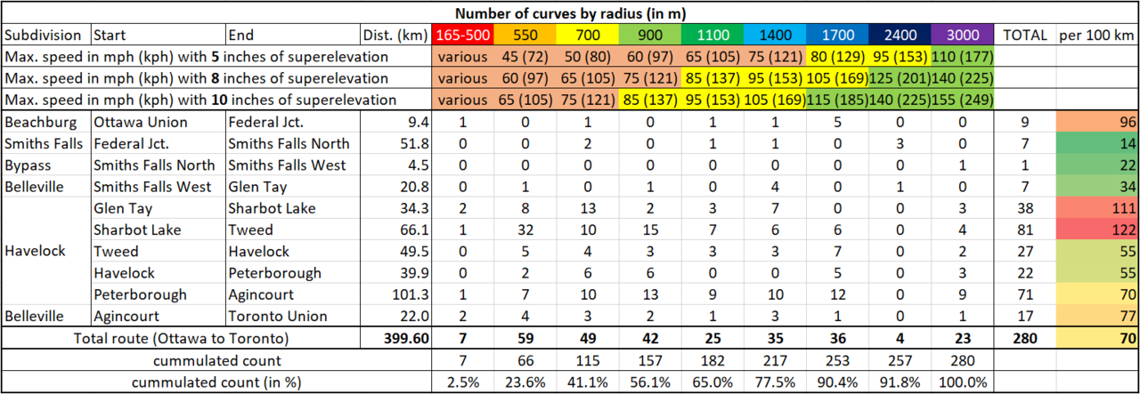

In terms of the curves, I reviewed my .kmz file (here the newest version) and found another 10 curves (of which 2 have a radius of less than 550 meters), for a total of now 280 curves (or one every 1.4 km):
Source: own calculations with track geometry data estimated by using the circle drawing function built into Google Earth Pro
As you can see in above table, a superelevation of 5 inches only allows HFR trains to keep their top speed (assumed at 110 mph) in curves of the highest category (i.e. a radius of 3000 meters), which means that more than 90% of all curves require the train to slow down and that means in the case of just under 80% of all curves to slow down below 76.4 mph (i.e. the average speed which is required to achieve a travel time of exactly 3:15 hours between Ottawa and Toronto). Conversely, with a superelevation of 10 inches, HFR trains could also keep their top speed in curves with a radius of 2400 or 1700 meters and would only have to slow down in just under 80% of all curves and below the 76.4 mph in only just over 40% of all curves.
