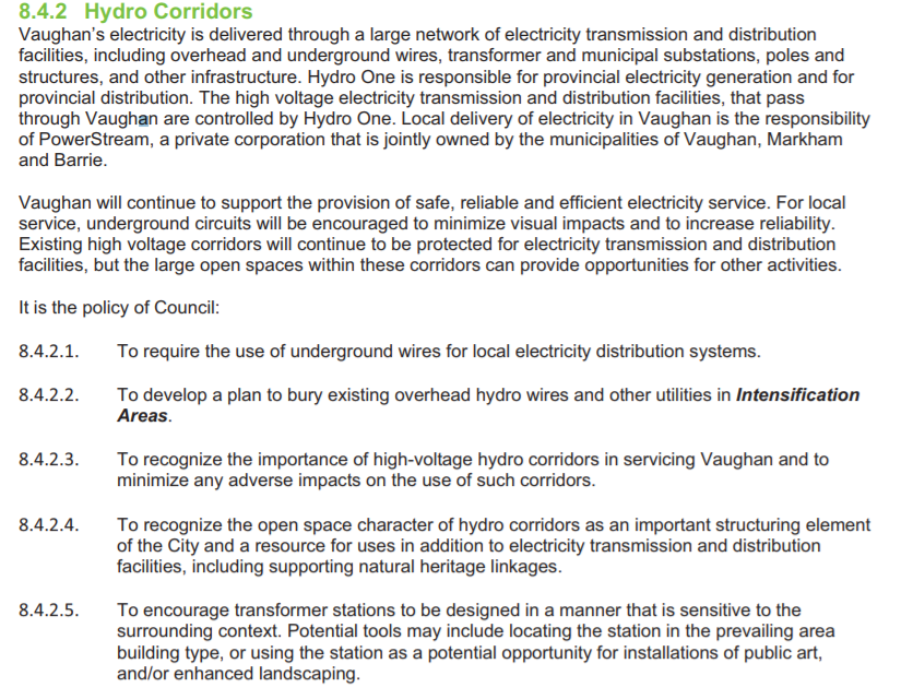

Fair enough and I'm no electricity expert but the towers at Finch and 407 are both high capacity/voltage lines, the burying which of is very different from the burying of streetside hydro (which is also not cheap). I'd love to see more of both happen but I'm looking around and, the projects you cite notwithstanding, don't see a lot of big spending on such things these days. This, for example, is from Vaughan's Official Plan. Note the distinction between wanting to bury hydro in urban areas and maintaining the high-voltage corridors:
