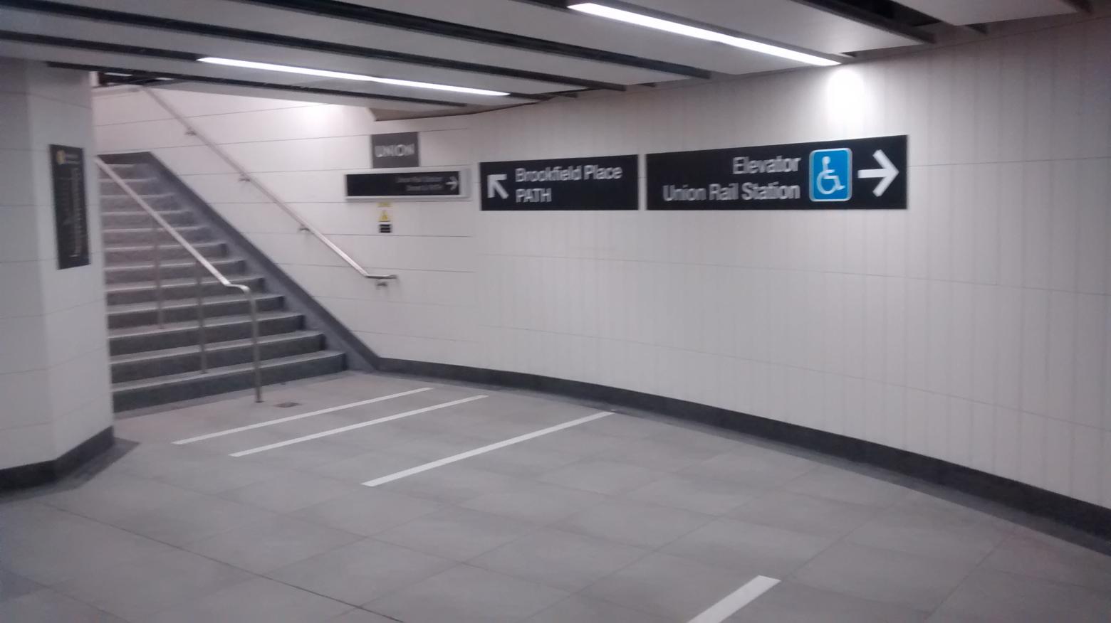

I thought that too, but I'm at a loss to think of anything better either.
A few VIA, GO (and eventually UPE) logos could help I suppose.
That's what I thought too -
The logos would differentiate those services from the TTC Subway
Maybe they should just say "To VIA Trains, Go Trains and Union Pearson Express Trains"
The sign is sort of already in the Union Station complex.
