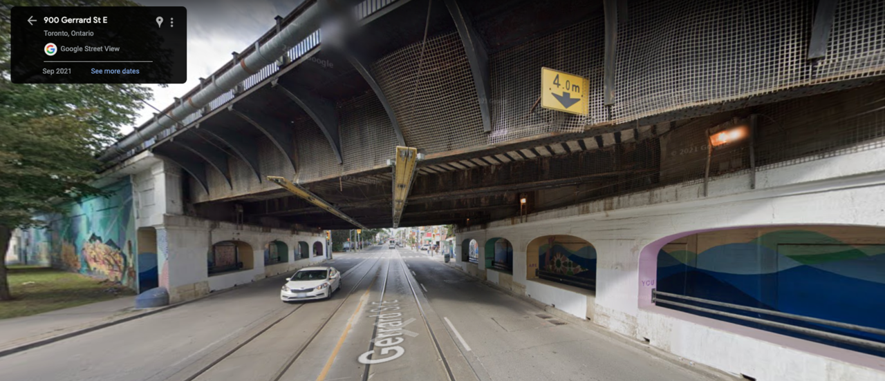

The current bridges have maximum clearance of 4.0m. Wonder what the clearance will be with the new bridges?
From link
All the bridges will be raised to 5m as part o the Lakeshore East Join Corridor work.
Bridges will be replaced in consultation with the city and we will be building them to their current standards, with five metres between the bottom of the bridge and the roadway. By comparison, the Queen Street bridge has a clearance of only 3.9 metres. This means the connecting rail tracks must also be higher. They will be raised by 1.1 metres at Queen, 0.9 metres at Dundas, 0.6 metres at Logan and 0.8 metres at Eastern.
