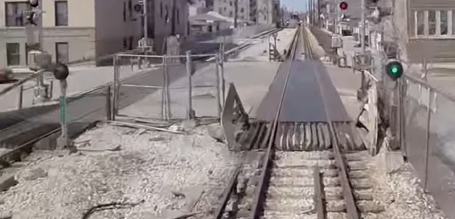

Grade crossings with third rail are essentially legacy issues. There was a Metro North crash at a GC not long ago where the third rail punctured the train. There was also a lawsuit in the early 90s where a guy was killed at a CTA grade crossing (Lee v CTA). Hard to imagine any new third rail crossing being built in North America given the difficulty of persuading courts and juries that even a guy with 0.341 BAC can be sufficiently warned or else deemed at fault.

Watch this video in real time from Chicago's Brown Line. Watch for the level crossings and see.
An 80-minute video with the level crossings towards the end? That's kind of cruel. This isn't some kind of Socratic lesson.
Jump to 1:18:15 - the third rail has breaks:
