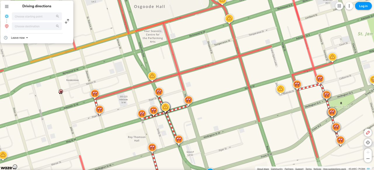

Just walked from Parliament to Yonge. Zero buses. Just one out of service.
Tons of cars driving through tho.
Excellent transit service. What an embarrassment.

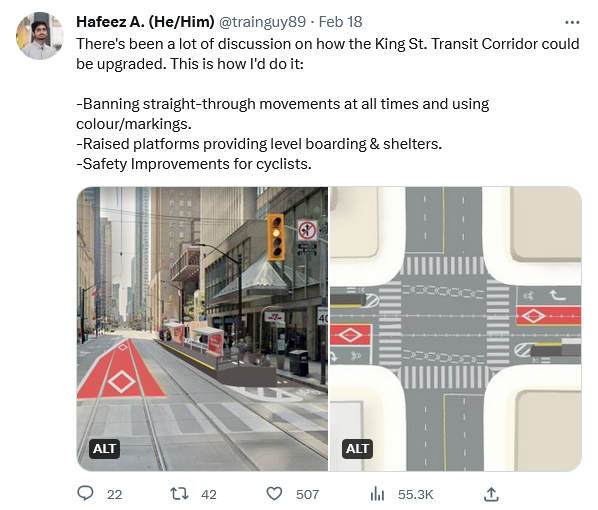

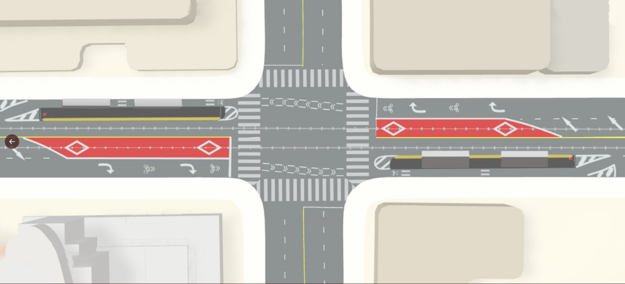

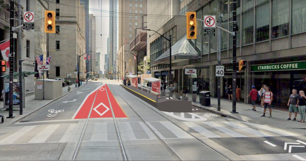

UT's @H4F33Z has put forth his ideas for improving the King Street Transit Corridor below. I like what I see here, I'd work on the streetscapes too, but he was focusing on function
Some close-ups:
Taken from: https://twitter.com/trainguy89

I would have added red, yellow, and green right turn arrow lights, and transit priority signal lights. Over the lanes AND catenary lines.

Could be implemented with the proper use of sensors to switch from flashing or steady red arrows.
Maybe "permanent" red left and straight arrow traffic signals.

By banning straight through traffic how do you do deliveries to those business'?
