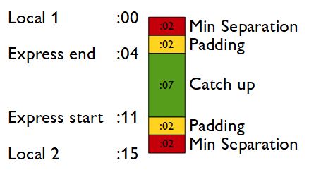

Even with moving-block signaling which allows trains as close as 60 seconds, a single shared track would still only allow the express to be 9 minutes faster than the local. But realistically we'd want express services to skip 5 or 6 stops between Union and Pickering, which would make them 10 to 12 minutes faster than the locals. And VIA trains are even faster still.

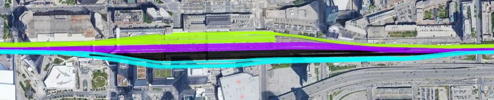

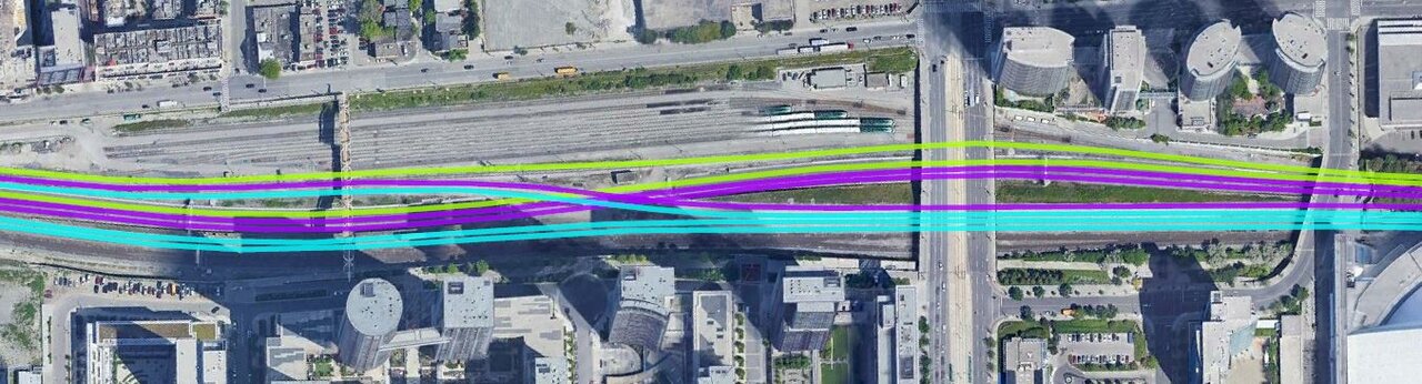

Another question is what this reorganisation does to the USRC. The current layout of the flyover west of Union allows westbound lakeshore/stouffville/barrie/kitchener trains to generally head through the middle of the corridor, while eastbound trains hug the southern edge. Between them there's room for services to terminate and head back the other direction, without crossing the Lakeshore local services.
Cyan: eastbound lakeshore/stouffville/barrie/kitchener
Magenta: westbound lakeshore/stouffville/barrie/kitchener
Black: turnback platforms (VIA, terminating services etc)
Light Green: other (UPX etc)
<--- toward LSW, Milton, Kitchener, Barrie | | toward Union Station --->
With both directions of Lakeshore service hugging the south side of the corridor, VIA's Windsor, Ottawa and Montreal services would either need to cross westbound service at-grade to reach their current platforms, or they would need to depart from platforms 24-27, which aren't directly connected to the VIA concourse.

The 3-track segment between Scarborough and Guildwood is about 11 minutes long, so if you assume that it alternates throughout the day, there's room for 4 express trains per hour, total (2 in each direction). Given that Via already operates about 1 train per hour per direction off-peak, that would only leave room for 1 express GO train per hour per direction. During the PM peak, Via operates 2 trains per hour in the peak direction so more likely the full overtaking capacity of the third track would be used in the peak direction for 2 additional GO express trains per hour with no counter-peak express service (and Via trains crawling along between local GO trains).
In total LSE off-peak service might be 4 tph GO local, 1 tph GO express, and 1tph Via. Which is only 1 tph more than we had in 2021. That would be a pretty sad outcome of the multi-billion dollar GO Expansion, but that's what would happen if they cancel the track expansions east of Scarborough Jct.

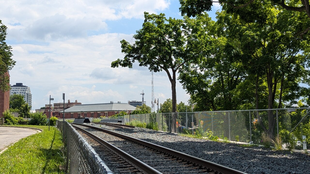

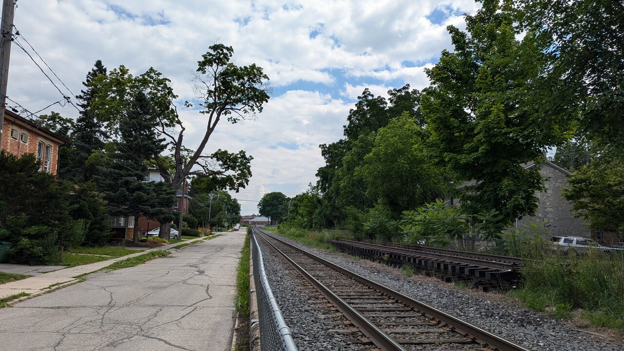

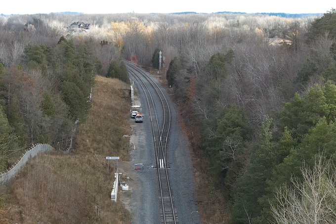

Question: with this and the potential completion of the new Guelph platform would this open up the possibility of Kitchener-Guelph round trip service even when the Kitchener line trains stop going west of Bramalea?
The new GO platform is not ready for use, because the track going to it is not tied in. Last I checked, things haven't changed from these pictures I took in July.
Speaking of the Guelph siding, some (non-)progress pictures from today. Retaining wall has been done for a long time, but the ballast and track assemblies still lay piled.
It would, but it sounds like the west end of the Guelph platform isn't going to be connected to the mainline anytime soon.
