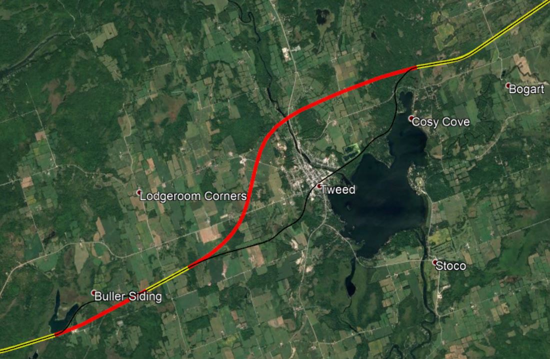

Here's a rough attempt. I figure the diversion as being about 34.2 km long. Using the worst-case price scenario of $10M per km that's $342M to build. However - it replaces 33.8 km of the old right of way, which will probably cost VIA $5M per km to refurbish anyways. So the incremental cost, is closer to $175M, on a very rough guesstimate basis, assuming no major bridges or tunnels etc on either route.
For that amount, VIA avoids roughly 10 km of curved track that (by my inexpert gaze at the map) would probably require 80 km/hr restrictions. These zones are spaced such that trains would not be able to accelerate very much between zones before having to slow down again. I would predict a regulatory speed restriction of 50 km/hr through Sharbot Lake, given the line goes right through town. So speed throughout that zone would be restricted.
The route alongside Highway 7 is remarkably even terrain - at least on the map, Highway 7 has found an easier route through much of that territory, following the contours of the land and avoiding more swampland. And there could be far less curvature - it would be reasonable to assume higher speeds end to end, with much less need to accelerate and slow down for each curve.
On the back of an envelope, from pure speculation, one can predict a time savings of five minutes or more for that $175M. I wonder how that would fit in HFR's budget relative to other possible speed improvements.

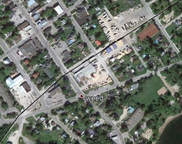

PS - Don't overlook the cost of moving the whole town. Sound farfetched? That's how the St Lawrence Seaway got build. See here. It was doubtless heartbreaking for the residents along the old river, but 70+ years later I think most would agree it was the right thing to do, given the huge benefit that the Seaway has delivered. My guess is that Sharbot Lake could be relocated in total for half that amount. I wonder if the assessed value of every property in town exceeds $100M. I'm not arguing for that, I'm just pointing out - expropriation happens.

... looking on google earth Shabot Lake (the town) looks to have "built" up alongside the former trackbed (ie a marina, a couple new buildings), and with the trackbed so close to the lake I dunno if they could run trains through there without tearing up everything that has already been built.

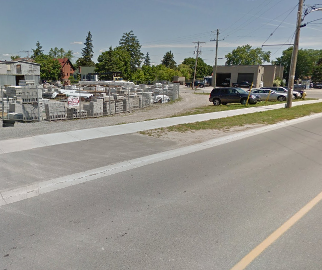

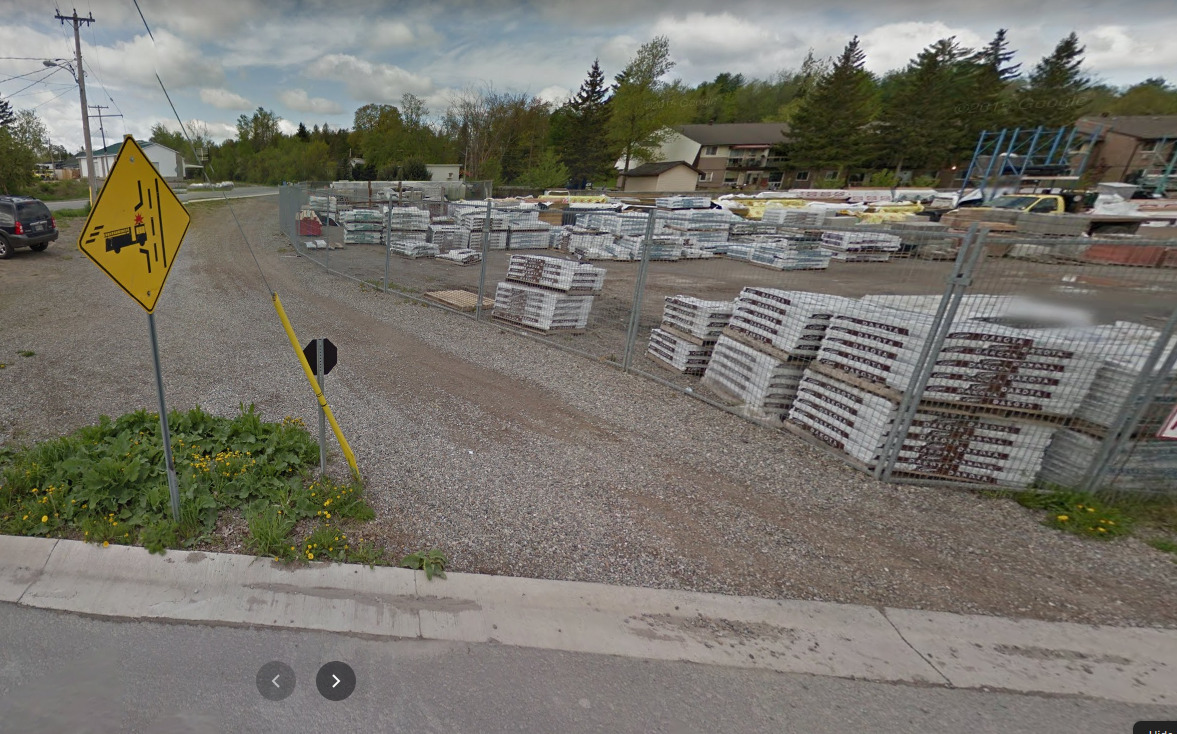

One other thing to consider, both around Sharbot Lake and elsewhere, are the number of private/public roads and driveways that have crossed the ROW, many most likely since abandonment. Depending on the speeds envisioned, level crossings would either need to be eliminated or signalized, which would seem unusual for a cottage laneway. Building alternative roads or even expropriation might have to be built into the costs.
The village has always been centred on the junction of the former Kingston & Pembroke and Ontario & Quebec (CP) railways, which met at the causeway at the narrows.

I'm sure they wouldn't. All the same....zooming in on the top map, I count only 21 properties in Sharbot Lake that adjoin the railroad row. At, say, $2M a property, it would be a lot cheaper to buy out these residents than to move the line elsewhere.
No question, there will be a lot of this along the entire line. If one looks at Streetview, there are many tire tracks visible, and even some vehicles, on the ROW. It's hard to tell how much is "necessary" access versus pleasure driving. But again, a glance at the top map suggests the number of "stranded" properties may be fairly small, actually.... the one benefit of having built thru so much swampland all those years ago, perhaps.

It's not so much just the properties abutting the ROW as it is once you start cutting the centre out of the village centre (such as it is - pop ~ 1400) and effectively cutting it in two, it becomes highly disruptive to what remains. I wasn't aware there were long term MTO plans to re-align Hwy 7 that far west. If there is, you are right that this would be an ideal opportunity to solve both issues. I assume the highway plans are long into the future.

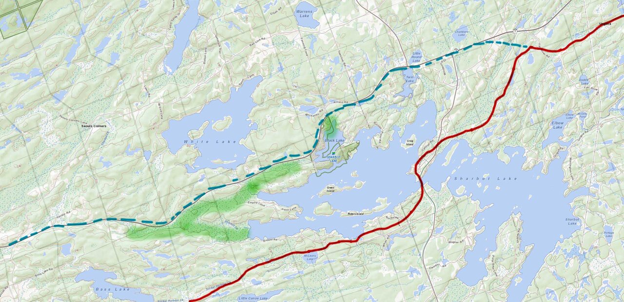

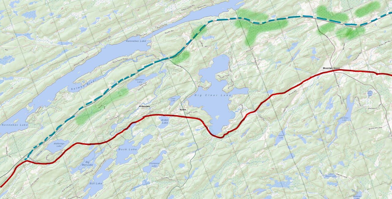

Great to see this visualized. What base map did you use? Just as some additional options, for the west, if they need to reduce the property acquisitions along Highway 7, they could could do this:
For the east, I assume that local residents also wouldn't like this, but there's a string of islands that could be used to the south of the town. But maybe they wouldn't provide very good foundations and it wouldn't be worth it. I'm certainly not a civil engineer. What are those light green areas on the map? Wetlands?
Ontario has a cool web site for top maps
That would work. I was trying to capitalise on how close the rail line is to Highway 7, and to bypass as many tight curves aspossible.
I saw that too....interesting idea. I measured the gaps between islands, and figured the spans would be just long enough to cost a lot. And the boaters would expect high clearances, so the whole thing would have to be elevated.. And ugly, no matter how artfully it was designed.
The green was just to make the wetlands stand out, yes. Probably need to stay out of those.
