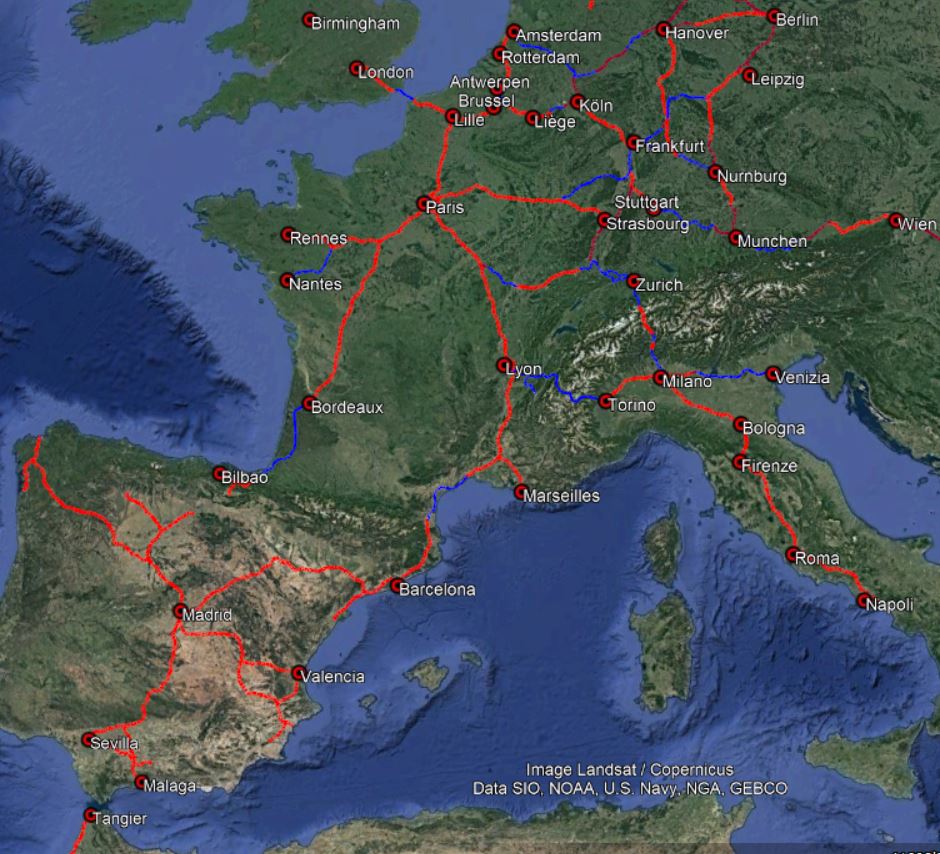

Sure, let's look around the world at some 300+ km/h trains.
Siemens Velaro, used in Germany, England, China, Russia, Turkey, Netherlands, Spain, Belgium, Switzerland, France - doesn't tilt
Alstom TGV, used in France, Korea, Spain, Morocco, Switzerland, Belgium, Netherlands, Germany - doesn't tilt
Alstom AGV, used in Italy - doesn't tilt
Bombardier Zefiro, used in Italy and China - doesn't tilt
TREVI ETR500, used in Italy - doesn't tilt
Hyundai Sancheon, used in Korea - doesn't tilt
Hitachi/Kawasaki E2, used in Japan and China - doesn't tilt
CRRC CRH380A, used in China and Hong Kong - doesn't tilt
CRRC Fuxing, used in China - doesn't tilt
The above list includes every wheeled 300+km/h trainset in service according to the wikipedia list of high-speed trains, except for the JR N700, E5, and E6, which have active tilting, and the Talgo 350, which has passive tiliting.
In general, 300+km/h high speed trains do not tilt. The main exception is in Japan where the Tokaido Shinkansen has a relatively low speed limit (around 270 km/h for non-tilting trains) since it's the world's oldest high-speed line and originally operated at only 210 km/h. The rest of the world's 300+ km/h high-speed systems build the lines to the intended operating speed and do not need tilting trains.
It is the nature of higher speed. If a line had to be built for speeds over 300 km/hr without tilting trains, you would need straight track the entire route. That doesn't work in the real world.
Yes, to run 300 km/h, they do indeed need to "straight track the entire route", as you say. That's what all those high-speed rail lines are about. They have enormous curve radii, to allow trains to operate at 300+ km/h.
High speed lines in red (>=250 km/h)
