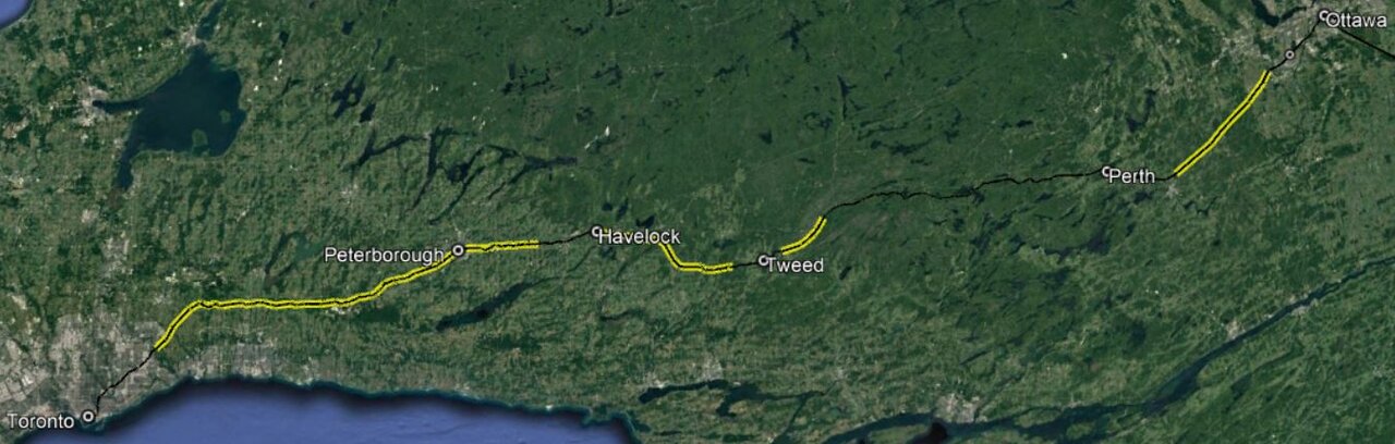

These are the segments which appear to be upgradeable to 110 mph operation using curve widening and some relatively feasible realignments.

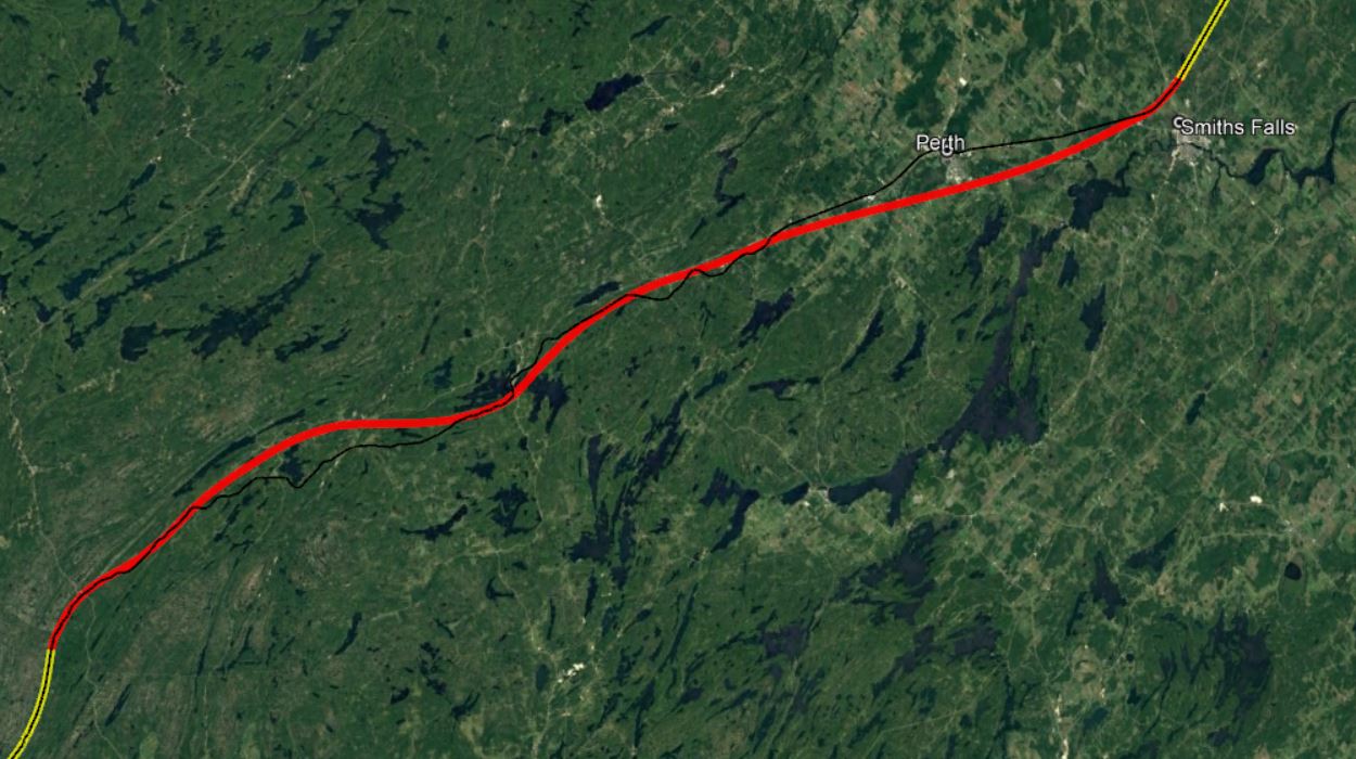

The biggest challenge is the 102 kilometres between Kaladar (east of Tweed) and Smiths Falls.
For the 87 kilometres from Kaladar to Glen Tay (just west of Perth), the line traverses rough rocky terrain dotted with lakes. As a result, the line follows a meandering path with frequent tight curves, with a radius of about 550 metres. This would only allow speeds around 80 km/h (50 mph) or so. Basically none of the existing ROW is useable for 110 mph operation since the curves are too close for the realigned route to rejoin the existing ROW before the next curve.

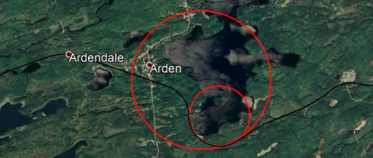

Big circle is 1300m (approx radius for 110 mph), small circle is the existing radius: 570m

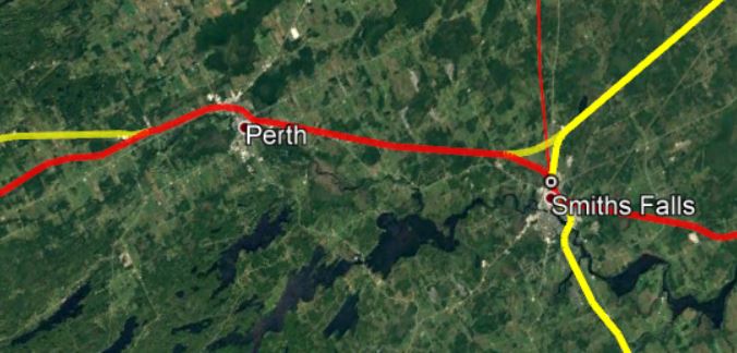

For the 15 kilometres from Glen Tay to Smiths Falls, the route follows CP’s main line. Given that the whole point of the HFR project is to avoid interference from freight trains, this segment will need a new ROW, whether it be adjacent to the CP line, or along a completely different route.
Given these challenges it seems like it’s a question of all or nothing for the 102 kilometres between Kaladar and Smiths Falls. If the line is to be improved at all, an entirely new alignment is required. Given the terrain, the new railway would need to make extensive use of bridges and cuttings.
But the plus side of all that grading is that the net cost of fully grade-separating the line becomes relatively low, especially since there are hardly any crossing roads in the first place. A fully grade-separated railway could operate well above the 110 mph limit that would be imposed by level crossings. VIA’s new fleet can operate at up to 125 mph (200 km/h), and it would probably be prudent to use an even higher design speed to accommodate even faster trains in the future.

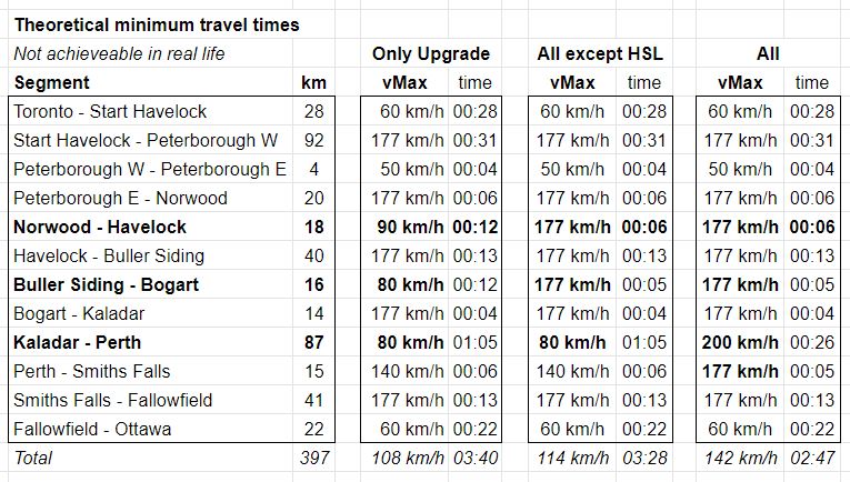

To get an order-of-magnitude estimate for travel time, I assigned a speed for each segment and simply calculated the travel time at that speed. This provides the theoretical minimum travel time given those speed limits. It is not possible to achieve this travel time in the real world because it does not account for acceleration/deceleration, miscelaneous slowdowns (e.g. through switches), stops (stations, meeting trains in the opposite direction) or schedule padding.
The speed limits in the slower segments were roughly based on the radius of existing curves, except for the segments within Toronto and Ottawa, which are based on existing GO Transit and VIA Rail schedules, and within Peterborough where I assigned a 50 km/h (30 mph) limit due to the numerous awkward level crossings.
I examined three options, which include varying degrees of new alignments. The first scenario only upgrades the easiest segments. The second scenario also fills in the gaps around Havelock and around Tweed. And the third scenario adds in the big-ticket item: a new 102-kilometre high-speed railway from Kaladar to Smiths Falls.
The interesting thing here is that in either of the options without the new 102-km high speed line (HSL), it is physically impossible to achieve the 3:15 travel time that VIA has been touting. Even if the trains had infinite acceleration, infinite deceleration, never stopped at stations, never slowed to switch tracks and never stopped in sidings to let trains pass in the opposite direction, those scenarios would still take longer than 3:15.
The HSL would cost several billion dollars on its own, so I don't get the impression that it's included in VIA's current concept. But I'd love to be proven wrong.
But on the flipside, if that line does get built, it may be possible to even beat the 3:15 estimate. Including the real-world factors, maybe the 2:47 theoretical minimum could plausibly correspond to a real-world scheduled time in the ballpark of 3:00-3:10.

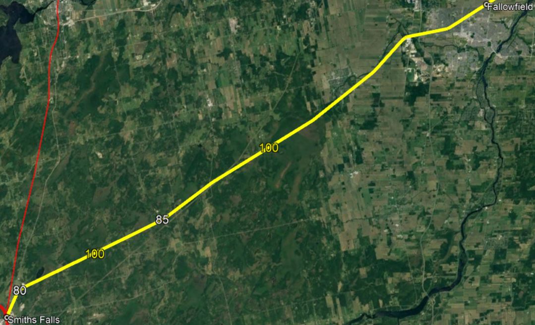

My concept for phasing would be :
1: Upgrade Smiths Falls - Fallowfield from 100 mph to 110, mostly for the sake of widening out the curve which currently forces trains to slow to 85 mph in the middle of an otherwise high-speed segment.
Existing speed limits (in mph):

Existing ROW in black, upgraded segments in yellow:

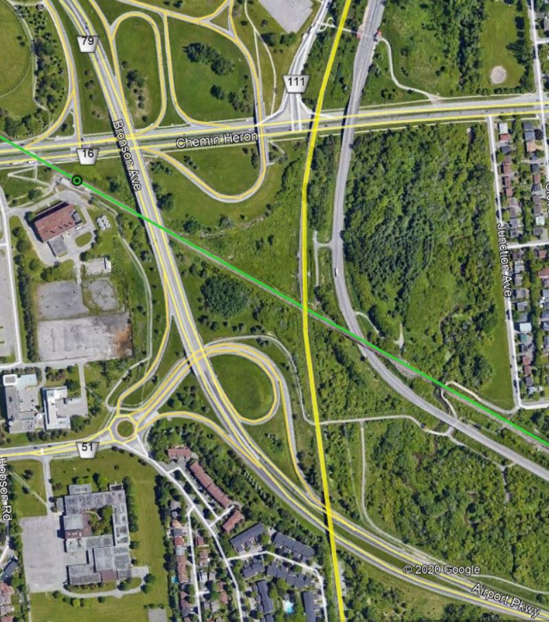

The Ottawa segment definitely needs to be upgraded regardless of HFR, HSR or status-quo. The elephant in the room is the O-Train Trillium line which already crosses the VIA line at grade every 5 minutes on average. It would be quite a project to grade-separate this crossing given the other grade separations in the area.
The O-Train line goes under Heron Rd and Bronson St, but then over the transitway. Meanwhile the VIA line goes over Heron Rd and over Airport Pkwy. I suppose a saving grace is that Ottawa would probably be interested in replacing some of those single-track O-Train grade separations anyway to allow the line to be double-tracked.

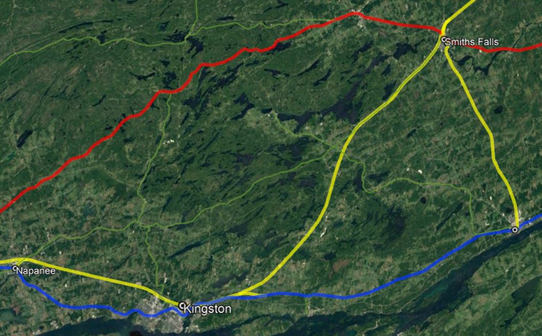

I too have also been known to promote a more southerly alignment in the past, as part of a 300 km/h high speed rail option.
Abandoned ROWs in faded green, CP in red, VIA in yellow and CN in blue.
I suspect the cost of a 200+km/h Kingston - Smiths Falls railway would be similar to the 200+km/h Kaladar - Smiths Falls line. The terrain is certainly easier, but it's also a lot more populated which means more road/rail grade separations, more expensive land acquisition and more political opposition.
Whether the southern route makes sense overall then depends on the intended speed. If the goal is 300 km/h high speed rail, then certainly the southern alignment makes sense - it's a lot easier to build there and can consolidate more of VIA's service onto the new line. But if the goal is only 110 mph at-grade rail, the prospect of reusing large parts of the Havelock ROW makes that option cheap enough that it probably makes more sense financially. Even with the costs of somehow getting VIA trains along and across the CP main line in Toronto and the need to continue running some service along the current CN route.

Actually, I believe that these two lines are going to be grade separated as part of Stage 2 Trillium line.
Oh you're right, I missed that when I was reading up on the project. In my defense it actually wasn't in the project overview.
