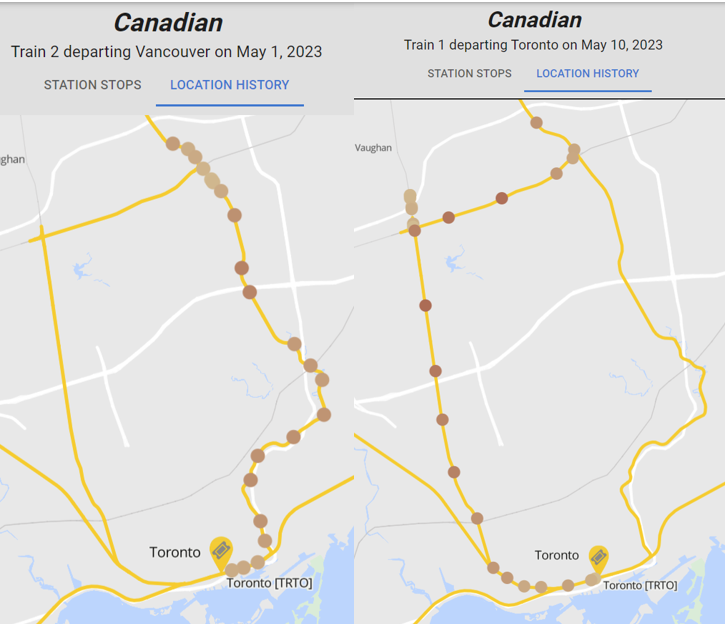

I am not sure how the suggested connection through "the park" at Doncaster (CN York-Bala) would help the Canadian. As shown below, train 2 arrives straight into Toronto on the Bala Sub (crossing the York Sub) and is facing west in the station. Then when Train 1 leaves Toronto, it continues west to the Newmarket Sub, and wyes onto the York Sub.
A connection between Newmarket south and York east would work, but it would be useless for detours because of the increase in distance traveled on CN's busy York Sub (better to wye at Bala), and for the Canadian, its not worth it for only 2 trains a week, and only in one direction.
