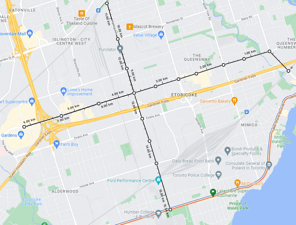

Always thought a network like this would make a lot of sense in the future. Connect the rapidly growing density in Humber Bay Shores and along The Queensway to Kipling Station, Park Lawn GO, Sherway Gardens, IKEA and Humber College..
If those black lines are streetcars / LRT, then which gauge will the use?
All TTC gauge, enabling the connection to Lakeshore West and service from the Roncesvalles carhouse?
All standard gauge. enabling the Kipling line to continue north of Bloor and connect to the Finch line?
Or, standard gauge on Kipling, TTC gauge on Queensway as a branch of Lakeshore West?
Which line will ultimately connect Mississauga City Centre to Toronto Downtown?
