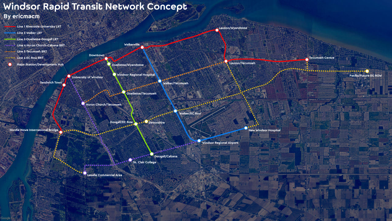

My updated concept for a Windsor Rapid Transit network. It contains 3 LRT lines and 3 BRT lines and provides coverage to all major areas, including some small suburban centres in Lasalle and Tecumseh.
could the blue and green lines be unified into a single LRT that interlines with the red line through the downtown? Would likely make navigation easier and create a lot more one seat rides.

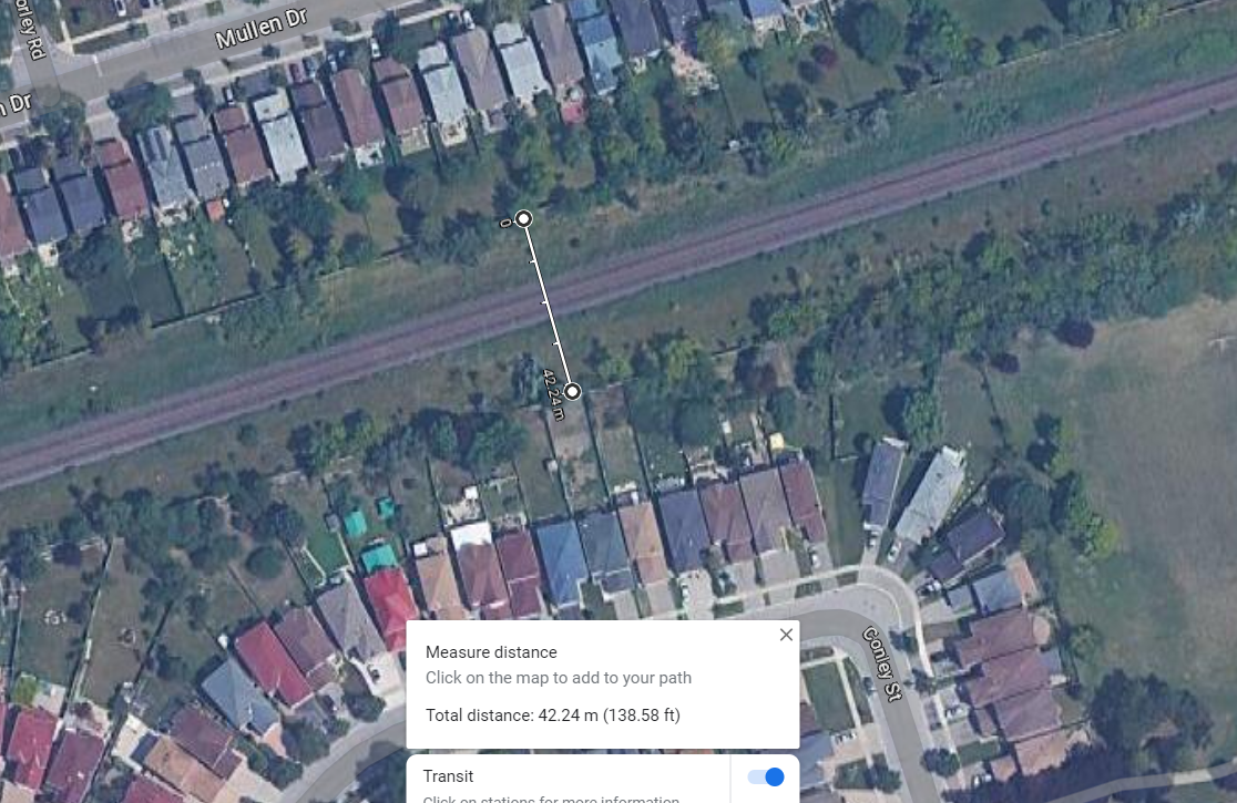

Curious if this rail corridor has ever been discussed/used in a proposal for a North Toronto Crosstown line. It shadows Steeles Avenue for its entire routing through the city (or should I say above the city) and the rail corridor itself is very wide. It is currently used only for freight and is apart of the York/Halton rail subdivision. However, due to the wide corridor, the installation of additional trackage for transit would be possible without the interruption of freight traffic.
If anybody is interested I can elaborate on ideas I had about rolling stock/connection to TTC and GO/direct service for York U and Markham downtown.
Thats the corridor that gives any hope of getting freight out of Brampton and potentially off Milton. It also amounts to such a close parallel to the 407 that there’s no real advantage to it over just building new, doubly so when one considers that the ONLY way this could ever become a passenger corridor would be a new build freight corridor further north at much higher cost than a new passenger line.
With that said, I have wondered about how much additional cost a mainline passenger line parallel to the 407 (designed for full size EMUs) would have compared to OL like light metro tech.
From what I can tell, even at the corridors narrowest portions (this is northwest of Bathurst and Steeles) there appears to be enough to space to upgrade the line from 2 tracks to up to 6. The existing freight route would simply be shifted to the north or southside of the corridor and they could continue operations unhindered. Freight and passenger rail operations have immense precedent in the GTA and across the world, i really don't see why this very wide rail corridor would be the exception to that.
And I am not sure that the proximity to the 407 is a negative? Yes the 407 transitway is in the works, but if it does finally get built, it will be as a busway which has drastically lower capacity, ride quality, ease of station construction, walkability to stations and does not allow for interlining with existing GO corridors.
Frankly I’m not convinced there’s much difference in walkability (especially given proximity to existing and planned stations on other corridors), but bear in mind that six tracks would be 2 CN, 2 CP and 2 passenger. my strategic position would be that given a choice between adding passengers and moving CP freight to North Toronto, CP is more important. At the same time I strongly suspect it will be much easier to get the railroads to agree to corridor sharing if GO is in their corridor, and the door is left open for final configuration of parallel three track corridors for each freight company.
