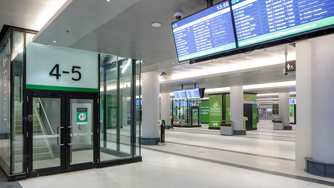

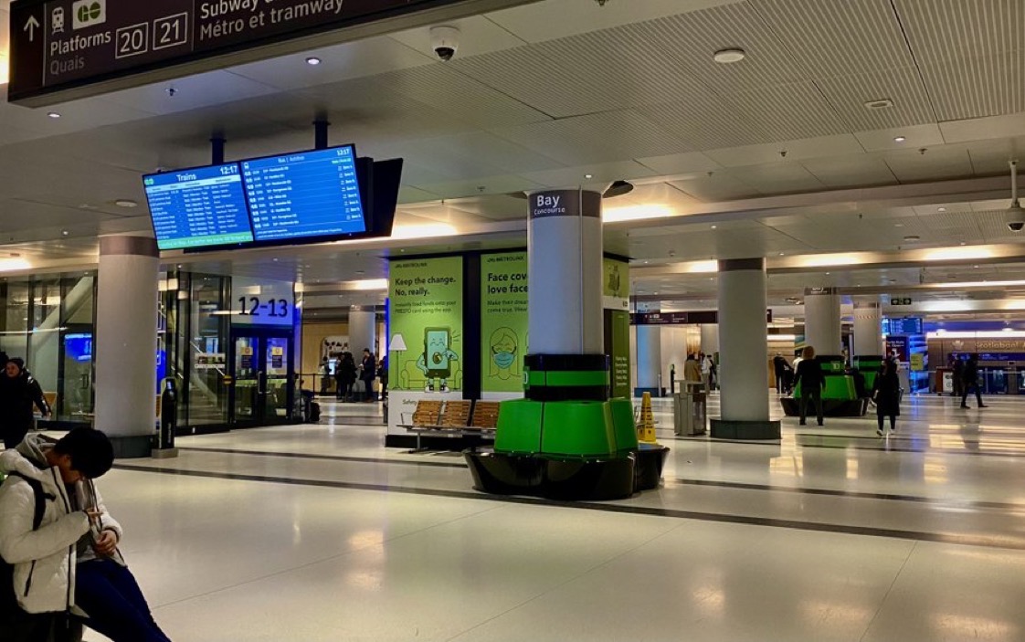

I don’t mind warmer lighting, in fact I hate extremely white/blue lights (especially headlights), I’m sure the Metrolinx promo image looked warmer before they edited it. I was focusing on the fact that more than half the lights are out only 2 years after opening

The Bay Concourse has gotten extremely dark as of last week, I even asked GO’s Twitter and I got back the response that it’s “completely normal and not out of the ordinary”, why are half the lights off now? First image is when the Bay Concourse opened and the second one is from last week:
View attachment 463693View attachment 463695
And it’s just that some of the lights were burnt out either, it’s all over the concourse.
A tidbit of info. When the designs for the Bay Concourse was first introduced, this was back in 2010 and included the lighting that is now outdated. The contractor had to adhere and install what the approved lighting was back in the day under their obligation, which is now obsolete. Any change or deviation would have increased the price of the total build which was already over budget and now the lighting is failing with not enough parts to repair them.
Yes, currently CFL lighting with ballasts that are failing at a high rate. Now to change that over to LED is not as simple as a plug and play. The BAS system controls not just the Bay Concourse, but also the retail level and the BoH areas as well.
