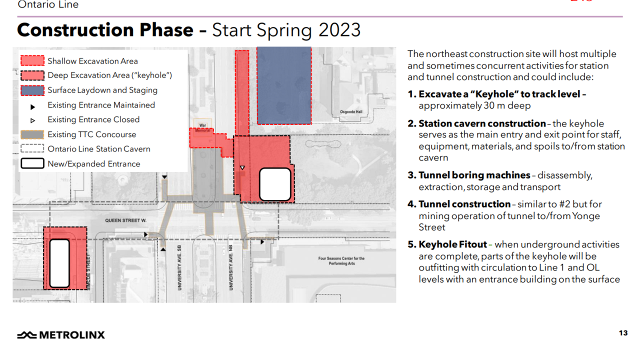

Went through these earlier and just thought on option E and F. Could they not close down simcoe between Richmond and queen for the lay down area? And possibly for the key hole?

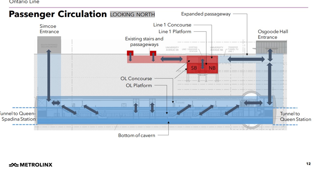

im also a fan of the cut and cover on queen, to make better circulation in regards to the Line1 and ontario line platforms. The biggest mistake in my opinion is not having a direct connection between line 1 and the Simcoe entrance. The reason i think metrolinx doesn't mention the cut and cover method is because it would require the queen streetcar diversion to be extended to Spadina. The current diversion via York would not work, and that would require a complete reengineering of the station. Honestly worth it in my opinion but the consordium would probably request a new contract be issued as the delay would be singnificant.What I find interesting is that the LSO did not propose, and seemingly neither did Mx at any point, the option of cut-and-cover on Queen, which my source mooted as an alternative worth considering.

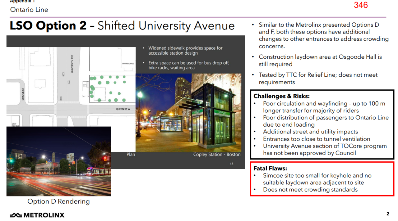

Though of the course, as noted, the drawback is that it works best if you end up putting the headhouse in the Queen St. ROW which definitely requires a permanent closure to cars of that section of Queen.
In the open-cut concept, it is also possible to put the headhouse in the University Avenue ROW, but the vertical circulation is a tad more roundabout.

Seems like a no-brainer. There is almost nothing that would make the downtown core better than closing that part of Queen to cars. It would easily pay off in tourist dollars in a pretty short time frame.I'd be willing to choose a different option, if the costs, in both time and money were entirely unreasonable (in the cut and cover Queen option); but I would like to see the option discussed so that we can all weigh in on the trade offs.
