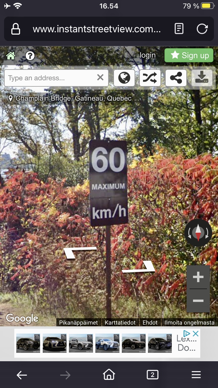

This signal is at the end of the bridge, so are these "Federal" signals? Like these are weird "Federal" speed limit signs:

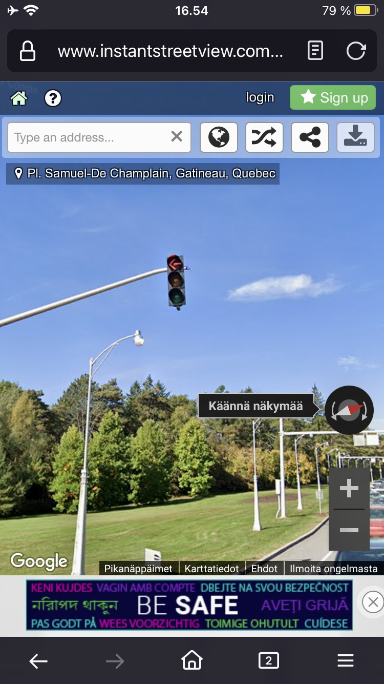

I swear I've seen a red left arrow in Calgary, but accompanied by a red ball.

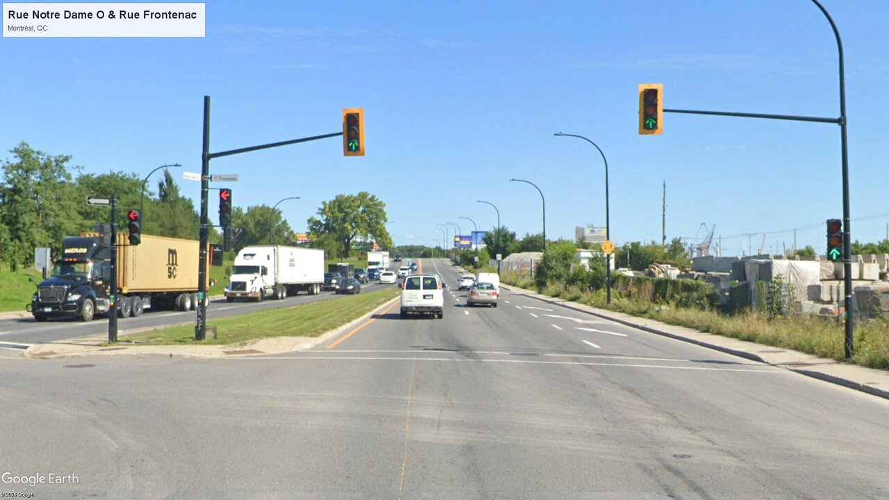

Ontario is the only province that explicitly forbids red arrows. There are numerous red arrows in other provinces, mostly in Québec and Alberta.
Montréal QC has lots of red arrows. For example at Rue Notre Dame & Rue Frontenac

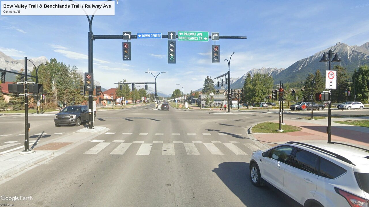

Canmore AB has at least one intersection with red arrows: Bow Valley Trail & Railway Ave / Benchlands Trail

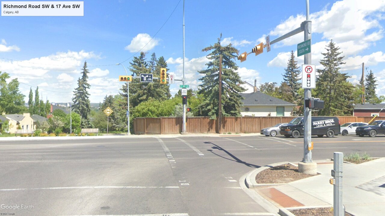

Calgary AB does indeed use red arrows as well. Like you said, they use them in combination with a red ball to indicate "no turn on red". Here's an example at Richmond Road & 17th Ave. I couldn't find a Streetview image with the red arrow but you can see it on the sign.
That intersection is in Gatineau QC, not Ottawa ON. The intersection on the Ontario end of the bridge has red balls instead of red arrows.
The typical interpretation has been that the ON HTA doesn't apply on federal roadways, including all National Capital Commission roadways (including but not limited to interprovincial bridges). This is why the NCC installs federal black speed limit signs instead of Ontario / Québec standard signs.
I personally don't understand why federal ownership would exempt a roadway from the HTA but if that is in fact the case, then red arrows could be installed on any NCC roadway, not just those in Québec. The signals on the Ontario end of the bridge seem to be following the City of Ottawa's standards, which are based around the HTA, which is probably just for consistency with other signals in Ottawa.

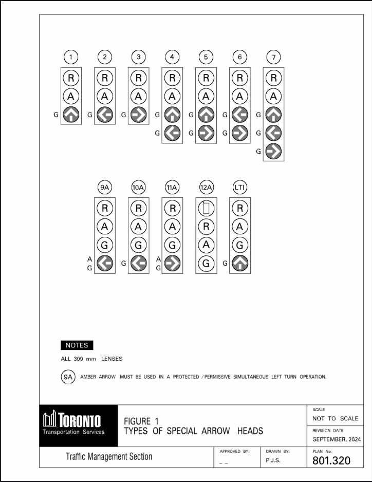

It's kind of like a screw you to motorists, buses, and trucks since all the signals were replaced. Toronto allows for "Ottawa" LTIs:

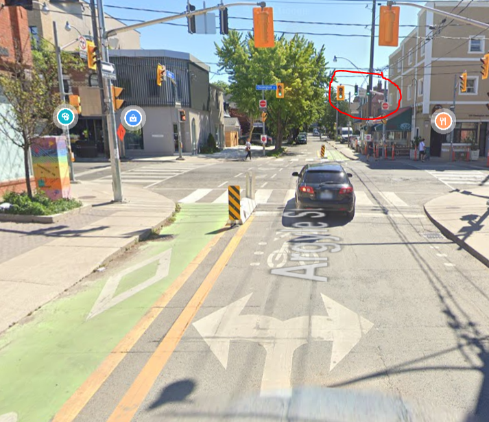

If you want to talk about completely pointless bike signals, take a look at any of the intersections where bikes have a dedicated signal even though they share a lane with motor traffic, and the bike signal must therefore always display the same indication as the main vehicle signals (i.e. no LBI).
For example at Argyle & Ossington:
