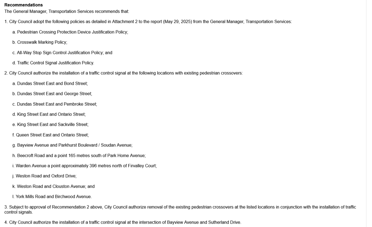

What's it getting as part of the latest Vision Zero Report to next week's Infrastructure and Environment Ctte? You guessed it..........13 more sets of traffic lights.........including an absurd number in downtown.

These are all 'upgrades' from the push-button pedestrian crossovers to 'real' traffic lights. I think this is a VERY good idea as the ped X-overs are really VERY dangerous as it is not clear to anyone I know exactly when one can cross. I do think the City has too many traffic lights but converting Ped X-overs to lights really does not add to the count.
If the protected pedestrian crossing were otherwise necessary, then I would agree that its better to deliver it as a traffic light, than a PxO.
However, I think many of these simply aren't necessary and/or could be made unnecessary by narrowing traffic lanes, removing traffic lanes, removing parking/improving sightlines, re-timing existing signals (to create intentional gaps in traffic during which someone could cross) and by measures which curtail excess vehicle speed.
I'm not convinced (as a whole) that we need 13 more lights. Could we agree to remove 13 existing ones that should never have been put in and move some to preferable locations?

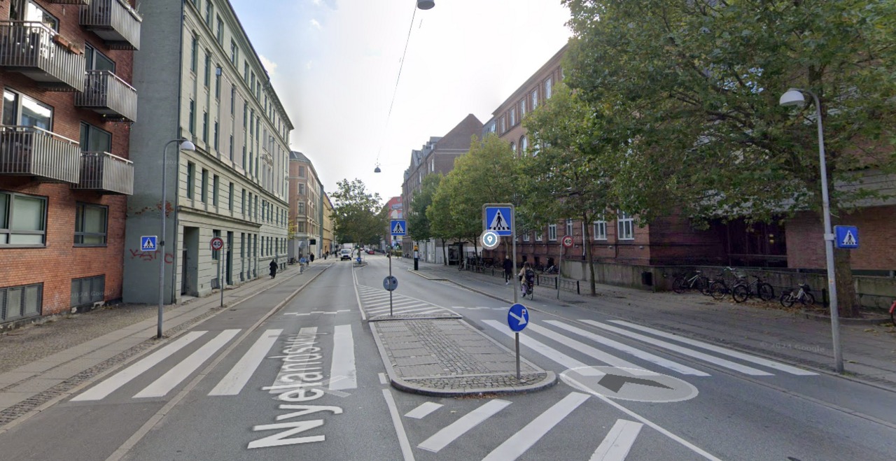

In Europe, they use "pedestrian refugee islands" (with presence or beg buttons), instead of misnamed "safety islands" (don't even have "beg buttons" for pedestrians who get caught on them). The crosswalk at such intersections are not at the corner, but are set back away from the corner, about the length of an automobile. With the signal lights on the nearside, not the farside. (Been mentioned before, but the "search" in UT is not good.)
