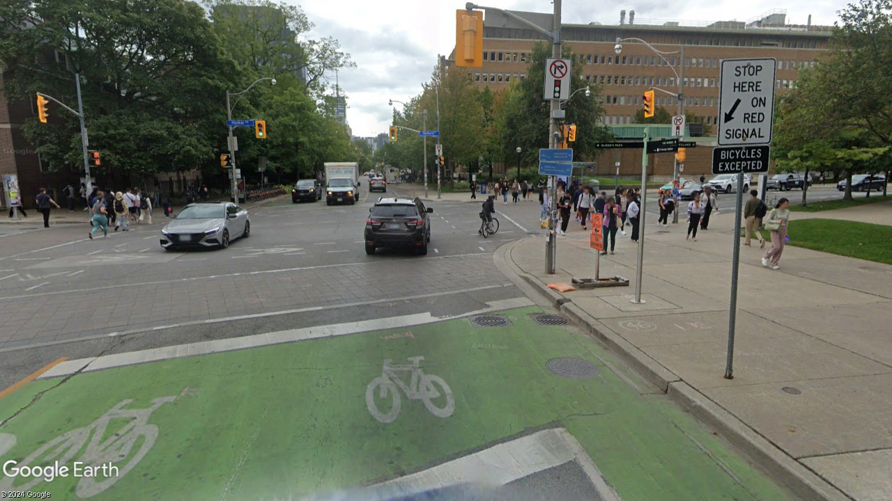

Which reminds me of another problem: When they put in a bike box, they (correctly) install No Right Turn on Red signs, but they often forget to add "Bicycles Excepted" tabs. So apparently bikes aren't allowed to turn right on red from a bike lane to another bike lane because there might be *checks notes* other bikes in the way ??? Other bikes waiting at the same stop line???
St George & Harbord (a location with lots of bicycle right turns):
After seeing a number of these nonsensical regulations, one's willingness to obey signals and signage is severely eroded.
I encounter even more nonsensical regulations while cycling than while driving.

Which reminds me of another problem: When they put in a bike box, they (correctly) install No Right Turn on Red signs, but they often forget to add "Bicycles Excepted" tabs. There's no need for bikes to have that restriction - they just have a normal stop line, unlike cars.
Oh, as a cyclist, I would ignore that sign too. I was referring to car drivers (I see how my comment was unclear). The purpose of this no right on red was to prevent conflicts with a double left turn lane turning into the same lanes.
Yeah I ignore it too when cycling, but it's problematic that our roadway designs/operations are training people to disregard traffic laws.

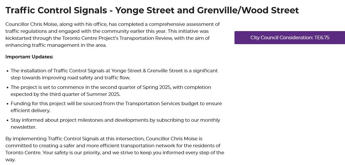

Not sure if this is the right place, but I’ve noticed there’s been work happening at the Yonge street intersections just north of College. Today when I walked by Yonge and Wood it looked like possibly traffic light or light post bases had been installed. Does anyone know if they putting traffic lights there?
Thanks so much! This intersection is always a bit of a mess so hopefully this will help!
Tell the truth, I'm not a fan of more traffic lights in an area w/them so close together. but the current Premier wouldn't like my preferred solution which would be to cut Yonge to one lane each way with cycle tracks and wider sidewalks, making car movements far more predictable.
I would also narrow Wood Street which is a whopping 14M curb to curb at Yonge, that's wide enough for a 4-lane road........that's just silly. Slash it in 1/2 to 7M.
Finally, I would put in a pedestrian refuge island on Yonge designed to block any through movement by cars from Wood to Grenville and vice versa, and to make both streets right-in, right-out at Yonge.
There, much better, no new lights required.
