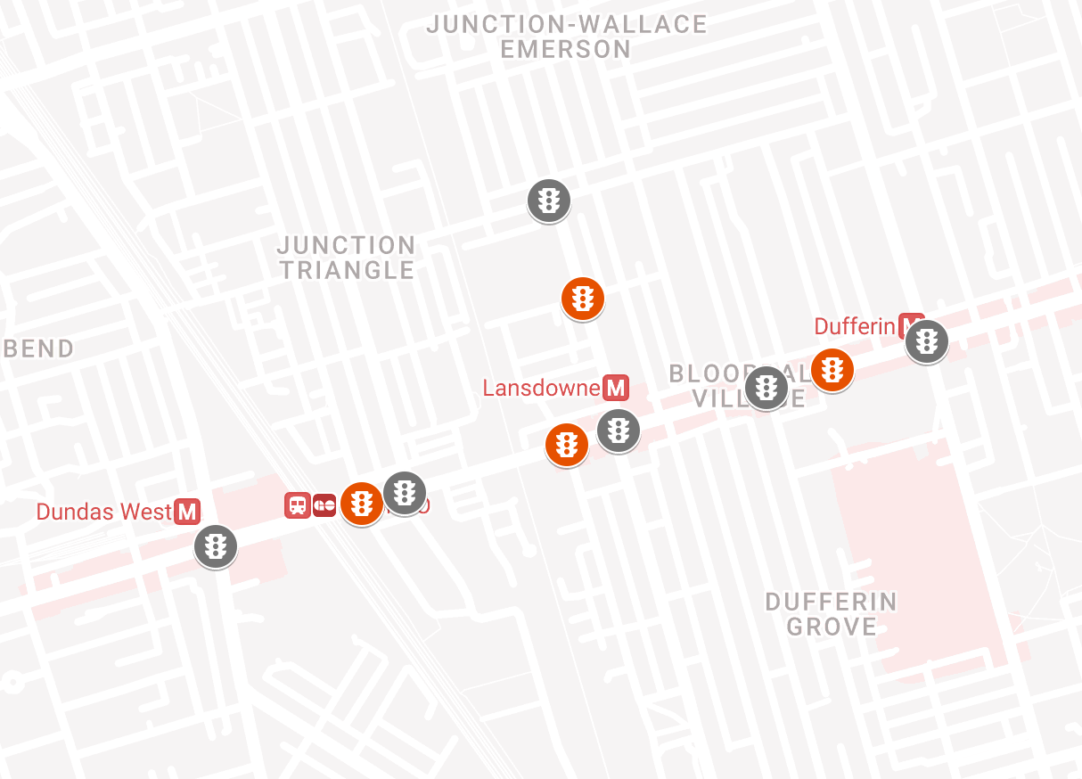

I know we have some traffic signal skeptics in this thread so I was curious to hear everyone's take on the city's plans in my neighbourhood.
I put together this map showing the existing (grey) and approved (red) traffic signals in my neighbourhood.
  • Bloor and Perth, approved based on a request from the former councillor
  • Bloor and St Helens, approved as part of the section 37 agreement for 1319 Bloor
  • Bloor and Pauline, approved as part of the Bloor and Dufferin redevelopment, replacing an existing PXO
  • Lansdowne and Paton, apparently required as part of the site plan approval for 640 Lansdowne (see "Traffic Operations Assessment"), replacing an existing PXO
This seems like a lot of new traffic lights. Too many? What could we be doing here instead of adding traffic lights at every other intersection?

I wasn't able to dig up the documentation for Bloor/Perth or Bloor/St Helens. But for Lansdowne/Paton and Bloor/Pauline, neither met the warrant criteria but both were recommended by staff regardless.

I'm inclined to think that the Bloor/Pauline signal is justified based on the reasoning in the staff report, but I would have liked to see a bit more analysis for Lansdowne/Paton.
I have no horse in this race, mostly just thought it was curious how many signals were proposed in a fairly small area and was hoping to learn from people with more knowledge on the subject.

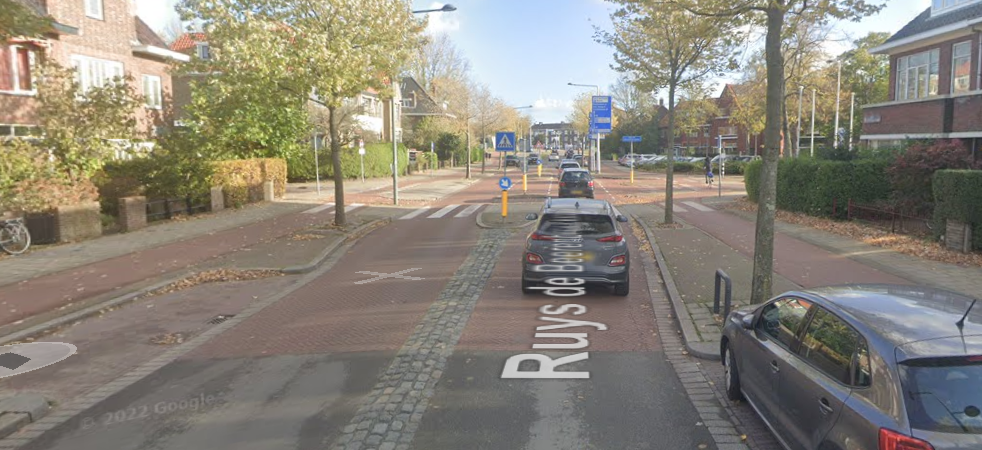

The safer alternative to traffic signals used along collector and minor arterial roads (1 motor traffic lane per direction) typically used in the Netherlands is to install a median, so pedestrians only need to cross one lane at a time. This median also reinforces the lane shift before the intersection, further slowing traffic down compared to the current painted lane shift around the left turn lane. If pedestrian priority is desired, a pedestrian crossover ('zebrapad') is installed, ideally with a raised crossing to further slow motor traffic at the conflict point.
Example from the Netherlands: Ruys de Beerenbrouckstraat, Delft, South Holland. This example does not have a raised table for the pedestrian crossover, but the surface does change to bricks through the intersection. This street has a 19.5m ROW, which is 1 metre narrower than Bloor West. It has parking on both sides of the street, whereas on Bloor West there is only parking on one side to enable wider sidewalks.
Helpful example! Thanks.
