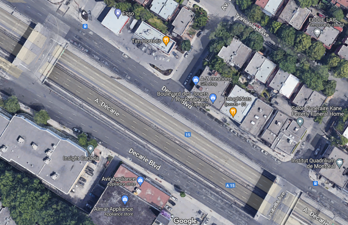

I wouldn't be opposed to a sunken freeway east of Jarvis. Something like A15 in Montreal and the 401 ext. in Windsor. It could be only two lanes in each direction below grade straddled by another 2-3 one way Lakeshore lanes on each side. Parts of it can decked either initially or later on if it is cost prohibitive. All cross streets would not be impeded and could cross directly over the sunken freeway. Once it reaches the Don, it can rise back up to the surface and cross it with Lakeshore, kinda like how Lakeshore crosses the Humber. There would be very little to no enterance or exit ramps.
A smaller scale version of this:
Edit: I think this is more pedestrian friendly than a boulevard.
I can imagine some issues with drainage if the freeway is sunken like this. You'd need pumps to raise the water and dump it into the lake. If you're going sunken freeway, you may as well just do a cut-and-cover project similar to subway projects that don't use a tunnel boring machine. Also going from elevated to sunken would make for a huge time-frame for construction, not to mention cost. The disruption to traffic while this transformation is underway could take several years.

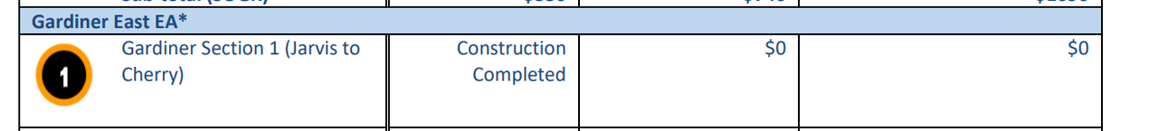

This on Infrastructure Agenda gives some 'interesting' facts and background. https://www.toronto.ca/legdocs/mmis/2023/ie/comm/communicationfile-166270.pdf
One thing being that the Jarvis to Cherry section is 'completed". Though the top surface was certainly completed and was a huge cost, for reasons I cannot understand, they did NOT repair the bents in that section and some of them need concrete 'rehabilitation". Not as expensive as the road surface but hardly $0.
Those are future spending values.
Since it is complete, there is no future spending.
@DSC knows that.
What he's asserting is that the project is not in fact complete, as there is outstanding work to do on the bents (supporting concrete columns) should this section remain (not be demolished); that that work has not been accounted for, which skews the relative costs of the hybrid option vs the boulevard one. Whether or not that shift is material; or enough to change any votes, its fair to say that the figures as presented could be read as misleading.
True. Misinterpreted their comment.
So those columns imply: That spending is not currently funded, and that work will not be completed by 2032.
