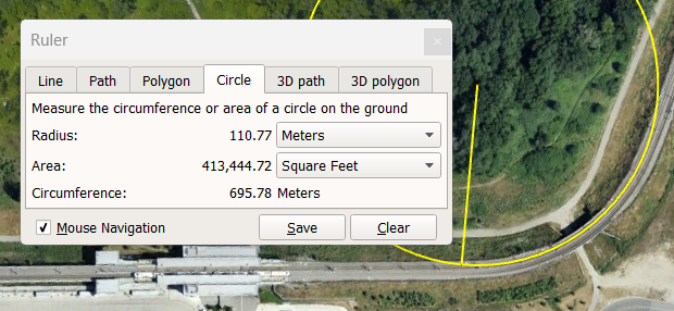

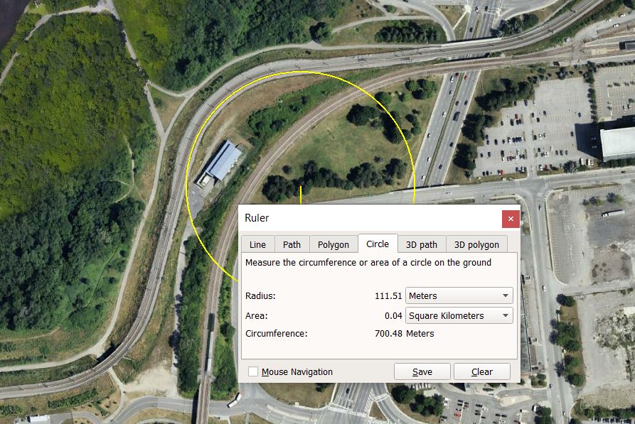

Here is an image from Google Earth with the circle measuring tool of the tightest curve on the revenue portion of the Ottawa line, east of Hurdman.
I'm not sure how Alstom could argue that four times minimum is too tight, or why people keep saying the line might have to be rebuilt.

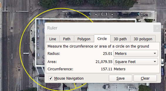

Calgary, at 9th:

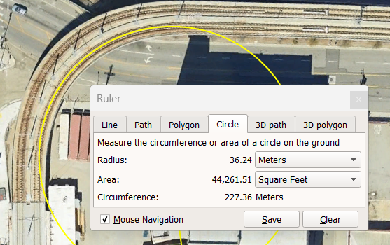

Los Angeles, near Union Station:

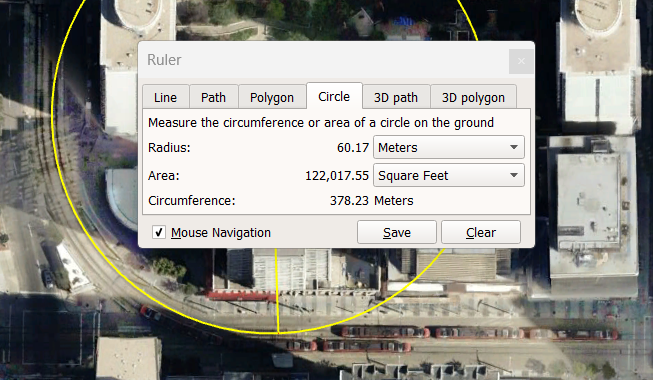

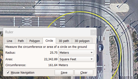

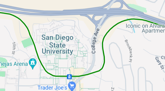

San Diego, near Amtrak Depot. Love this one, all those impossible curves. Designed on a Spirograph?
I put together a collection of "tightest curves" on modern LRT systems I have ridden in the past. It doesn't include networks based on legacy tram and streetcar systems like Toronto, Boston, and San Francisco, which often had much tighter turns.
Calgary, at 9th:

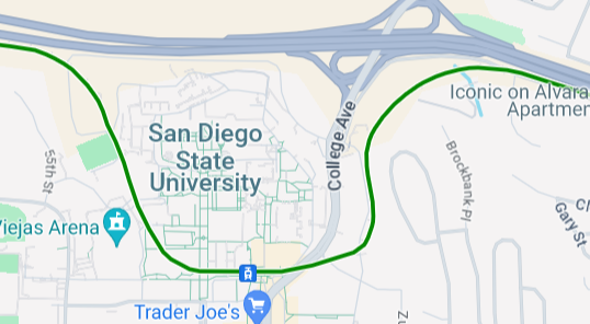

I don't think that they are specifically referring to the curves being too tight per se.
But rather that the curves are too tight for the speeds and type of service that are being asked of them.
Most of the curves that you've mapped out are in urban areas, and frequently as a part of a junction or turning from street-to-street. While there are a couple of areas like that in Ottawa, most of curves on the mainline aren't, and could have been designed to be wider should they had felt the need to. The three curves around Hurdman are a prime example of that.

Those are valid points.
Most of the Hurdman curves are fairly level but the one across the river has a bit of a slope to it, as does the tunnel southeast of Rideau. Maybe the track was not correctly banked in these areas? Dunno.
One of the reasons for opting for light rail in Ottawa was to reuse as much of the existing corridor as possible, which could be done with curves four to five times as wide as the rated minimums for the vehicles. So the route was a reasonable choice, although as stated some of the curves could be flattened out. The VIA curve to the right below is about 235 meters. Does the LRT really have to be built to the same stadard to work correctly?

San Diego (same spot as earlier post):
LA, bigger chunk of the section south of Union:
My argument is that while 25-meter curves are a sort of necessary evil in downtowns in order to follow street grids,* the 110- to 120-meter curves in Ottawa are well within the capabilities of light rail to run at medium speeds. Except it currently doesn't work because of engineering flaws in the vehicles, tracks or both. The companies did not make much profit because the contract was pretty cheap, and now they are pointing the finger of blame at each other and the route, when it seems clear to me that they just didn't work effectively together and/or separately to create a functional, whole system at the technical level.

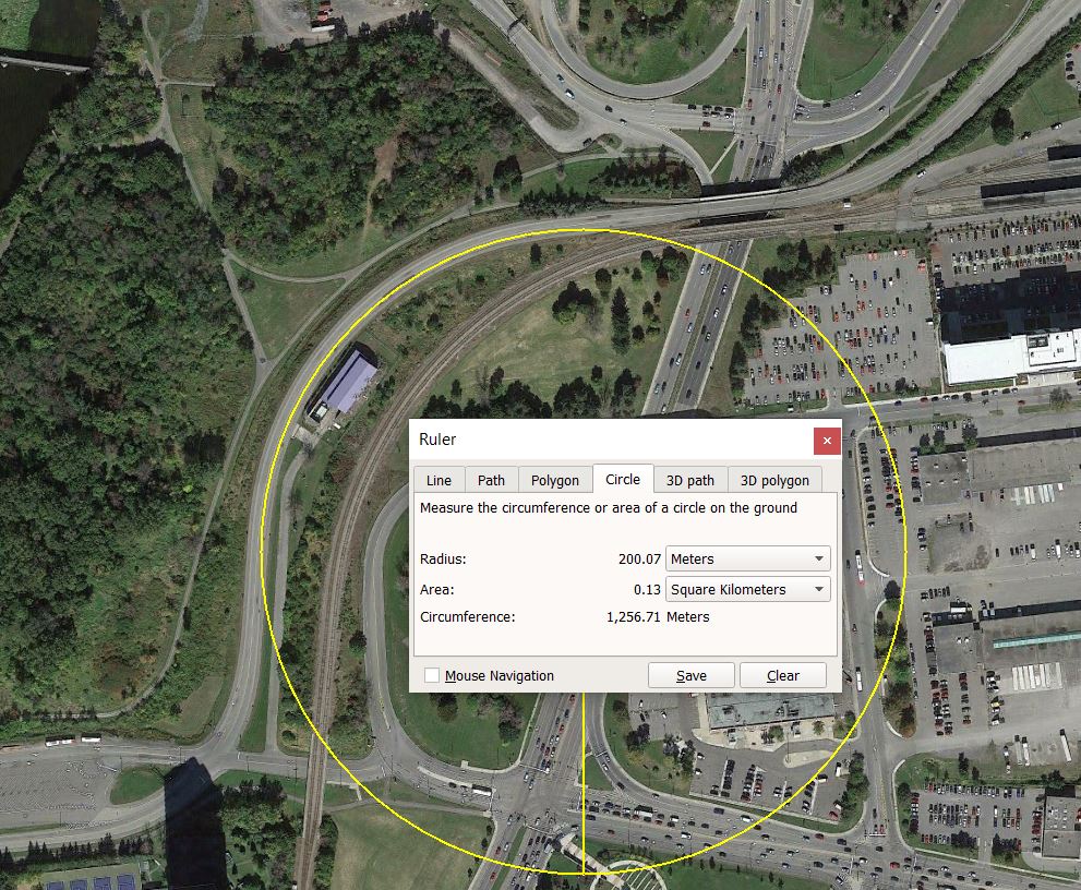

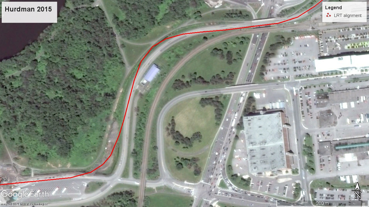

The curve halfway between Hurdman and Tremblay stations (the one that constrains speeds the most since it's furthest from a station) is actually far tighter than the curve on the Transitway was.

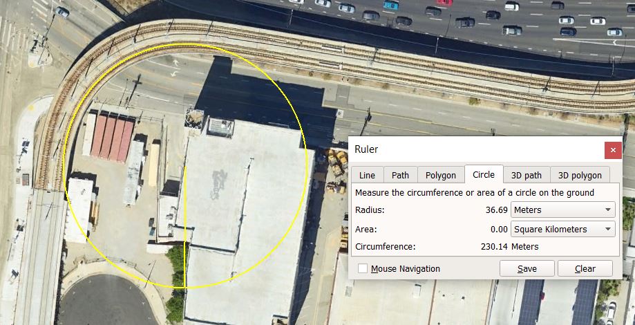

I found a Los Angeles A Line cab ride video where you can see the speed limits in miles per hour on the cab display, so I can report that this 37m curve has a 15 mph (24 km/h) speed limit. That's the same speed as Ottawa's 110m curves.

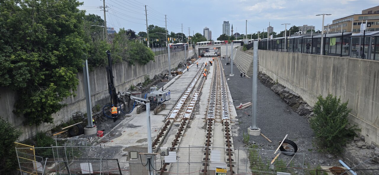

Here's some photos I took of the construction of the western extension from Tunney's Pasture.
