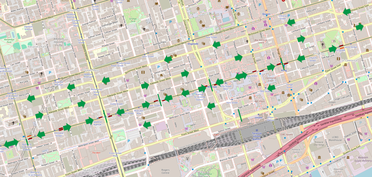

Has anyone else thought about reversing direction on Richmond and Adelaide, and then making one-way pairs of Queen-Richmond and Adelaide-King? Each street could have a reserved streetcar lane with platforms built out from the sidewalk. Hugely expensive and disruptive but worth it?
Yes it has been proposed countless times since the 1950's and it has never made sense because it would undermine the attractiveness of streetcar service by separating the eastbound and westbound stops. It's far more effective for transit to operate on a street where traffic operations are optimised solely for transit (like King Street) rather than having the main transit and motor traffic routes on the same streets which requires the operations to be a compromise for both.
