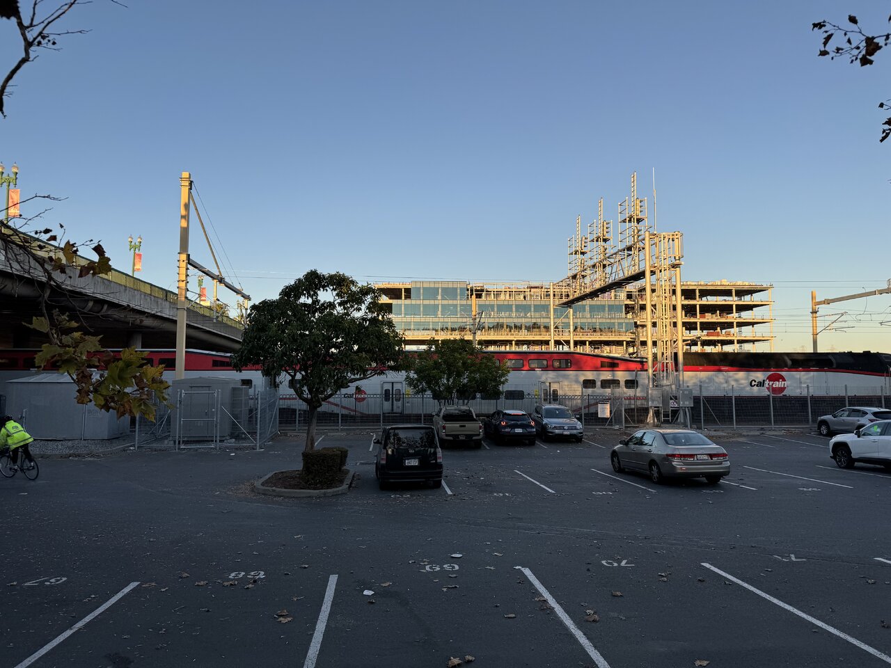

The Caltrain bilevel trains seem very short. I saw one at Millbrae but didn’t get a great picture, as I was rushing to catch my flight, but I’ll just post it anyway. I think they had only 4 coaches. They seemed to accelerate quicker than a GO train.
CalTrain does often run quite short trains. But as a result they also buy lower-power locomotives. They use the MPI MP36 (3600 hp) whereas GO uses the MP40 (4000hp) and MP54 (5400 hp). Nevertheless it's very plausible that a 4-car CalTrain would accelerate faster than a GO train.
This is not one of their EMUs - it is a regular loco-hauled train, using the same BiLevel coaches we use here in Toronto.
Their EMUs are 7-cars long, and you wouldn't have seen one operating in San Francisco yet. Their test track and maintenance facility is down in San Jose. They haven't expanded their testing to any significant lengths of the mainline as yet.
