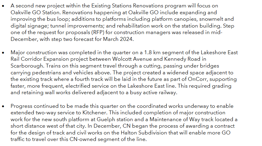

Re CN and the Halton Sub reference in the report noted above, this part of the CEO report (given verbally) at the the Metrolinx board meeting last week might be relevant. Reference to news in the future for the Kitchener Line. Time-marked link here and transcript below.
