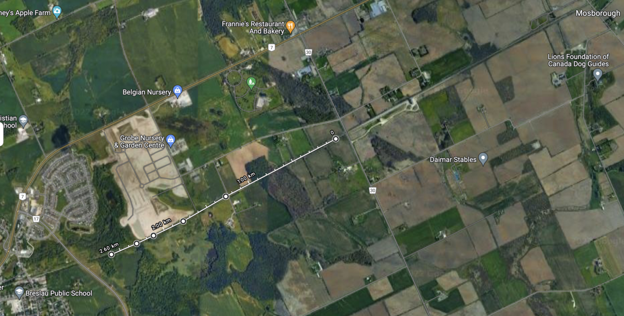

A little quick measuring says that a 2.6 km siding constructed westwards from Shantz Station Road (currently a single track rail bridge) would end just east of Fountain Road.
Fountain Road is built as a double track width road overpass, so the siding could begin further west, over by Woolwich Road, in which case the east end would be somewhat short of Shantz Station Road.
The writeup suggests that this siding will be extended eastwards once the bridge at Shantz Station Road is improved. Streetview tells me that that bridge has support for a second span roughed in. So it's not a huge project to get that done. That would allow the siding - really a stretch of double track, at that length to bypass the P+H grain elevator trackage and gain length in an easterly direction. Logically, the control point for the east end would include both the lead to P+H and the merging of the two main tracks.
