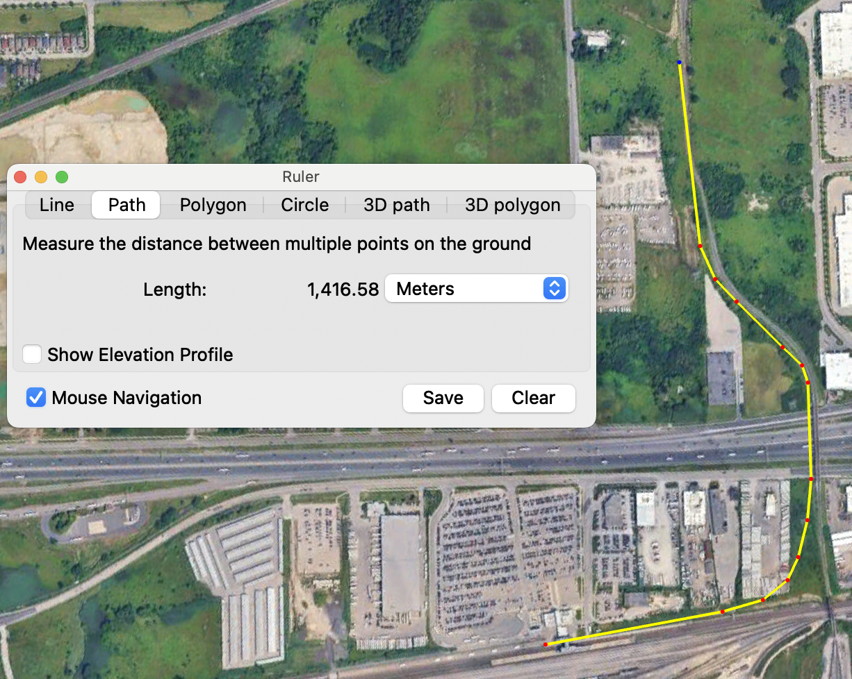

The distance from Oshawa to Thornton Corners is about 1400 metres (which would be by far the closest spacing on the network).

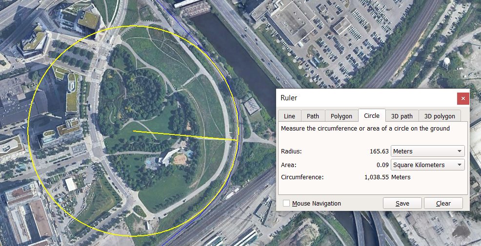

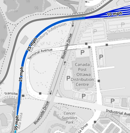

Well according to OpenRailwayMap.org that curve has a 25 mph speed limit (40 km/h). Which actually seems pretty fast for such a tight curve. Are there any Richmond Hill line riders here who could check the actual speed? (Or Transee Pro subscribers)
According to Google Earth, the radius seems to be around 165 metres.
The curve entering Ottawa station is much larger radius
yet its speed limit is also apparently 25 mph (40 km/h).

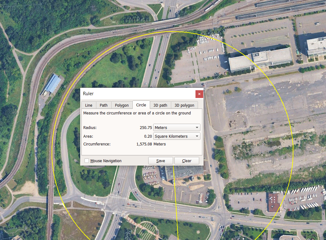

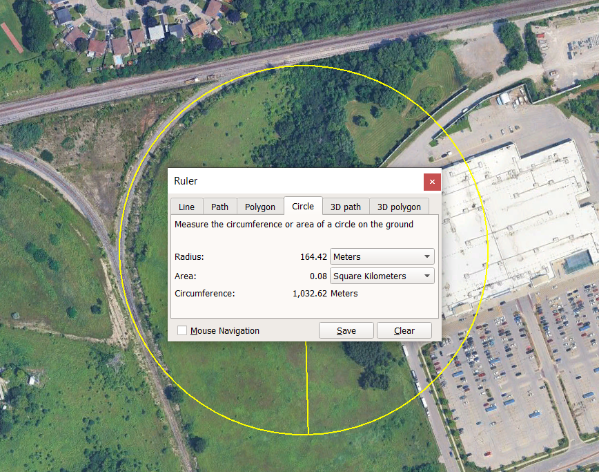

It looks like the radii on the Bowmanville alignment would be about the same as the curve at the bottom of the Don.
