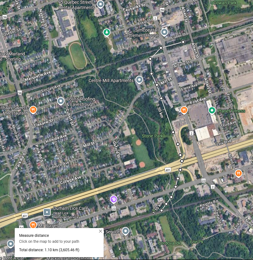

The route that goes diagonal rather than trying to use the auto plant rail bridge alignment was the original alignment. In that design the stop at Oshawa "WTF Durham College" station would not have been part of the GO route instead using a Thickson Corners station. It made sense because it was a more direct route that would allow trains to move at a normal speed. Having two GO stations basically serving opposite sides of the freeway in the same location is nuts. It is literally the same exit on the freeway. There are corridors in airports that take passengers further than 850m. It defies logic.
Let me suggest, on the subject above, @Reecemartin's issue w/the tight curvature.......
He's not wrong..........
But may be overlooking secondary motivations for the alignment.
I would suggest that development opportunity may be a consideration. Its easy to see why. Though, I would argue, that would still be ill considered even if that motivation were primary.
I think a faster line that hits key marks, near redevelopable lands could be found to the west and be at least as interesting if not more so.
To be clear, I don't expect the choice here to be revisited, for better or worse. But I'll throw this out anways:
Justification:
Shorter distance
Gentler curve.
Leaves existing Oshawa GO/VIA station where it is.
Allows for a Station at Simcoe, close to downtown.
Concentrates new development opportunity next to GO Station and Simcoe which is also likely a future higher-order transit corridor.
The routing is slightly sub optimal, but I was seeking to minimize adverse impact o the valley lands.
Justification:
Shorter distance
Gentler curve.
