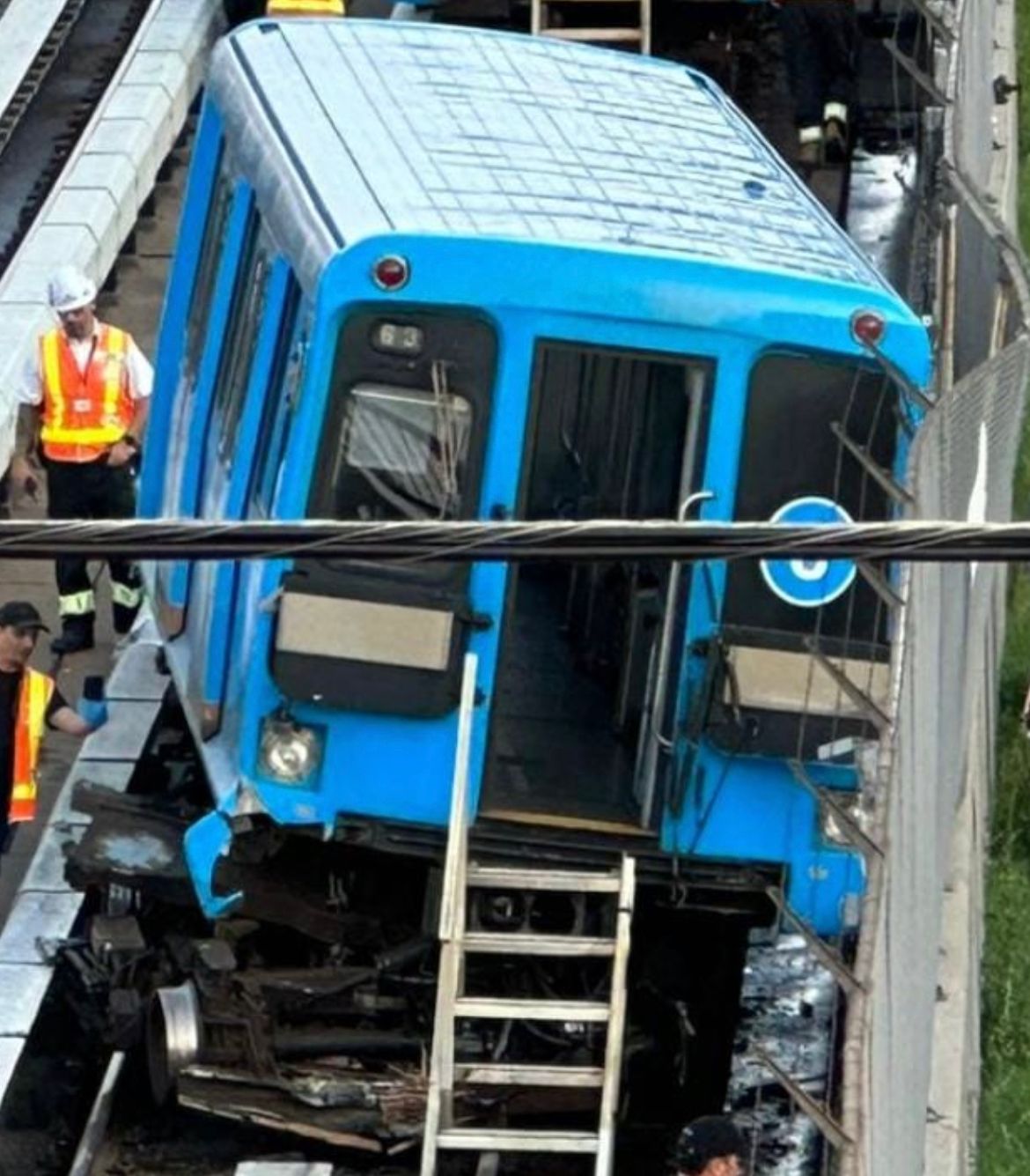

I take the RT regularly and have never had any issues with it, what boggles my mind though is how it derailed on a straight track. The only thing I can think of is some external factor causing this like debris on the tracks.
I could see it derailing in the underpass if it is going full tilt into the turn but on a straight track.. that is odd unless something was on the tracks.

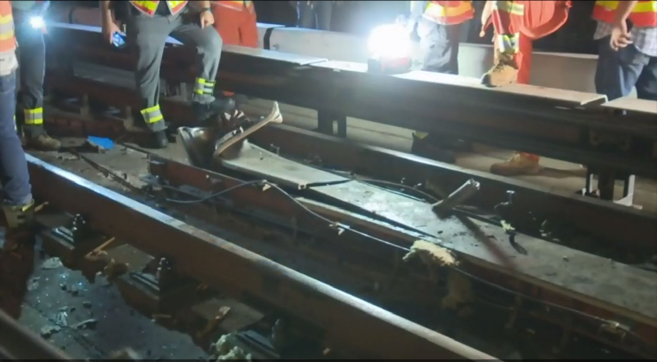

Have you ever ridden on a car that starts to shutter and “jump” the rails after its initial acceleration?
Based on the location of this derailment the train was in its second acceleration phase (it starts out up to 25 till the train is fully out of the station and then begins its 2nd acceleration up to 65 - or 50 if the temperature is above 25celsius) It is in that 2nd acceleration where you will feel the “jumping”. Let’s see what TTC and it’s external auditor says but I can’t see any scenario where the SRT goes back into service. The reaction rail is pretty beat up, and every unit experiences this jumping
The trains have been jerking alot recently. I last took the RT on Sunday and it was jerking around a bit.
I wonder if the trains have been operating on manual recently.
I agree though, I doubt the RT goes back into service. The infrastructure is damaged and I can see it being deemed unsafe.

Judging by the damages to the reaction rail, I suspect there will be a decision if it is worth repairing for only a few months. No doubt that would take at least a few weeks to repair at which point that leaves us with 2 months or so of service left.
If the bean counters do not shut it down, I suspect that the TTC lawyers will. There is a huge liability issue running trains with a known issue such as this. The TTC's lawyers may tell them to shut it down to avoid another incident.
