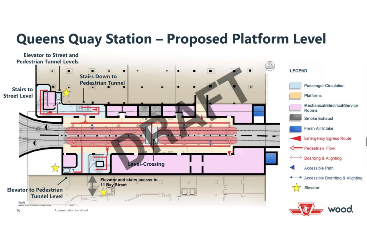

Something new in this revision, there's a level-crossing at QQ station in the middle of the platform. Much more convenient than using the lower level and leads me to wonder why the tunnel would still be providing access to the west side tracks.

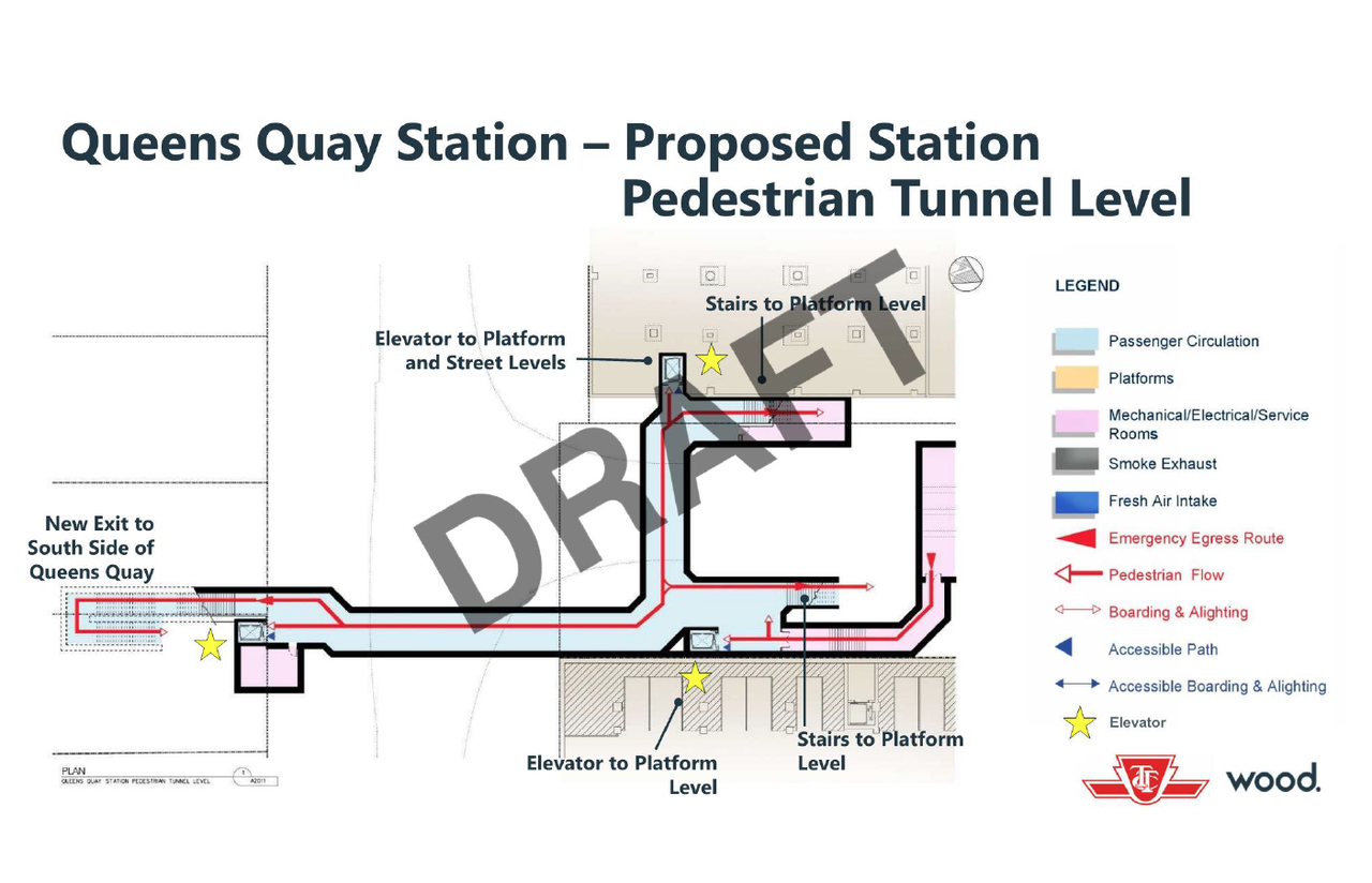

Tunnel continues to the south side of Queen's Quay and the ferry docks.
Reactions: rbt
Yup, I understand why the east side still has a stairwell and elevator to the lower level. My observation was that technically the west side doesn't need one since there is a path from west to east through the level-crossing and the east side stairway and elevator are there. I can think of two reasons for it, one is to provide a redundant elevator to that lower tunnel, and the second is to increase capacity for circulating passengers during busy periods. I wonder if it will survive subsequent revisions if they try to cut costs.

Level crossing... let the cheapening process begin!! Are they going to put in a crosswalk with walk/don't walk lights in the middle of the station? Hopefully having a level crossing in the middle doesn't suggest that they aren't going to be building the station floor up to allow level boarding.
With the cheapening process in progress at Metrolinx, I wonder if we will see level crossings on the Ontario Line considering they are planning on catenary for power and the rails wouldn't be electrified. They should consult with VIA rail on cost reduction solutions like cross the track boarding, plastic movable steps that can be placed at car entrances, single door boarding, etc. Glencoe had a beautiful railway station and VIA moved to what looks like a garden shed. Maybe Metrolinx should look into that... run Ontario Line in the corridor and just put a garden shed in the north end of Bruce Mackey Park where there is a disused platform in the corridor and at the north end of Thackeray St where there is a level walk over to the trains. Use the cross walk technology or whatever they are planning in Queens Quay Station.
