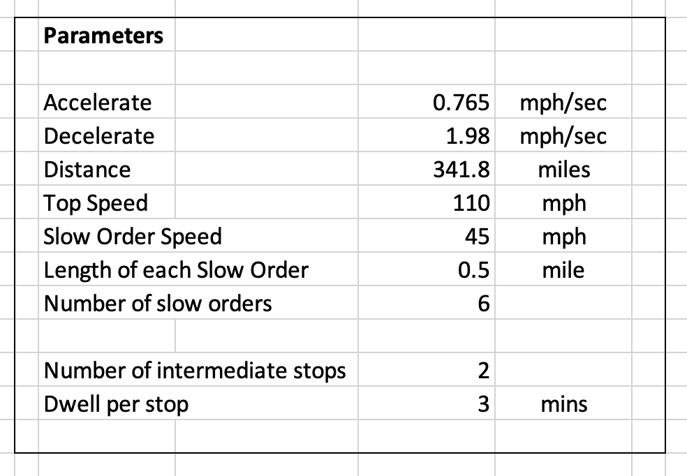

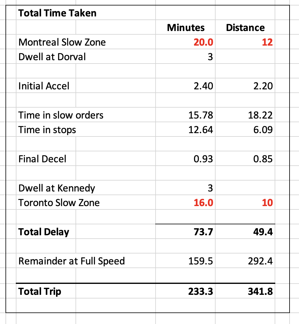

I'm a bit confused. Wouldn't they have 3.5 hrs to get from Toronto to Montreal? You're inferred 4:13 travel time would make for some really crazy departure times. So I wonder if it's 4:13 regularly and the morning and evening expresses use the bypass to get down to 3.5 hrs?
I have no experience on this. But I'm wondering if an express, very limited stop train, using a bypass, can get from Toronto to Montreal in 3.5 hrs? If we assume a design speed of 110 mph, that would require achieving an average of about 80% of design speed. Is that doable if they only have 4 stops en route (Scarborough, Peterborough, Smiths Falls, Dorval)?
