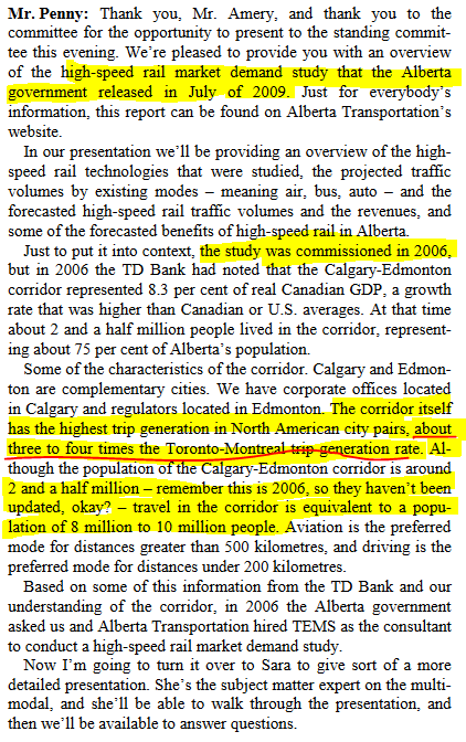

Still private alas. Demand is significant because Calgary and Edmonton aren't near anywhere else. So in Ontario where demand from Toronto is split between Niagara, Detroit, Buffalo, London, Waterloo, Guelph, Sarnia and Windsor, for Calgary, it is really just Edmonton.
Here is committee testimony on it:

This was in 2013. Is it still relevant today? I thought this was all fed into the various studies the Government of Alberta did.
I'll be happy if something like this can happen and I've long maintained that they probably have a case as good as Toronto-Kitchener-London or Ottawa-Montreal or Montreal-Quebec City. But what has me skeptical is that Calgary-Edmonton is longer than all of these making the costs higher and the business cases tighter, even if there is higher traffic.
The land is much better for railroad building tbh (no blasting, gravel available everywhere), and with property ownership and roads being on a grid, you don't need a lot of it even with a brand new corridor. Still relevant, while wounded Calgary and Edmonton still have higher average incomes than all other potential corridors, plus the population is still growing.

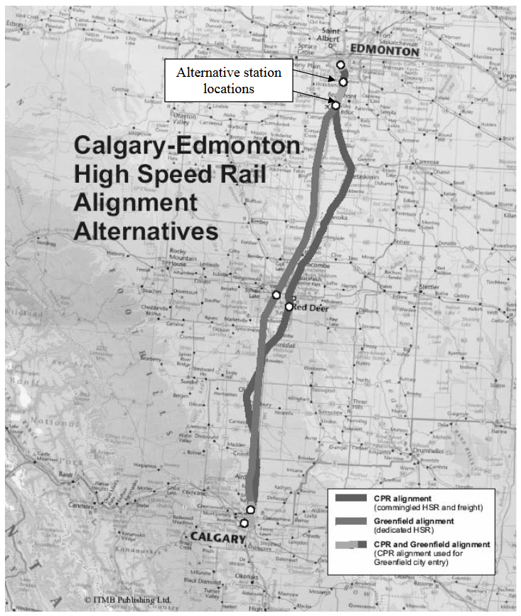

Would doubling the CP track be enough to fit the frequency in?
Yes, with a full rebuild, and lots of high speed crossovers, and some triple sections. CPR figures they can do mixed operations with passenger service up to 200 kph. Costs are around 65% of greenfield.

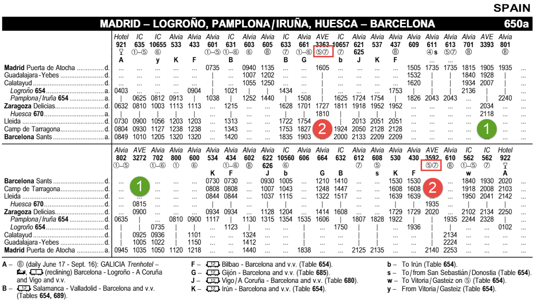

You'd be surprised (I'm quoting from the Winter 2019/20 schedule, i.e. pre-CoVid):
HSR routeSegmentFrequencies (per day and direction)
Barcelona-Perpignan(-Montpellier)Barcelona-Perpignan (177 km, double-tracked)4 (Summer: 7)
Madrid-Zaragoza-BarcelonaZaragoza-Huesca branch (80 km, single-tracked)1-2 (1xdaily + 1xFrSu)
Köln-FrankfurtWiesbaden branch (13 km, double-tracked)2 (no weekend service)
Compiled from: European Rail Timetable (Winter 2019/20 Edition)
Table 13
Table 650a
Table 910
This feels like one of "technically correct...." answers. All those examples are branches or stops. That's very different from discussing frequency on the main line itself (which is what I would think Calgary-Edmonton would be).
It's a bit strange to plan a Calgary-Edmonton HSR line at anything less than hourly. How would they expect to compete with WestJet and AC?
Agreed for Huesca and Wiesbaden, but not for Barcelona-Perpignan, which is a HSR line by itself (only slightly shorter than Montreal-Ottawa or Toronto-London) and used by trains originating in either Madrid or Barcelona and terminating at either Paris, Lyon, Marseilles or Toulouse.
I couldn’t agree more that any HSR line which doesn’t support at least hourly service is a pure commercial failure and it’s not a coincidence that such a low-frequency HSR line exists in Spain of all countries (given what a miserable economic failure HSR in Spain is), but I simply wanted to highlight the existence of HSR lines which are anything but high-frequency...
