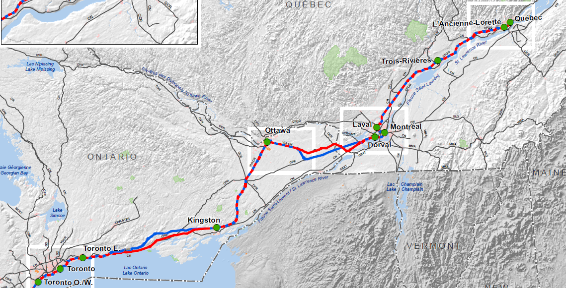

Note: The F-200 alignment is shown in red, whereas the E-300 alignment is shown in blue and a more detailed map can be found in Deliverable 9 (Appendix I) of the Ecotrain Study
Source: Ecotrain Study (Deliverable 5, p.64)
Given that the infrastructure cost premium of E-300 over F-200 is only 18.6% for Quebec-Toronto ($14.04 billion vs. $11.84 billion in 2017 values, see Post #5,002 for these and all other figures mentioned in this paragraph) or 21.6% for Quebec-Toronto ($9.41 billion vs. $7.73 billion), while reducing travel times between Montreal and Toronto for an additional 51 minutes (2:47 vs. 3:38 hours) or 23.4%, there seems indeed to be little reason to settle for a Higher-Speed Rail rather than a High-Speed Rail future. This is even more the case as two-thirds of the cost premium fall on electrification.
Okay, so let's identify the sections where investments will reduce travel times for the current services and remain "most compatible with an HSR future":
Note: ROW sections eventually shared with HSR are highlighted in green, whereas existing and new ROW sections which will not be eventually shared with HSR are shown in yellow and red, respectively.
Compiled with: distances obtained from historic CN/CP timetables or measured with Google Earth and routings obtained from The Globe And Mail (for HFR) and the Ecotrain Study (Deliverable 5).
You can check yourself, but I can only identify 3 segments which meet both criteria:
  1. The Montreal Subdivision from Gare Centrale to Dorval Est (14 km, owned by CN)
  2. The Alexandria/Beachburg/Smith Falls Subdivisions from Casselman West to SmithsFalls North (104 km, owned by VIA)
  3. The Kingston Subdivision from Port Hope West to Toronto Union (94 km, of which: 60 km owned by CN and 34 km owned by Metrolinx)
Combined, these 3 sections account for only 212 km (or 33.5% of the total distance between Montreal, Ottawa and Toronto) and the CN-owned part of the Kingston Subdivision only accounts for 60 km. Even worse, these 60 km omit the nodes (Coteau, Brockville) which are presumably the choke-points of the Kingston Sub, while none of the triple-tracked sections falls into this part which will be hopefully used by HSR one day. I would therefore like to know from you and from @crs1026 how you are planning to reach the frequencies required to justify HSR investments (by demonstrating that the Corridor is commercially viable for InterCity rail) without massively investing into infrastructure which will no longer require these enhancements once the HSR line we are all hoping for will finally open...
