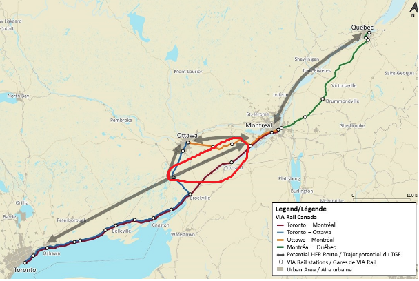

Am I looking into this too much or are they suggesting a route that bypasses Ottawa on the HFR and goes directly to Montreal as well?

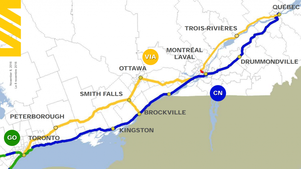

There's an old CPR line running to the east of Ottawa that was turned into a rail-trail years ago. Could be a fever dream I'm misremembering as fact but I could swear I'd read Via was exploring turning it back into active track at some point. Even if that's not true, the corridor does seem a lot straighter than the current route they use. If Via was thinking of having two Corridor services - the northern one essentially express between the biggest cities, the southern more of a milk run - then reactivating that trail might be useful. It's straighter and, by my measurement, a good 15-20km shorter than the existing route.
The old CP M&O Subdivision remains railbanked as a trail - and even has signage reminding recreational users that the line is earmarked for resumption of rail service one day. It is indeed superior to VIA’s current line as a future true HSR line, but the cost of remediating any deficiencies in the current line to reach the standard that HFR requires is apparently far less than it would cost to reactivate the M+O for that purpose. For now, good is good enough. HFR is a 20-year minimum bridge before HSR will be on the table. It will be interesting to see how the relative costs of switching lines (and stranding investment capital) versus incrementally enhancing the current line compare in years ahead. Affordability may override technical superiority..... the M+O may never get the nod.
Im not sure how much you are contributing here or know, but HFR is planning to use an old rail trail and a line through Peterborough, however, the plan has all trains routing to Ottawa first.
See here
That much we know for sure. Is that what you mean? However, on the map I posted above, there is another line going straight from Smiths Falls to Montreal, thats NOT on this map I just posted.
Im wondering if that line is just them saying "the trains will go to Montreal" or they are proposing another branch line that bypasses Ottawa to the south of Ottawa
What ive highlighted is NOT on the previous map I posted which is the previous "official" proposed route map from VIA
See here
I've been here a loooong time but usually lurk (I get way too heated when I comment regularly lol). I'm aware of the overall HFR plans - I just thought the placement of the grey arrows between Ottawa and Montreal seemed interesting because of the route I mentioned. Obviously these are just lines drawn on a map to indicate generally where trains may eventually go but, as crs1026 notes, that route would be ideal compared to the current one. And, from reading the last few posts (including those cryptic comments about "exploring all potential routes" or whatever), I thought that could indicate that Via is showing interest in at least studying a rebuild of that line.

Would there need to any special construction to enable trains to bypass Ottawa via the existing CP mainline? The proposed HFR route map shows the VIA Rail line intersecting the CP mainline at Smith Falls before deviating to the north to reach Ottawa and then rejoining the CP line to the north of Saint-Polycarpe. It seems that express services between Montreal and Toronto would be able to simply stay on the CP mainline rather than entering Ottawa. However, this might not provide time savings if high speed operations are not permitted on the CP mainline.
The HFR proposal doesn't permit high-speed operation.
It is intended, I believe for 100mph/160km/ph maximum speeds.
The CP mainline is likely capable of supporting that in most sections, just as CN's mainline permits this for VIA now in sections.
The real issues are what the current traffic level is like; how adjustable schedules are and how much passing track there is; whether CP is open to a deal.
Though there may well be lower speed limits on portion's the route.
@crs1026 and @smallspy would be the go-to experts on that.
The CP Winchester Sub runs from Smiths Falls to Dorval, a distance of roughly 119 miles. The current VIa route between these points via Ottawa is 154 miles. The CP route is very good quality rail, and could be upgraded to 95 mph without difficulty, although crossing protection would have to be improved throughout (likely not currently calibrated to 95 mph) and the line would have to be resignalled. So in theory it would be a more appealing route to serve the through Toronto-Montreal market than the Ottawa route. The line is not that heavily used - 3-4 trains each way at present. Interestingly, the Ecorail study proposed putting HSR on this routing for part of its route.
The problems are a) CP's current use is irrelevant, its long-term capacity expectation would be what CP would protect and b) as a mixed use line, all the same problems inherent in VIA not having its own right of way would remain.
There have been quotes in the media that VIA has sought a CP routing over part of this line, likely just the De Beaujeu-Dorval portion, which would remove the problems of VIA having a level crossing across CP at De Beaujeu, and to extricate VIA from sharing (unsatisfactorily) the more heavily used CN line from Coteau to Dorval. The media quotes suggested that VIA found CP was not amenable to even this use of their trackage. Asking CP to share the whole length of this line would be a much bigger ask.
I can't see the use-the-whole line idea flying, either from VIA's end or from CP's. The time saved might be lost in conflicts with freight trains, and schedule performance would suffer. And VIA would still need its own parallel line to serve Ottawa.
Of course, if VIA relinquished most of its use of the Kingston Sub, CP would easily fit on CN's line through coproduction. One wonders whether the "studies" under way would extend to that level of option generation.
