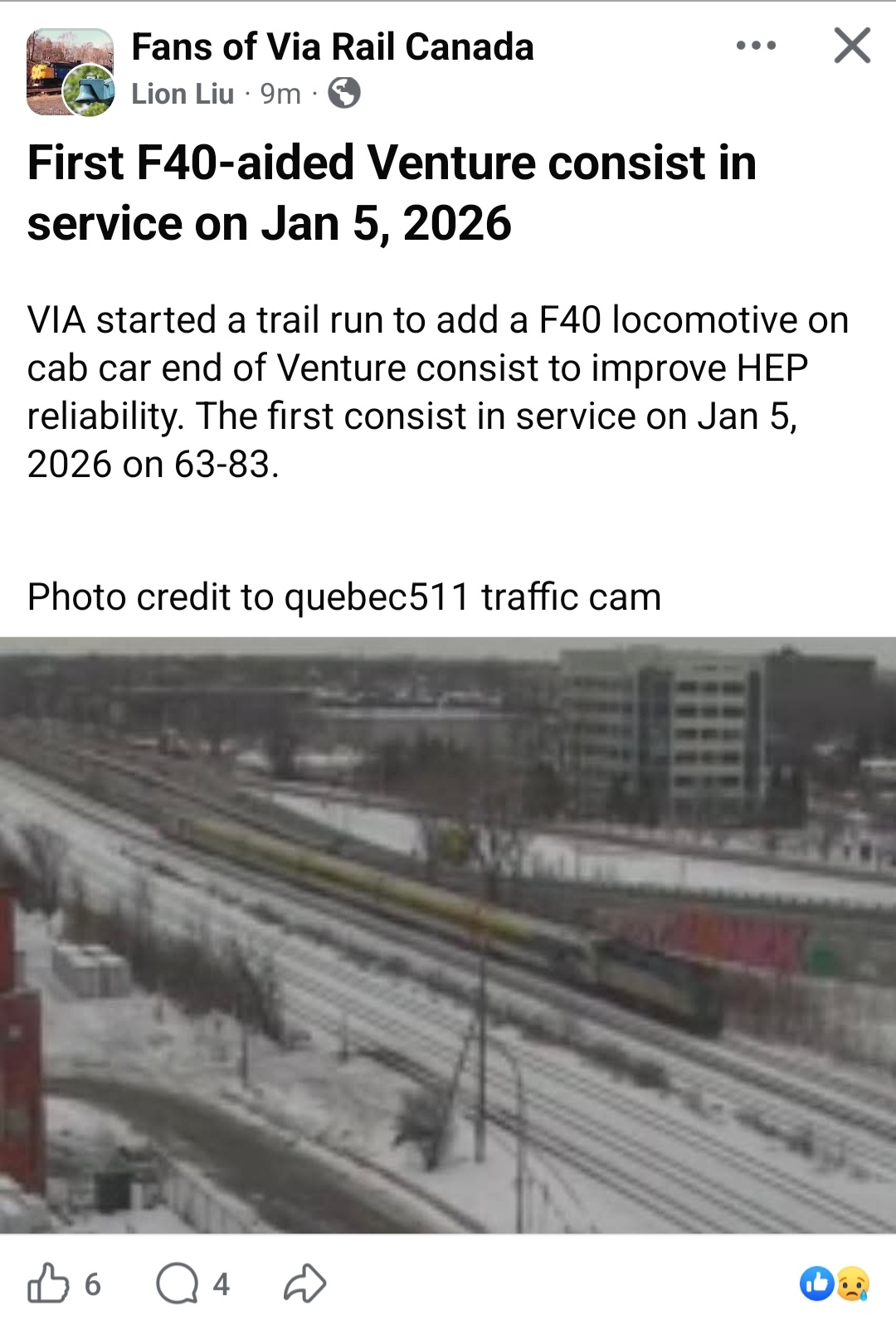

I hope I am wrong reporting this, but...
Due to losses of HEP on seven recent Venture-equipped trains within a week, a new configuration
is the result: VIA will start to add a 6400-series locomotive to the cab-car end of Ventures train set effective tomorrow, January 5.
What type of loco is a 6400? P42, F40 or Charger?
Are the HEP systems compatible? Since they cannot be MU'ed the F40 would need to tow the Siemens set. At least there won't be any shunt issues.
Also not all of the 6400's are able to go backwards at full speed.

That would give different performance characteristics from running locomotive forward, why would they use such a design?
Does anyone have proof that they actually did this?
Are there enough spare f40's do do this?
Also trains will now be limited to 95mph.
This was forwarded to me to post here.

According to groups.io (Lion Liu) the F40 will be dead in tow when at the rear, and was chosen as opposed to P42 due to being lighter.
