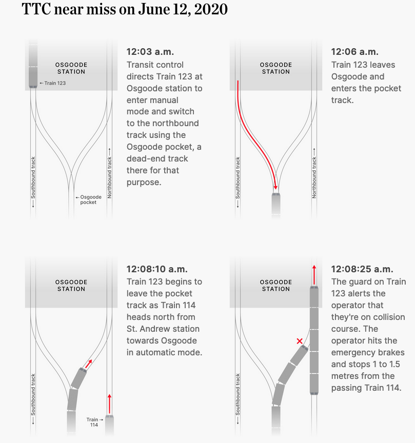

The trains ended up within 1M of each other.............yikes.
I agree w/ @allengeorge above that ATC per se is not likely the issue.
The issue seems to be that the TTC disabled ATC in the pocket track.
I find that very odd.
But I also wonder this......
In the above article it is suggested than there was still a wayside signal in the pocket track, and that it was red.
My recollection is that a train running a red was supposed to trigger its emergency brake.
I'd like to know if that is still how its supposed to work?; if not, why not?; and if so, why didn't it?

The wayside signals are used to guard the entry into the logical "blocks" in a situation where a train is operating outside of the signal system, such as the case here.
However, there are no wayside devices - trip cocks - to physically enforce the stopping of a train. All of that stuff has been moved to onboard the trains - the train is capable of calculating if it needs to apply the emergency brakes, and the signal system is capable of demanding an emergency stop from any individual train.
But that's only if the trains are actually operating within the signal system.
If a train isn't, as is the case here, the system is blind.

The onboard equipment of the train is never fully disabled, and is able to put the train into emergency. This is why all of the work equipment also needs some minimal equipment installed onboard.
But to have the system itself turned off on a section of track? That's a whole different ball of worms. And there's really no easy way for the system as a whole to deal with that now.

The issue isn't manual per se. The system is designed to deal with that. Trains regularly get operated in a manual mode while in the midst of the ATC system all the time.
The issue is with turning the system off entirely. Then, it becomes blind.
Really bad all around. The crew parked the train in the wrong spot (not far enough into the pocket to see the exit signal) and proceeded without authority. The signal system let that happen.
The entire point of the system is to enforce movements of trains, so there needs to be a really good justification as to this oversight.
In this case the actions were intentional, but this could just as easily happen unintentionally. Brakes fail -- if the train rolls and fouls the mainline, the system needs to be aware. In safety engineering, you basically have to assume your users are actively trying to kill themselves.
Even if there was no conflicting train, they would have proceeded into an incorrectly lined switch and possibly derailed.
