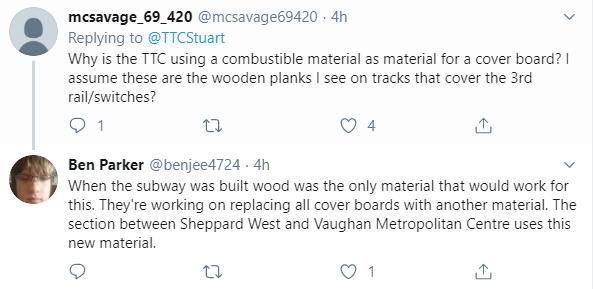

There has got to be better options than wood.
Is it even safe to use wood right by the third rail?
It has been for the past 100+ years, and it will likely continue to do so. Hell, the third rail is carried by wooden ties, and they've never been an issue.
For the record however, the TYSSE was built with engineered fibreglass coverboards. Where they need to be replaced the engineered fibreglass ones are the new standard.
Correct me if I'm wrong (I am not at all an electrical engineer), but wood is a damn fine insulator. Assuming it was in contact with the third rail, the only way I believe it would really be able to catch fire is if water, debris, or metal fasteners were in a close enough proximity to the third rail to cause continuous arcing, leading to a fire.
If I am correct in this assumption, I don't even think fibreglass would have helped much, given that there would have still been a short circuit and, most likely, fire from track debris. Any failure of the third rail cover would have shut down the system regardless since they'd have to cut track power and perform an extensive repair. This all leads to the question of why and how the cover failed to begin with.
