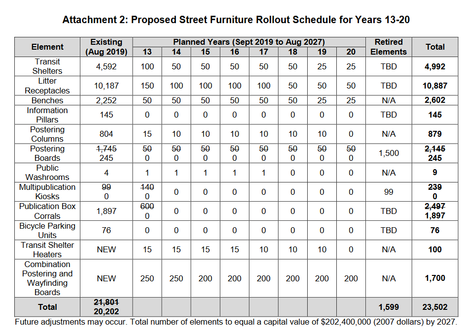

In respect of the coordinated infrastructure program above, as noted by @DSC
The total number of shelters to get heaters is 100 over 7 years with 15 this year. Also of note, for better or worse, more public toilets (5),
The rest of the rollout schedule for various infrastructure elements is listed below from the attachment to the City report.

I thought the toilets had been nixed too. I was surprised to note their return to the program schedule, though there are only 5 showing (we currently have 4)
