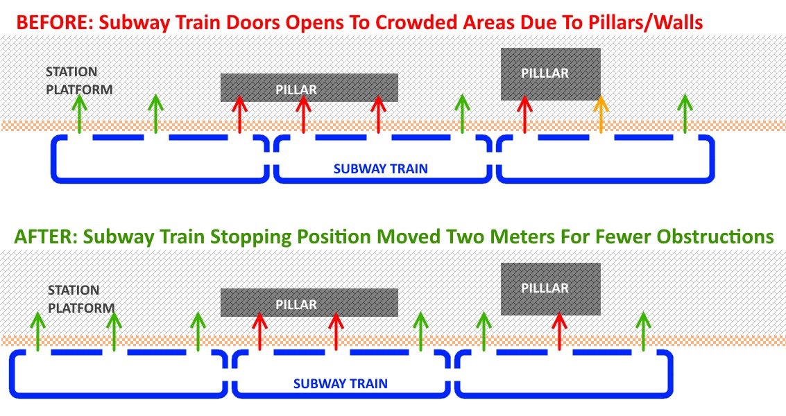

Also here's a generic diagram (non-TTC) that demonstrates train-positioning "Geometry Theory" (three door version). This still even applies to any subway system whose has stations with constricted stopping positions, and any number of doors (2, 3, 4) or coaches, it demonstrate the Geometry 101 concept.
(Above is generic non-TTC diagram, but demonstrates the Geometry 101 concept of stopping-position optimization)
There's a lot of jiggle room (about 5 meters worth). Perhaps the automatic train control system can be precisely adjusted for optimal "fastest-peak-passenger-flow" train stopping position at TTC Union station.
It is amazing how much the train stopping position varies at Union station -- the ATC system can in theory be programmed to aim to stop at a very precise default berth position -- that optimizes for slightly faster commuter flows (disembarkers easily getting around embarkers -- versus constrictions preventing such).
