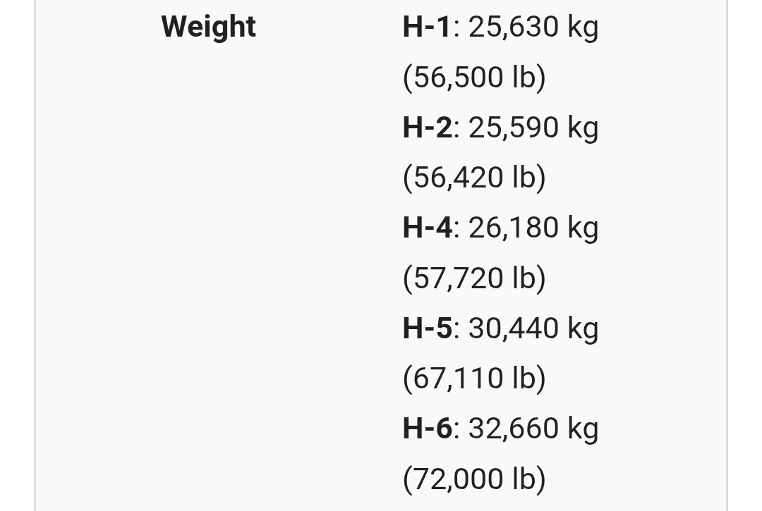

It's only with the H-5 that air conditioning was added to subway cars, which added 10,000 lbs
I wonder how much of the extra weight came from adding the AC vs. the chopper controls. H6s added even more, probably due to force-ventilation of the traction motors.
Interesting side note, in order from heaviest to lightest, it's H6, H5, M1, H4, H1, H2. Lots of unexpected overlapping in this order.
I think you might be slightly misreading the chart, if you're talking the order of weight per car (edit: my chart was wrong, your order is correct), but you bringing that up made me realize I got cumulative rounding errors for PSI, so I'll fix that.
