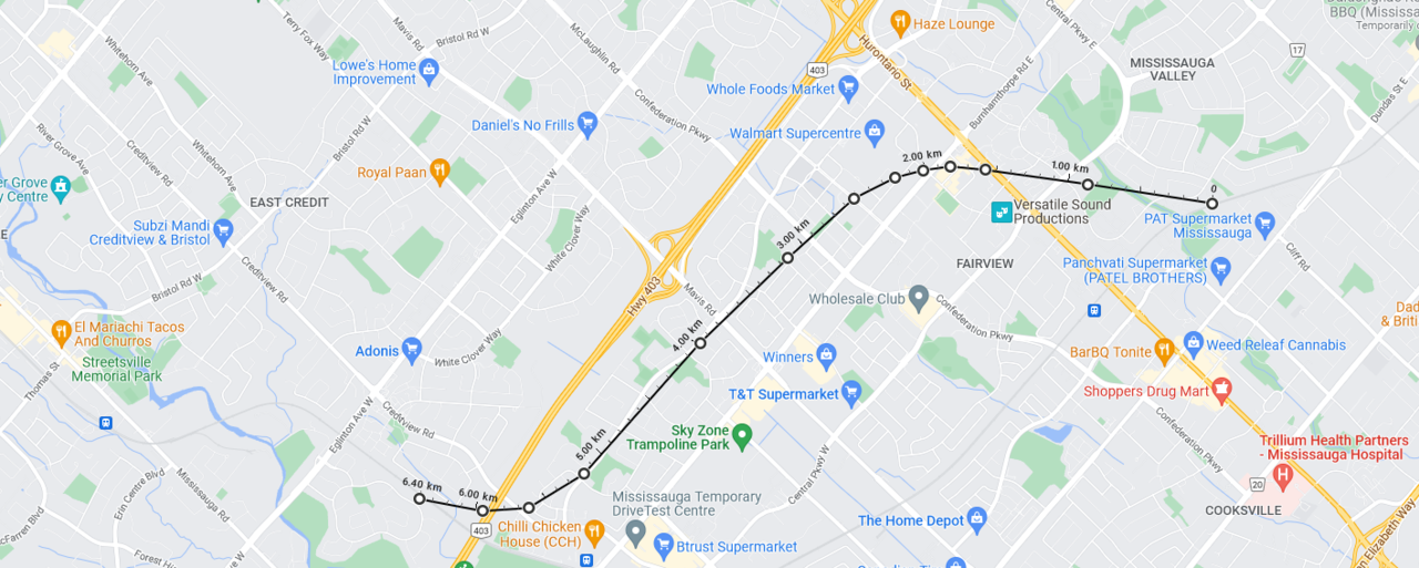

Without advocating for or against, but to contribute here, I mapped out what I believe an MCC tunnel for the Milton GO line would look like in terms of placement and distance.
I would defer to those w/greater expertise than I, in saying I may not have it quite right.
I used only the simple assumptions that:
It must start and end at the existing Milton GO Line (assuming through service)
You want it as straight as possible, with gentle curves.
In the route layout above, I have bypassed Erindale station, one could choose to include that, but it either means a more southerly alignment (right along Burnamthorpe) , or a significant curve to the south at the western extent of the tunnel.

Your suggested route would miss Square One by a good distance. Because of turning radius requirements, it is unlikely the tunnel will go north of Burhamthorpe. Also, it's not a good idea to put a station on a tight curve because you will have huge platform gaps that may need big platform extenders. Or else the station will be place before or after the curve and will be far from Square One in either case.
Northern Light's route has potential to have the station right besides Square One, although his route will go under a lot of homes and that's hard to sell if we go by Yonge subway extension's experience.
