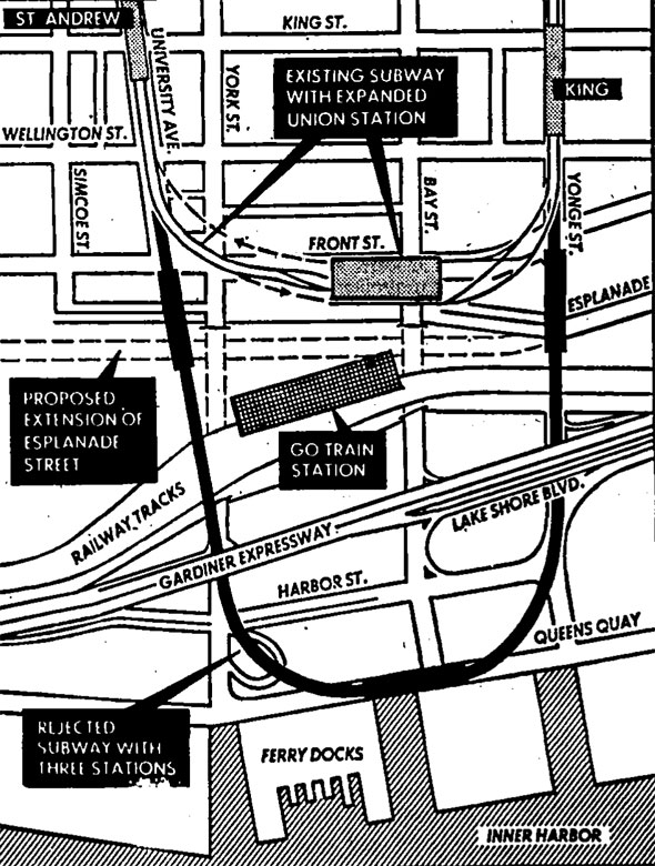

I had proposed something similar way back when, but my proposal had the station box angled on a SW-NE angle, going right through what is now CIBC Square (but was an empty parking lot at the time). This would have enabled a westward extension of the Yonge Line under Lake Shore to a new station in the Lake Shore & Lower Simcoe area. I also had an eastward extension of the University Line from the current Union platform under Front St as the DRL. Clearly a different era in transit planning to be sure :).

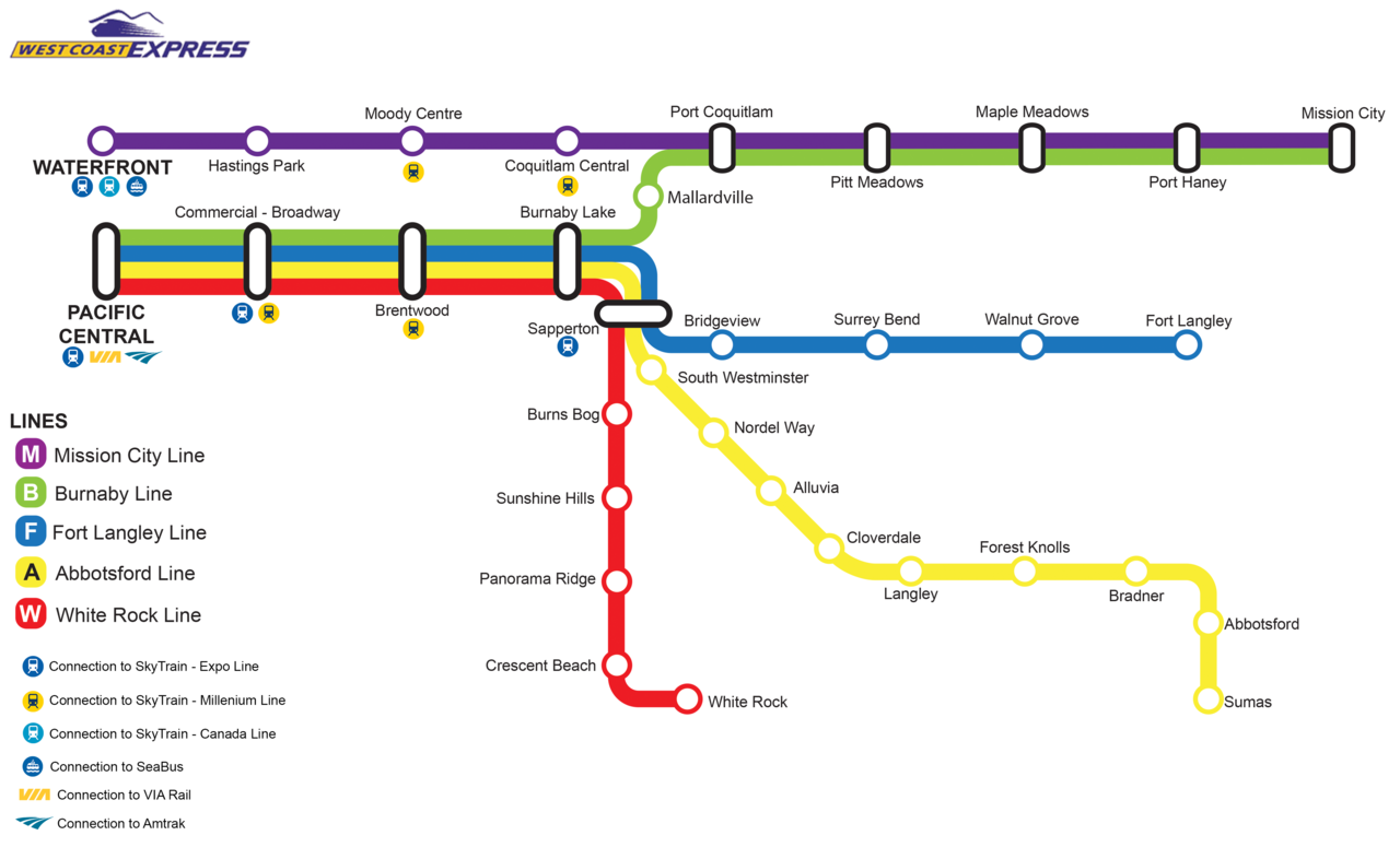

I know this is a bit outside what we usually discuss in this thread but I tried my hand at creating a commuter rail network for Vancouver since it really doesn't have one which is unfortunate for a city of its size.
