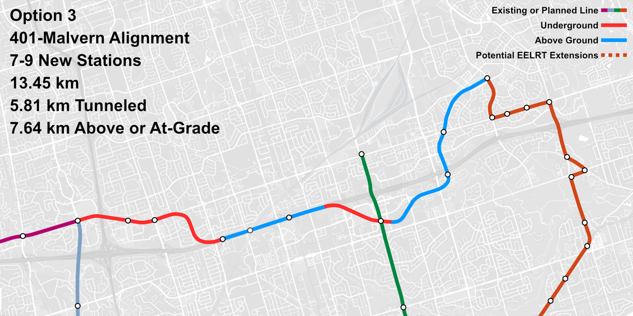

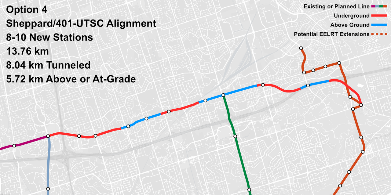

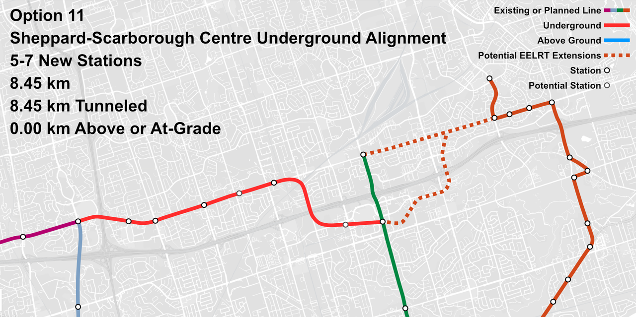

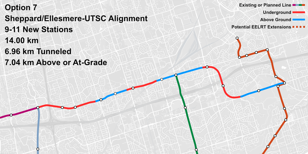

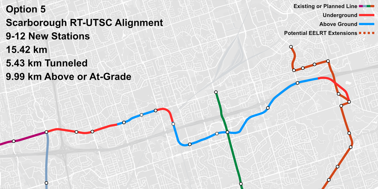

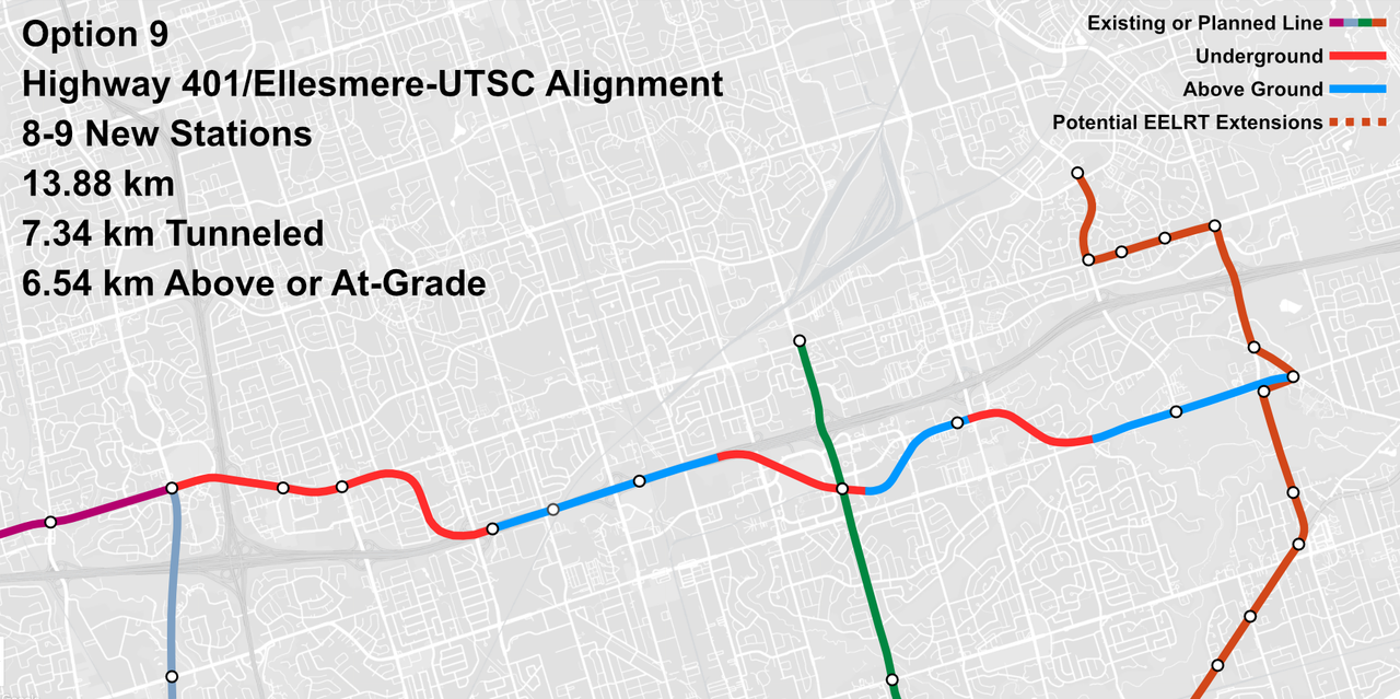

So I went about making my own fantasy Sheppard East alignment, but went a bit overboard, and made 11...
Lemme know which you like best and what you'd change🤔
Also realized stations are only on the legend in the last on oops

Here is my quick analysis of the 11 options:
Option 1: Too many transitions between above-ground and below-ground segments
Option 2: It will be very difficult to transition from below to above at the Stouffville Line as there is the hwy 401 and west highland creek
Option 3: Ok
Option 4: Too many transitions between above-ground and below-ground segments + weird connection with Eglinton East LRT
Option 5: It will be very difficult to transition from below to above at the Stouffville Line as there is the hwy 401 and west highland creek + weird connection with Eglinton East LRT
Option 6: weird connection with Eglinton East LRT
Option 7: Too many transitions between above-ground and below-ground segments + weird connection with Eglinton East LRT
Option 8: It will be very difficult to transition from below to above at the Stouffville Line as there is the hwy 401 and west highland creek + Too many transitions between above-ground and below-ground segments
Option 9: Too many transitions between above-ground and below-ground segments
Option 10: Ok, but probably very expensive
Option 11: Lack of direct connection along Sheppard Ave

In short, 2 or 8 seem like good ones to me. Mind you, I'd stay underground for all of them.

Any issues with transitioning between above and underground too much really only pertain to using bored tunnels. It's perfectly feasible using cut and cover which I think should work in most places here.
The connection to the EELRT is weird for 4-6 mind you, it was really just shown that way to properly illustrate the connection. I made all these and the measurements based on some drawings I did on google earth and there the subway runs parallel to the lrt under military trail.
And yea the Stouffville corridor may be too narrow especially just north of the 401 to accommodate the subway portals and stations and everything that comes with grade changes there
