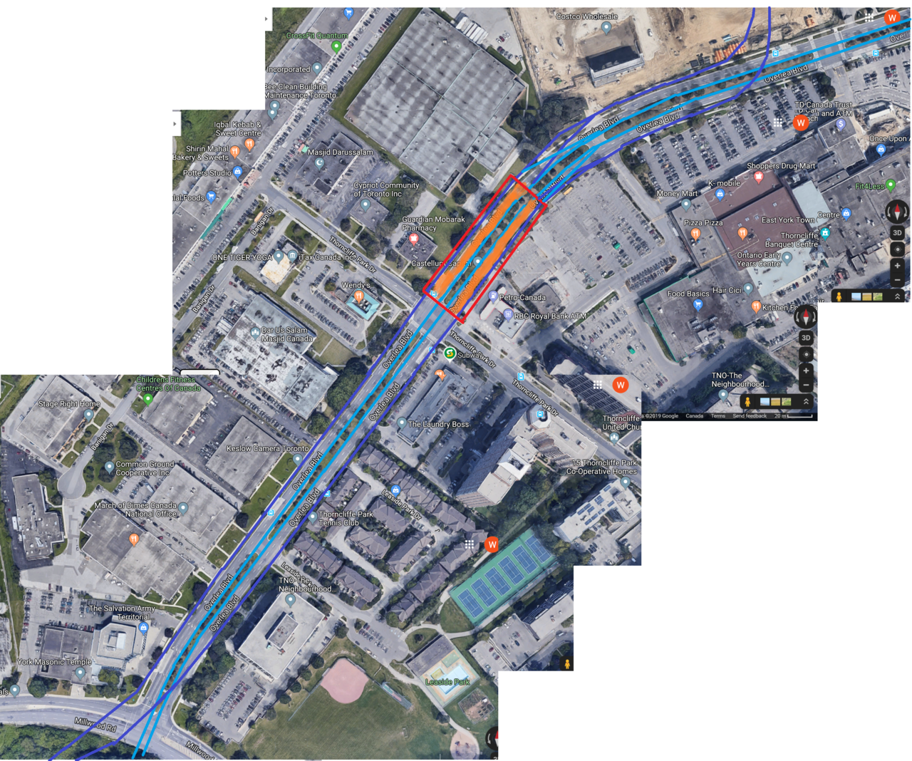

A bit more detail around Throncliffe. The Ontario Line (OL) would have stations at Don Mills/Gateway and Eglinton. The Scarborough Line (SL) would have a station at the East end of the same mall at Gateway/Hydro corridor. Basically, we are pushing a transit line through the neighbourhood, so it becomes much more palatable to the locals if they can actually use it with a stop.
They would of course share the Thorncliffe Station at Overlea and Throncliffe (west branch). As a side benefit - this also provides better access to the planned train yard location.
196674
At Throncliffe Station itself. The two OL tracks would be roughly in the median. The two SL tracks would be roughly above the sidewalks. The Southbound platform would be above the SW (southwest) bound Overlea Blvd lanes. The Northbound platform would be above the NE (northeast) bound Overlea Blvd lanes. There would be a cross-over tracks just NE of Overlea Station, so that in the interim, SL trains could use the OL tracks to head downtown. The full station could be built in phase 1, with the SL tracks SW beyond the Station being built in phase 2.
The Station elevation would be a few metres higher elevation that that of the approaching OL tracks. NE of the Station, the OL tracks would dip a couple of metres, while the NE bound SL tracks would climb to elevate over the OL tracks. Similarly in the SW, the OL tracks would dip a couple of metres, while the NE bound SL tracks would be elevated over the OL tracks.
196676
The locals will not accept two elevated lines along Overlea Blvd.
If locals don't want additional transit, I think it would be easier still just to go straight down Don Mills to the Valley, and then follow the valley. If the locals don't want the $200M station and tracks, I would be just as happy to save it.

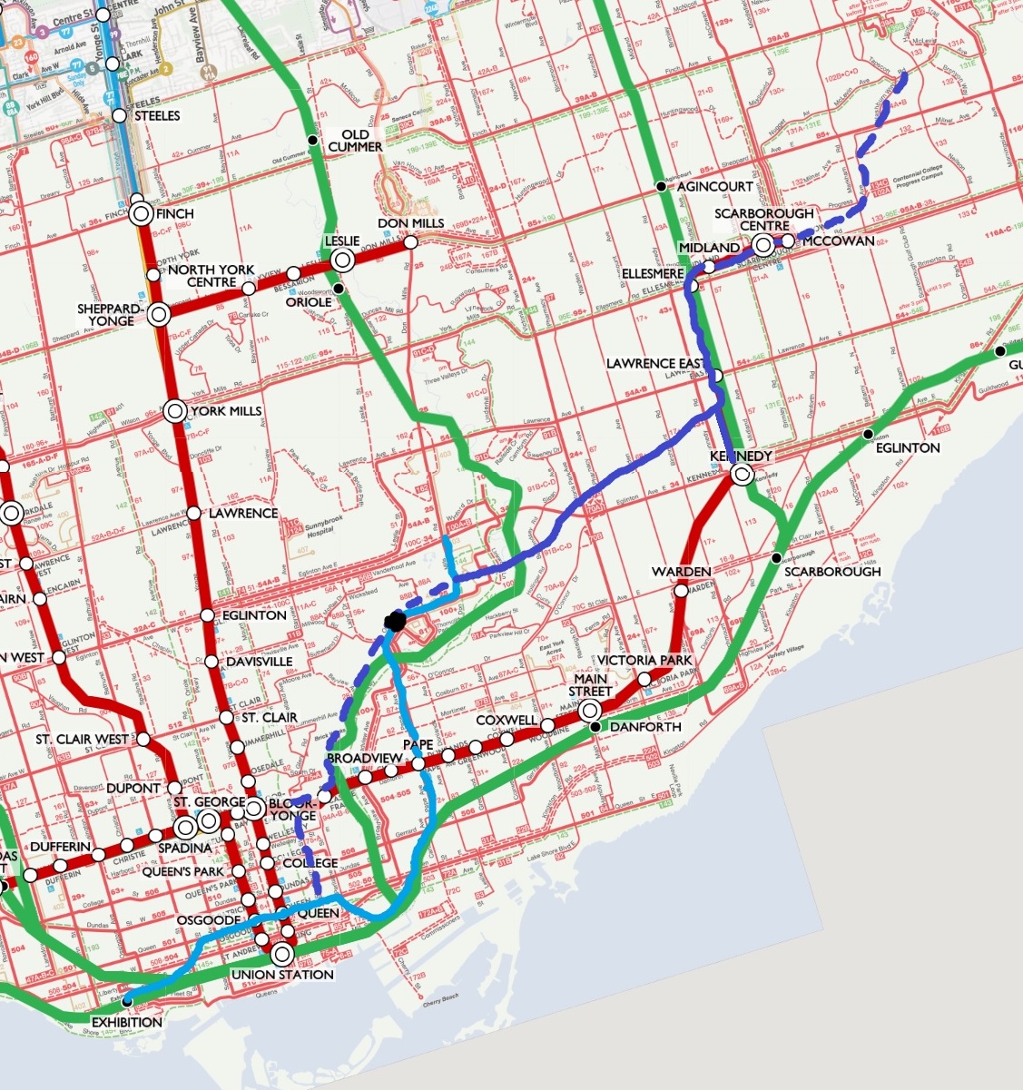

Someone requested this from the Ontario Line post, so this is an update of a map I've posted before. My take on GTHA transit endgame.
197167

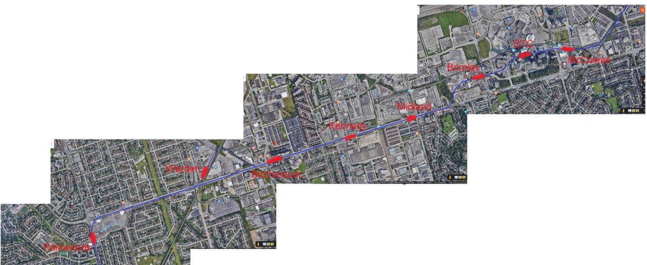

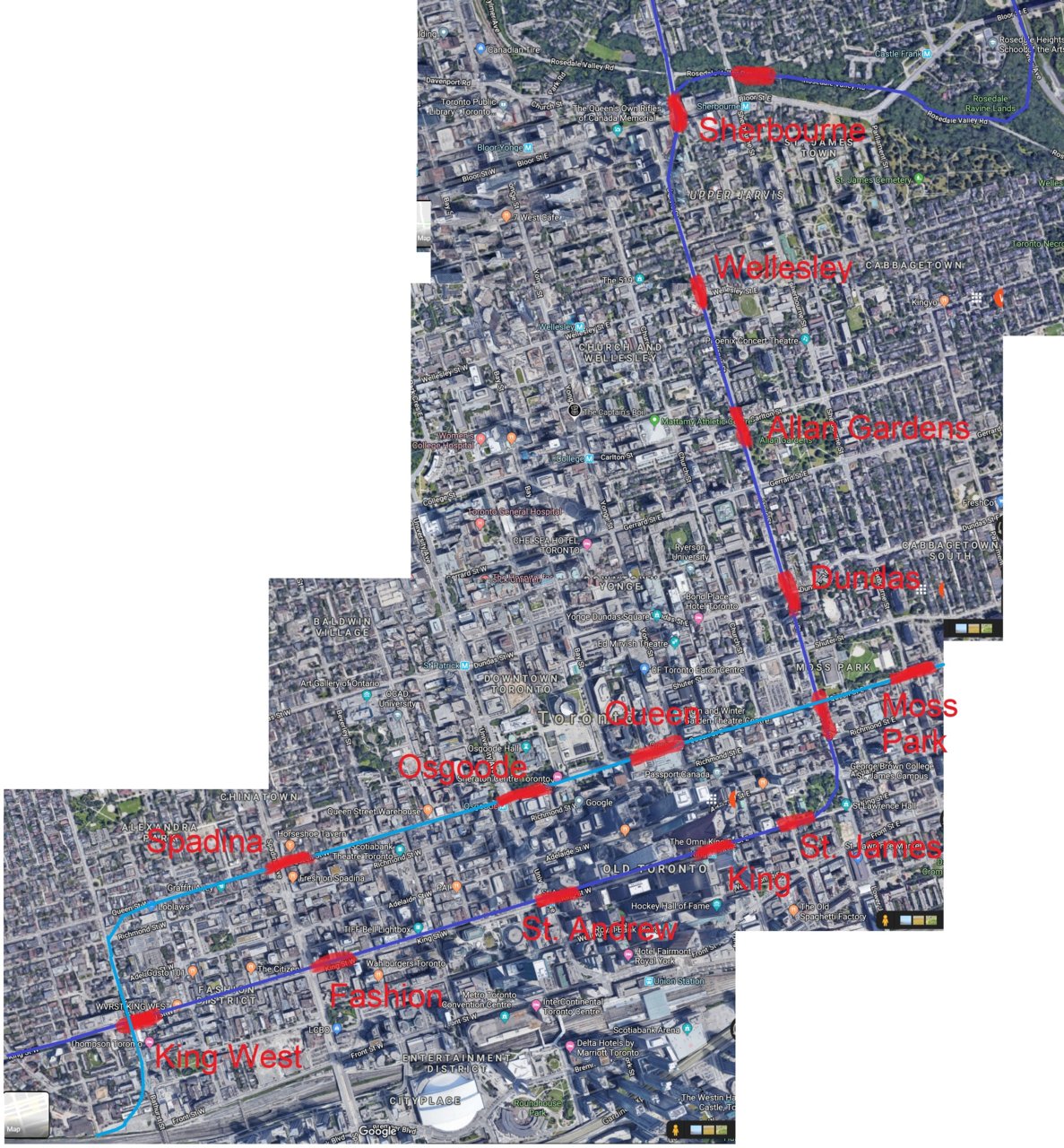

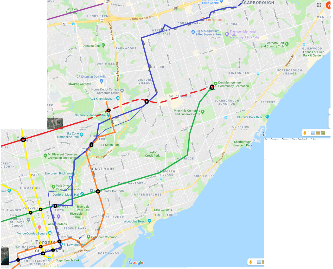

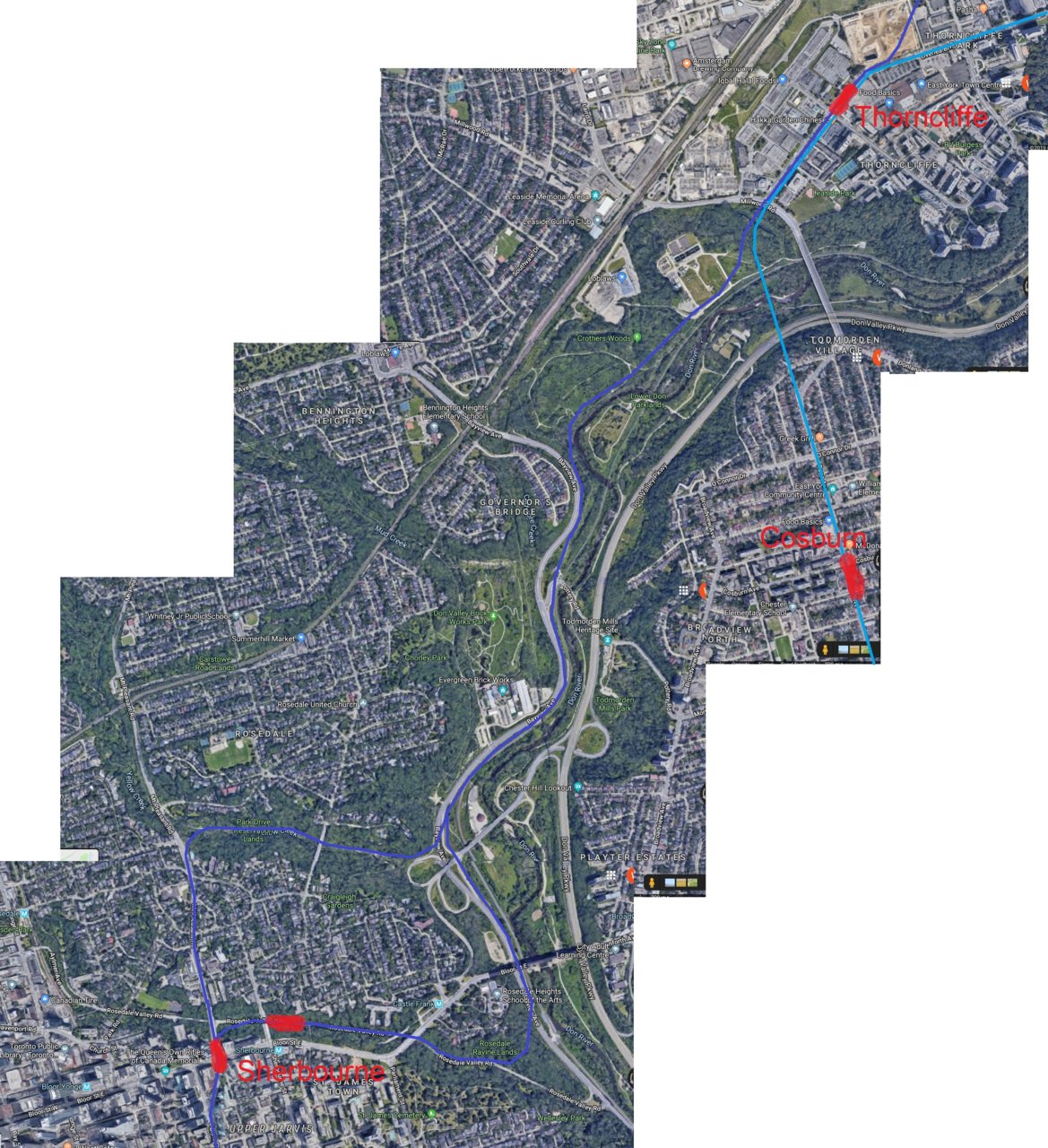

I decided to address 2 issues.
  1. Keep the Markham GO corridor open to GO and RER, and not TTC.
  2. Keep the SRT open during construction of the replacement line.
Here is what I came up with:
  1. Go West along Ellesmere to Vic Park. Due to the CPR Agincourt line, either the Warden Station is omitted (since the line has to climb very high to cross), or the line has to make a detour north to get over the tracks.
  2. Go South on Vic Park to the Gatineau Hydro corridor.
  3. Go West along Gatineau corridor to Thorncliffe. I have two options here, either following the Hydro corridor (it's a bit wider here), or go through the centre of Flemingdon and give them a station there).
  4. Have the aforementioned interline station at Thorncliffe.
  5. Have the future Scarborough Line go down the Don Valley. Again, I thought of two options, either going up Yellow Creek to Mt. Pleasant, or up Rosedale Valley to Mount Pleasant. In hindsight, there is no real advantage to the former.
  6. Down Jarvis to King Street.
This will have an interchange with the Eglinton Line at Bermondsey, the B-D line at Sherbourne, the Ontario Line at Moss Park, the YUS Line at King and St. Andrew, the Ontario Line again at King/Bathurst.

  • Because somebody decided to build ECLRT at-grade through Leslie and DVP.
  • I am trying to show a future transit network. I think we need more capacity going into downtown.
Sorry combine the blue and orange, with high density one line should be good, with transit bring rides the last mile.

The concept is impressive. A few discussion points though:
1) In the south, it might not be necessary to go as far as King. If the goal is to limit the cost of building rapid transit, then Dundas may be a cheaper option for the downtown section of the "Scarborough" line. Dundas is close enough to some of the existing destinations, plus the density is very likely to start spilling north as the space south of Queen gets used up.
2) Hydro might need some push to allow RT in their corridors. Though, the provincial government should be able to legislate that.
3) Keeping the SRT running (while the new line is getting built) might not be an option, because of the SRT's age. To my understanding, SRT is more or less fit to operate till ~ 2026, after that might have to be closed anyway. If so, then it might not be necessary to route the new line in a way that avoids overlaps with the existing SRT route.

I mean, that's what we're all hoping for. Unfortunately the blue line is what's in the works, and we're not sure if it will be high density.
Multiple people seem to be colour blind. :)
(and maybe it's me, because I used different colour schemes on the 2 sets of drawings).
